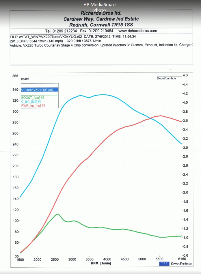

Finally got her on the RR today
I forgot to update here so here is a link to the drive once i fitted the stage 4 bits :D
http://www.vx220.org...4138-oh-my-god/
One thing i did wrong was fit the vxr injectors without greasing the O rings up so a couple were leaking, Richards Bros sorted it and got her on the RR, here are the results.
