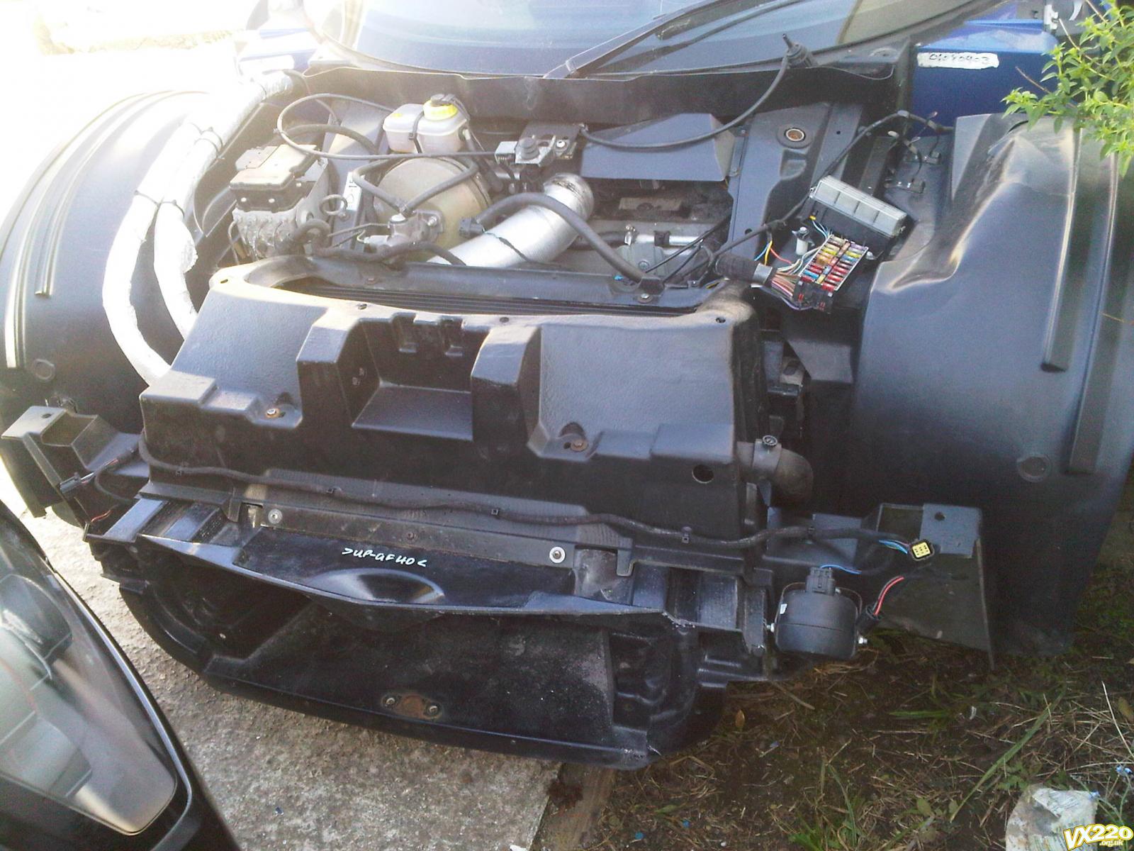

whats the blue hosing from the ally intake going to, under the hot hat?
Thats the recirc dump valve...

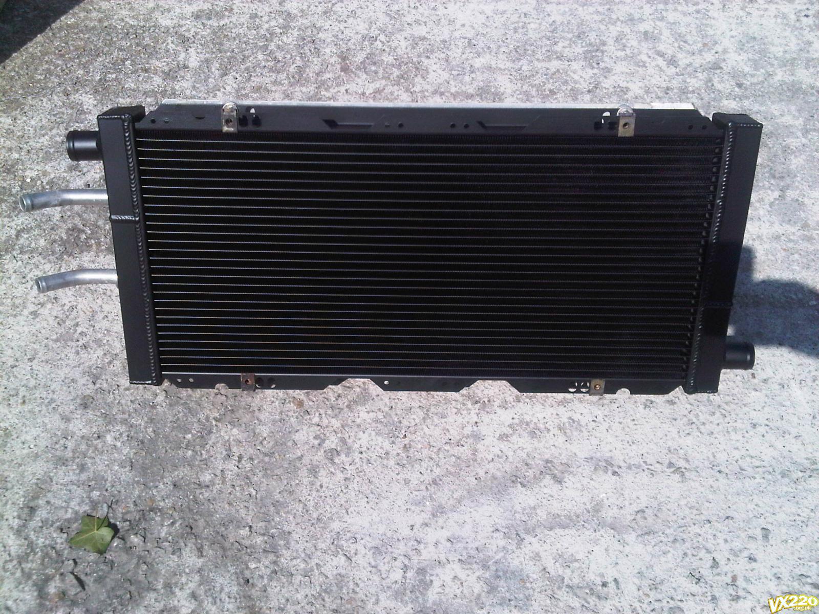

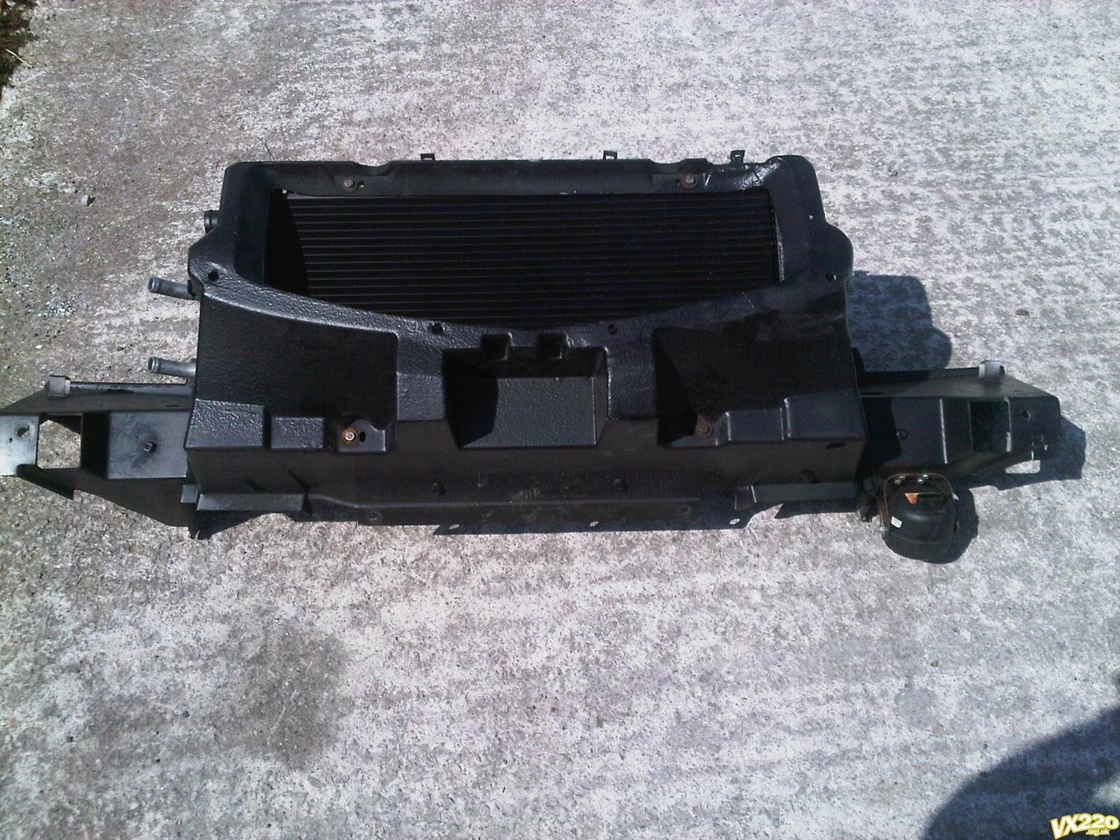

Started today by fitting the Charge cooler element to the new radiator.
I got the radiator surround back yesterday, i managed to get the small damage on the edge of the surround repaired rather than replace it with a copy, much happier with the result, gave it a twist and added some pressure to where the clam will rest just to make sure nothing will give once its on the car.
here is the surround and radiators firmly back on the car where they were ment to go.
I bagged up all the nuts and bolts in seperate labled sealey bags once i started stripping the car, So glad i did that, all the nuts, bolts, washers and spacers have gone back where they were ment to go, couple left over had me looking everywhere then i realised i havent got the towing eye on yet

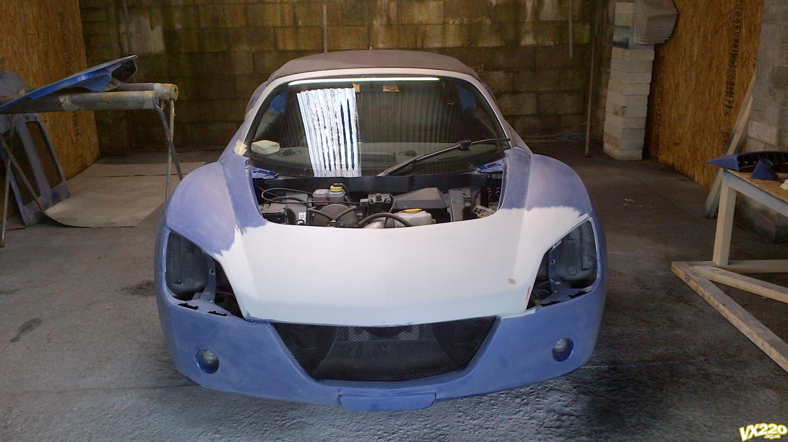

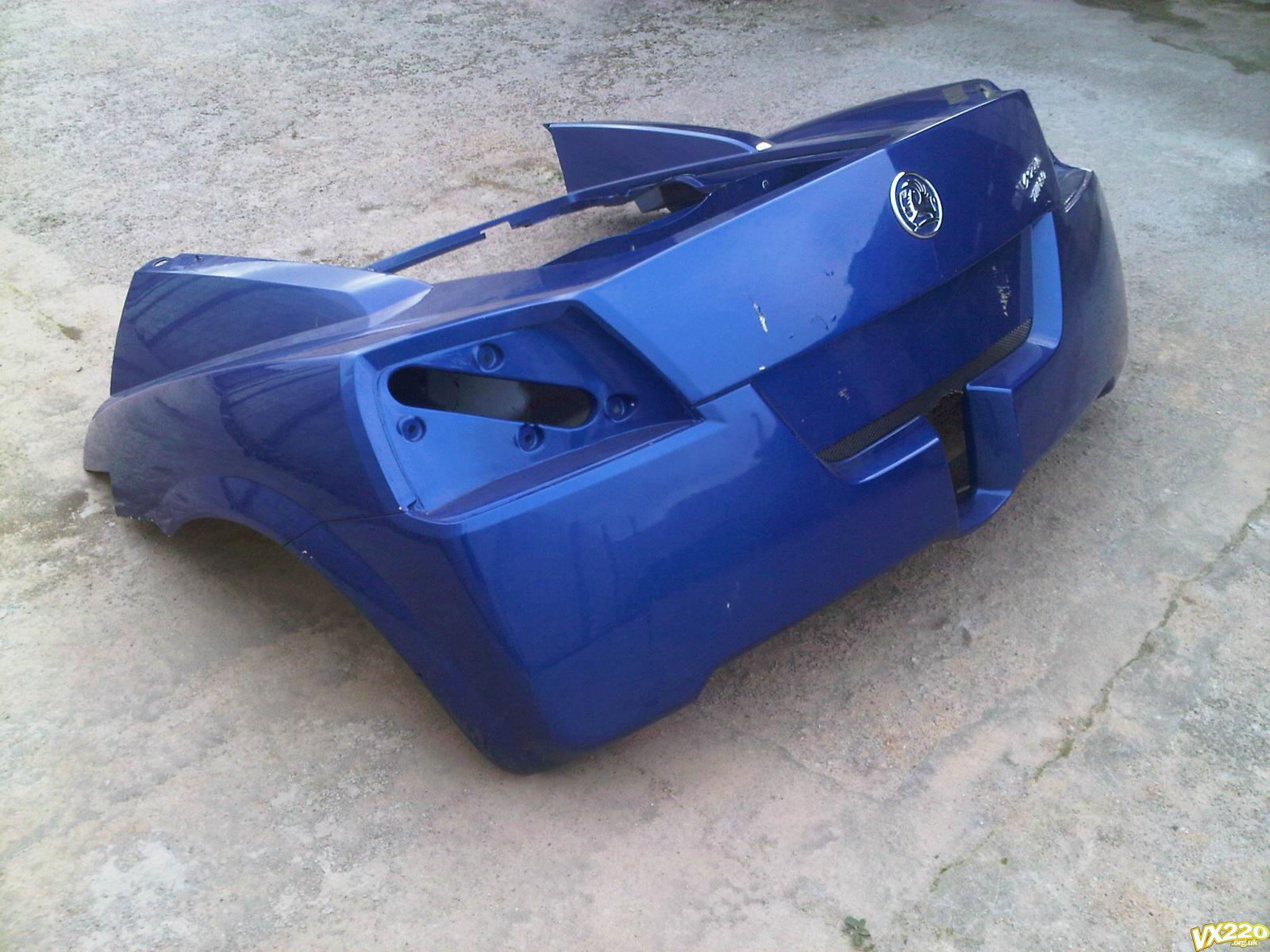

Hopefully i will get my front clam back on Wednesday, i managed to get a nice genuine blue rear clam with very minor damage to the rear face and a bit of bubbling on the lid area but seeing as its all getting painted anyway
For the rest of this week i will be getting the paint shop ready, my girlfriends brother works for Nationwide (insurance body repair company) and is looking for somewhere to take on some work away from work. After my dads retirement from selling coal i have been left with 1.2 acres of industrial land with a bagging shed about 10x16meters to play with, Perfect and i think i have a new best friend

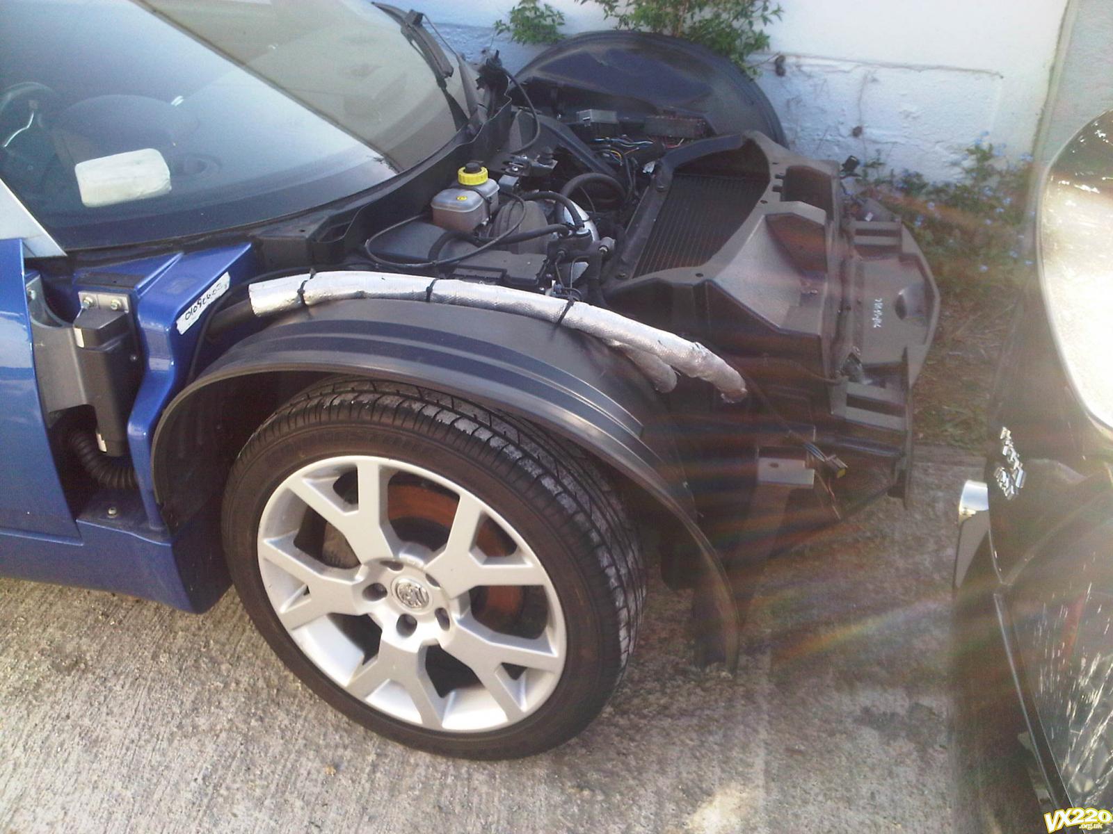

Just buy a few metres of edge beading from cbsonline on similar. That's all that Vauxhall do as it's just sold by the metre but probably at a huge markup.The trim on the edge of the wheel arch butts up against the clam. Any idea of the part number?

Yeah that's the bit behind the headlamp, I would like to put it on if I can get one.
I thought I needed them, couldn't get hold of any last year, and came to the conclusion that they really serve no purpose, as there is nothing to protect the lights from - wheel arch liner does that.
More importantly, don't forget to fit some black foam draught excluder around the edge of all of your lights front and back so they don't rub away at the paint on your clam. This is listed in the parts manual, but easily available from an online supplier - infact I may have enough left if you need it

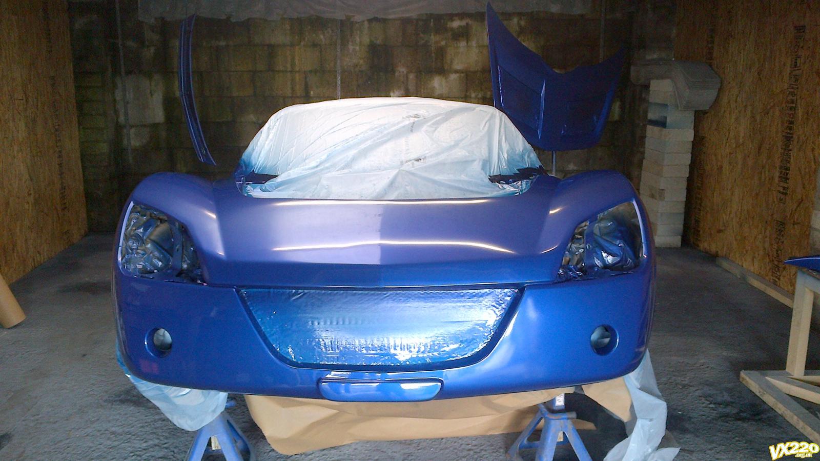

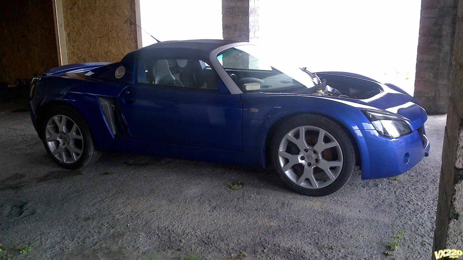

here are a few pics of the progress, just need to refit the bonnett, boot, mirrors and side pods then start getting ready for MOT.
bought some edge trim for the front clam, nice tight fit now, i can see a small gap on my black vxt where it is meant to go so i will fit on her after this ones MOT'd.
got a new stainless tow mount to fit too, perhaps should of done that before we put the clam on
still need to address the front wheel problem but hopefully the upgraded hub bolts will fix that.
if all goes well i will bring her back home next weekend after a days flat n polishing saturday, looking forward to the drive home

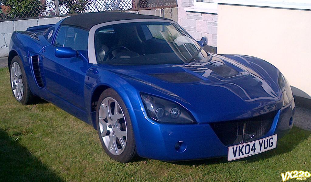

Posted 03 July 2011 - 06:32 PM
felt good driving home.
im a black car man but im warming to the blue now its home.
