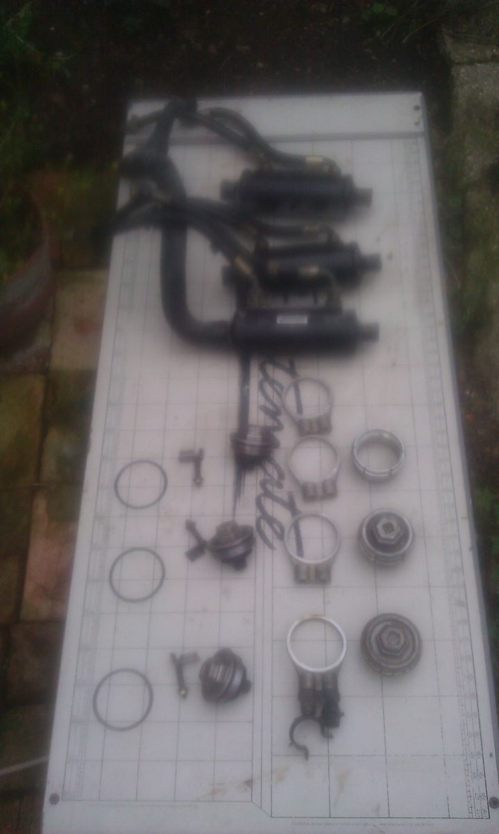

I have 4 complete sets for sale
PM me
these are dismantled into individual parts
A few oil filter parts for sale
