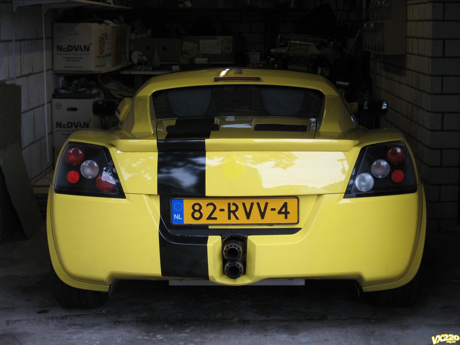

This 2004 LSJ engine is already living some years in my garage. Initially I wanted to swap earlier, but then at that time the 2.2 SC conversions were improving a lot with the new ecu remaps and the standard compression giving around 250HP. So I robbed the necessary SC parts of this LSJ to convert my 2.2, got all the necessary parts and with a base map from Courtenay my Speedster did 249.3HP on the rollers. Final mapping is a bit troublesome from here (as said, I live in the Netherlands), but as my AFR was spot on till the rev limit, my Speester lives happily with this base map.
In the meantime I helped with a few other SC conversions here in NL and the lack of proper SC tuning was always nagging me a bit. In the Us the tuners there seem to get serious power out of the LSJ engines, so the plan came to build up my LSJ engine and use this with the original US ecu in combination with HP-Tuners. (HP-Tuners is a mapping tool that allows you to (almost fully) remap the LSJ ecu.) The LSJ ecu only works on the 2.0l engine (or it's cousin the Saab B207) because of the necessary 60-2 crank trigger wheel. (Our 2.2's have a 7-1 trigger with wasted spark ingition.)
The engine I had. SC bits were easily gathered and HP-tuners sourced. Got a suitable LSJ ecu and engine harness from the US and after some research of wiring diagrams I modded the egine harness to suit a VX/Speedster.
I was a bit troubled to do this swap in my perfect running, low mileage Speedster, so when I then got a cheap import VX offered with a knackered 150K engine, the deal was quickly made.

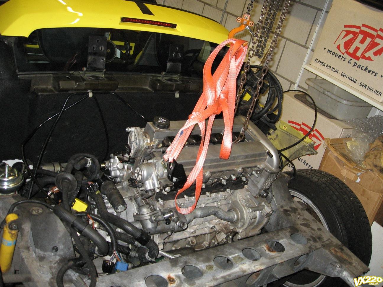

Rolling into my garage:
And start to disassemble:
Lots of rusty bolts later; result :

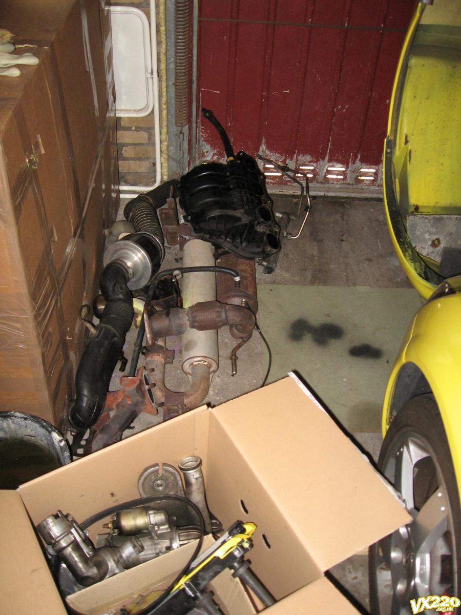

The old stuff has to move out:
Old knackered engine, but still good for some necessary parts. Needed the thermostat housing and the oil cooler hose connection for my LSJ block:

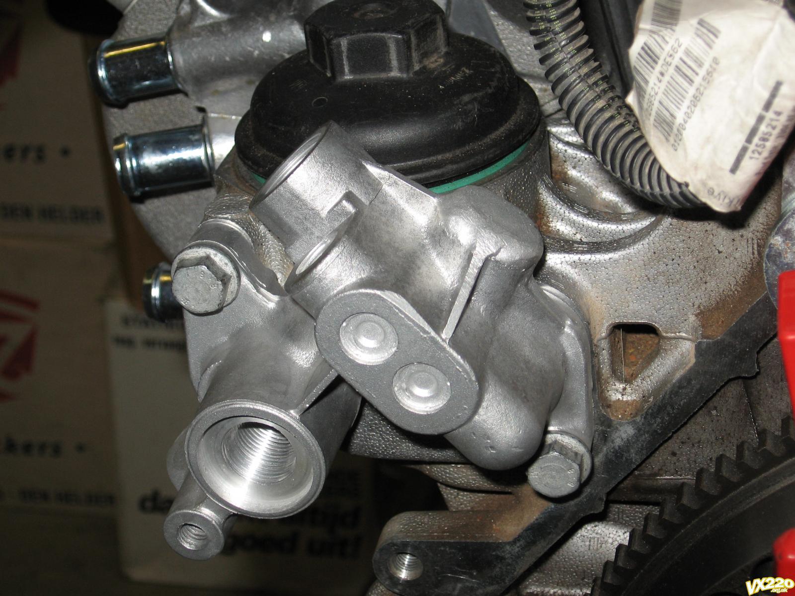

It's not exactly the same as the Z22SE circuit. I modded the LSJ adapterplate and it now uses only the cooler return through that. The oil cooler feed is coming directly from the block's oil gally, like the Z22SE has. I kept the LSJ/Saab's thermostat in the adapterplate, only with a restrictor so it only partially bypasses the cooler when cold:
Need to examine the Z22SE's oil layout further, but this now works pretty similar as the LSJ/Saab cooler.

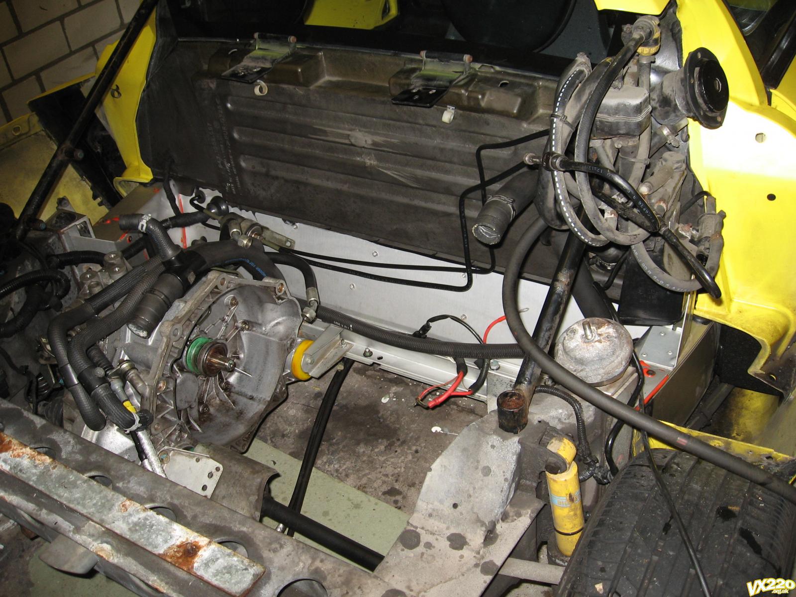

Next job was the clutch release bearing. The old one was doing it's job, but after hearing all the stories of leaking bearings, better install a new one now:

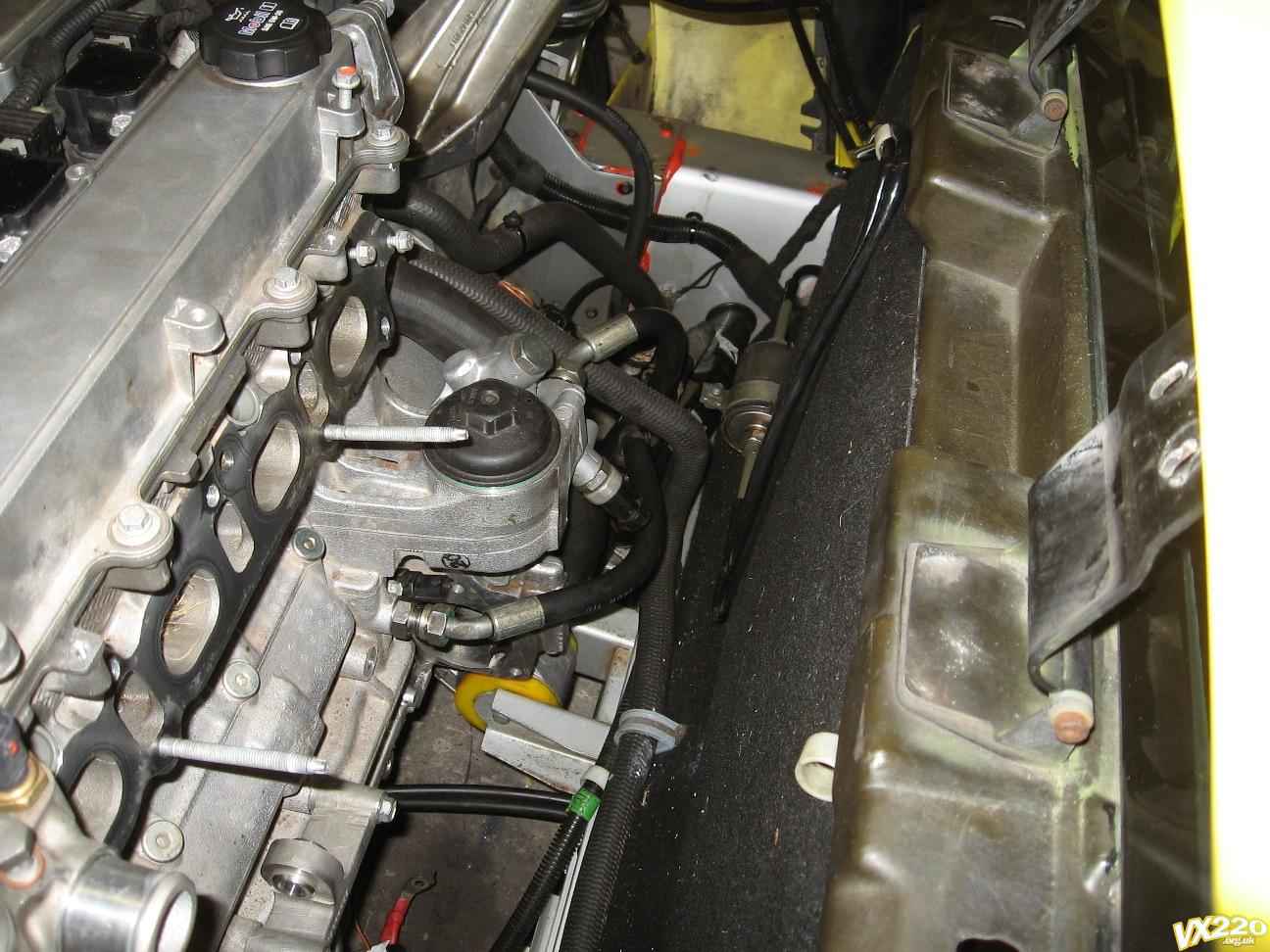

The oil cooler feed; standard Z22SE hose connection from the block's oil gally with the normal LSJ/Saab oil filter cap:
And the other side with the modded LSJ/Saab oil cooler adapterplate. That water hose need some final tweaking to prevent rubbing with the oil hose connection, but overall I'm pretty pleased with how the standard oil hoses fit:
