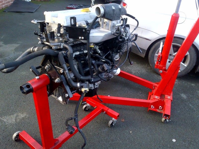

The engine has been stripped down ready for today by my dad over friday and saturday and now sunday was the day it all went back together and i have took a few picture of everything going back together so we have gone from a bare block today back up to a long block minus cams as i still need to purchase these.
only thing now holding me back from putting it in the car is for the inlet manifold and to buy the cams to get the engine ready to go back in still alot needed for the car but aslong as its got the engine back in it can go away for its jollys to nortech to get its make over.
so heres some pics for you guys:

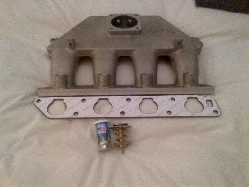

new parts arrived - EDS Inlet Manifold, Thermal Inlet Gasket, Dimplex Magnetic Sump Plug and Cool Running Thermostat
#72 Nev
Posted 30 October 2011 - 10:40 PM
Thats quite good that EDS send a phenoflectic (or whatever its called) gasket with the manifold. Shows a decent attempt to help VX owners fix a mild problem.

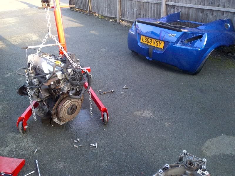

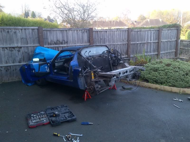

Posted 06 November 2011 - 06:44 PM
got a little more progress me and me dad set about getting the rear clam off and engine ready to take out today. So engine is fully built up now just needs a few little bits swapping over and now the rear clam is off and the engine is ready to come out just got to undo the mounts next weekend and then the swap can begin also going to buy the chargecooler kit this week so while the rear clam is off i can get that fitted also. and thats about all for the time being.

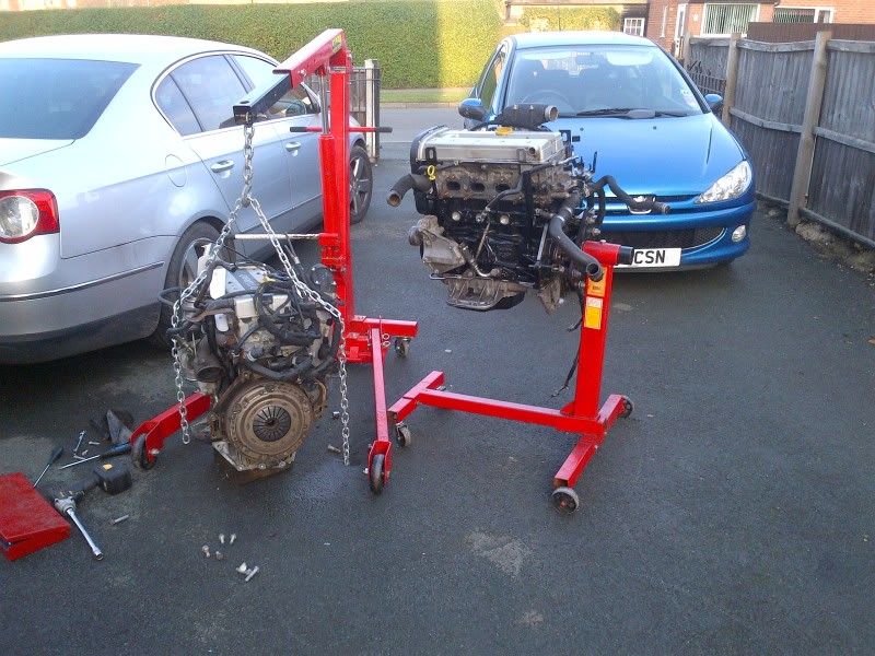

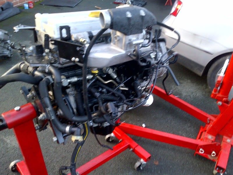

abit of progress again this weekend. got the LET out the vx220 and have no changed gearbox over. and bolted it back in but the engine mounts have broke as they do on all vx220 so is jsut resting there at the moment but have ordered new ones. but the new engine is in so im a happy bunny :D
