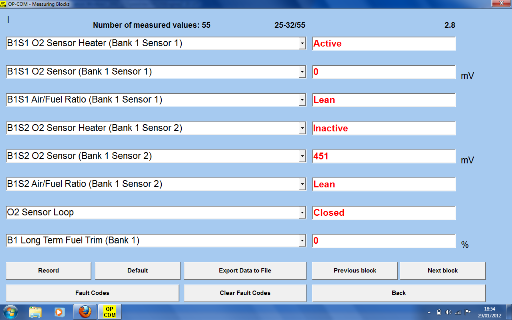

:glare: Something is fishy then with Joe's readout... Sure about the #1 and #2? Knew the Z20LET also had a square blue/black connector (right?) for the 2nd O2, but maybe the male/female part were switched? That's at least how it was done on my original LSJ loom to avoid connection errors... Joe has a mission this weekend. :ninja: Edit; Not sure what they all modified and tricked on the Z20LET loom, but maybe they used some resistors in the post cat sensor wiring and therefore his O2 #2 now shows up as 451mv. And his O2 #1 doesn't show up because it's broken or has a wiring glitch somewhere, causing his fuelling issue... Vocky?
Edited by Exmantaa, 26 January 2012 - 02:42 PM.
#88 vocky
Posted 26 January 2012 - 03:04 PM
Joe's loom has only one lambda plug, I removed the post cat sensor wiring because courtenay were going to switch that off in the map. I would also guess the 451mv is a generated stable signal rather than the lambda sensor reading, it doesn't move even 1mv when the engine is rev'd Plus the ecu and afr were fine until Joe was half way to cms, something failed during the journey, so the lambda sensor is worth replacing first

Techieboy Imnotworthy was kind enough to nip over and reset my abs and airbag light one thing we noticed was that my second o2 sensor was not working but showing 451mv same as Joe's so it's stable signal thats all.

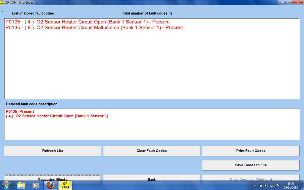

OP COM is pretty cool! right, i have changed the lambda sensor and still had lowish afr 11ish have changed the AMM and now i have 13.7 afr but not the 14.7 aff i had before on idle... strange! what you lot think? :poke:
#98 The Batman
Posted 29 January 2012 - 06:57 PM
#99 The Batman
Posted 29 January 2012 - 07:02 PM
my amm is definately fooked!
