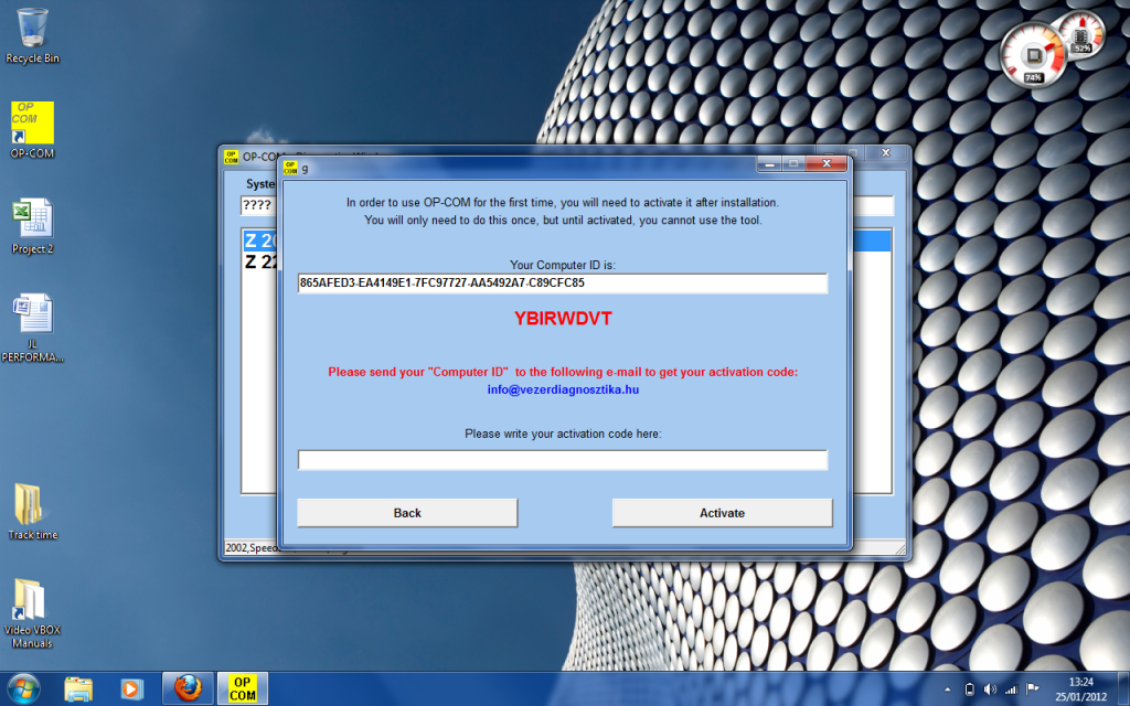

asking for an activation code :blink:

hmmmmm, don't remember it ever asking me for one....
#66 techieboy
Posted 25 January 2012 - 01:25 PM
There's a file called OP-Com Activation.pdf in the zip file that you downloaded that talks you through getting past that. thumbsup Still don't remember doing that though.

#68 techieboy
Posted 25 January 2012 - 01:30 PM
See attached
