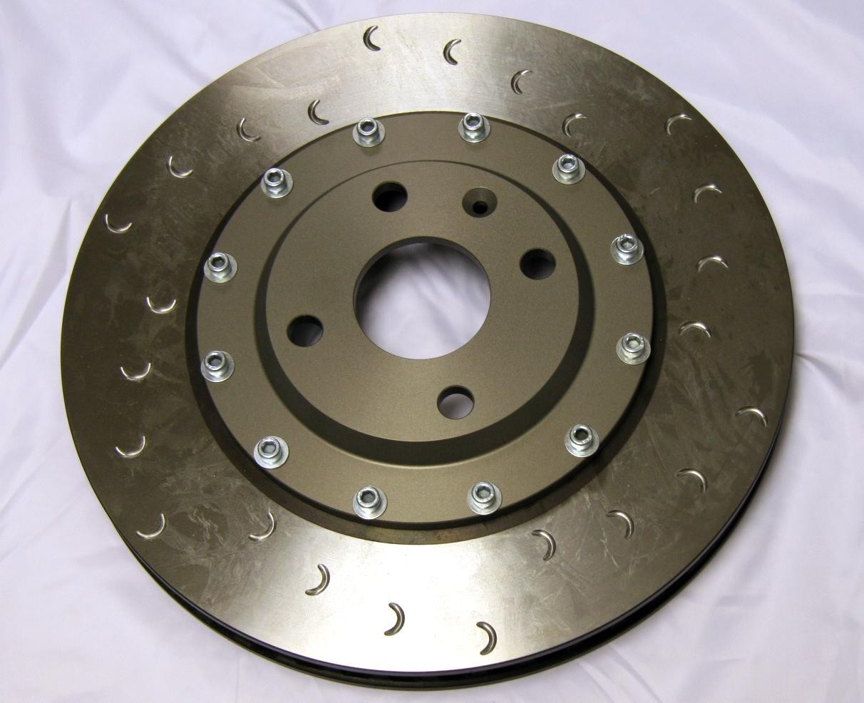

#2 Upgrade disks with bells, keep standard calipers and standard size discs (288mm), use one of the pads from #1. Bells avoid heat transfer from discs to hub and therefore heat up and cool much faster.
- Elise parts do a reasonably priced set (Full set £600, replacement disks £400)
http://www.eliseparts.com/products/show/21/1/aluminium-belled-discs/
- There seems to be a number of 295mm options, which must include spacers for front calipers. Costs are prohibitive

#4 Upgrade the front calipers in #3 including bells
Seems to be a few options for the bells:
-AP do their own
-Nitron, Seriously lotus do some
http://www.seriouslylotus.com/index.php/braking/brake-discs/alcon-308mm-disc-with-nitron-fixed-bells.html

Good point, i'd forgotten about that. thumbsup though my feeling is that the bells would help a lot more.
