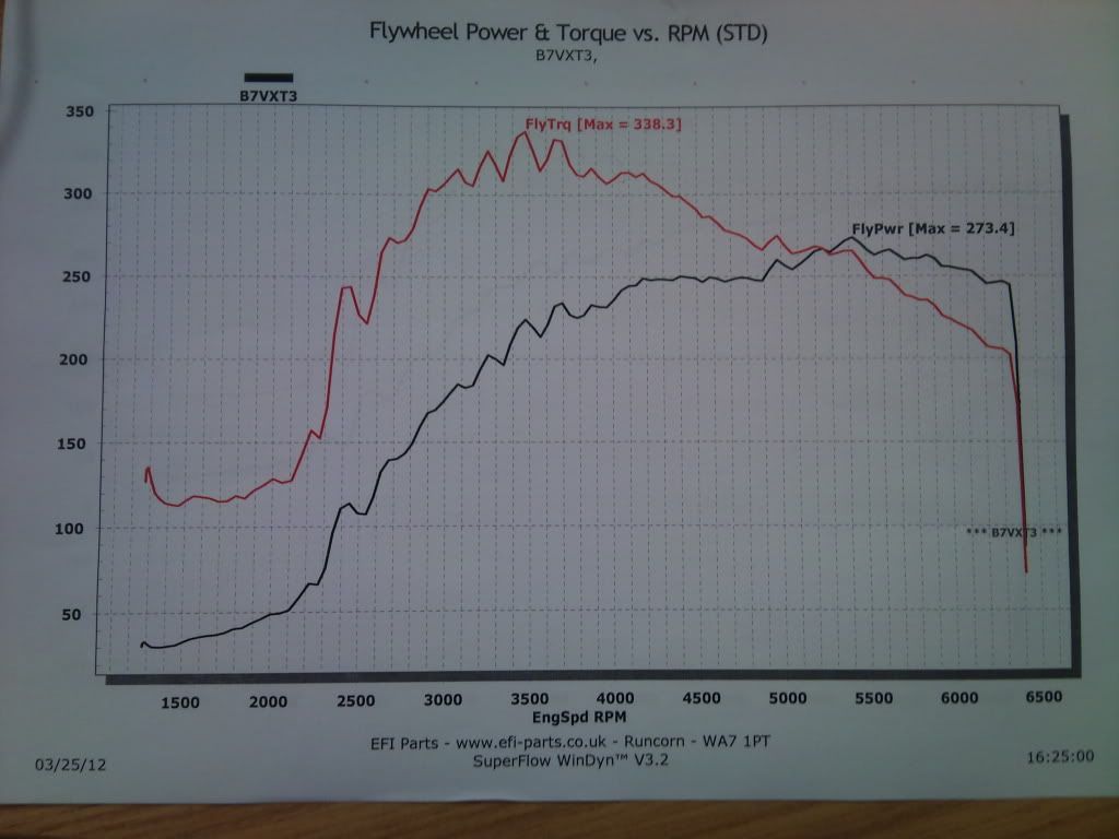

Ok well its been in the making for some time but managed to get the final spec fitted and tested to a VXT CS stage 4 car of following spec
Completly stock LET engine other than VXR turbo, VXR injectors and uprated plugs. Comp spec clutch and full miltek 2.5" exhaust
Tom had traveled down from Aberdeen to meet up at the RR in Runcorn where we did 3 runs prior to any changes, the main reason for producing this kit was to reduce the compressor surge, turbo stalling, wastegate chatter or whatever you like to call it :D
Made 273.4bhp and 338.3 ft/lbs torque

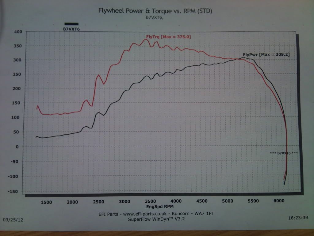

After fitting the kit we did another 4 runs to check everything was ok and see if it would make anymore power (the kit was built to address the chatter problems and the following was the output
Made 309bhp and 375 ft/lb of torque
A MASSIVE 35.8bhp & 36.7 ft/lb torque 3 of the 4 runs within a few bhp 4th run the header tank had a small crack which got worse :S very lucky to have a alloy one in the car so day saved late on a sunday with nowhere open and hrs from home
It is worth noting there is no smoothing done to the graphs which most RR do, could have done this but seemed no point tbh. Fueling was a bit to rich on the CS map in pre kit runs but spot on with the kit fitted and still a nice saftey area top end. Sure Tom will update at some point but initial feedback was that it had solved 90% of the chatter issues he was previously experiancing which was the goal

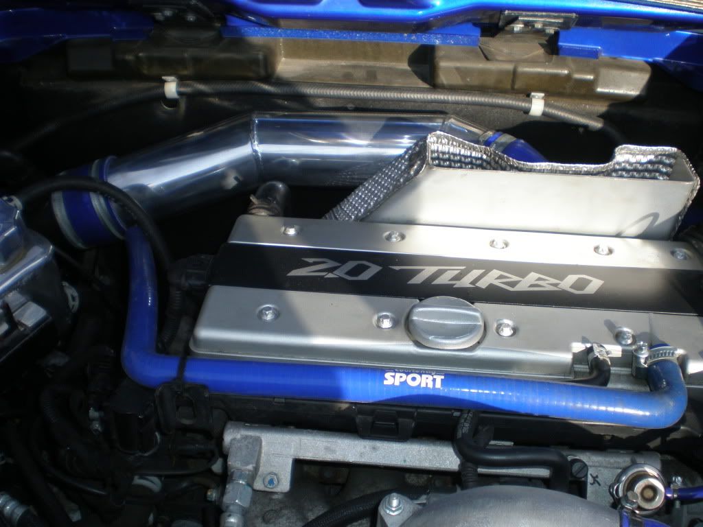

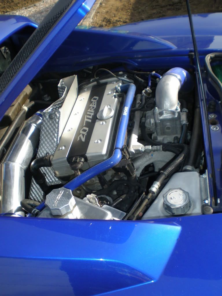

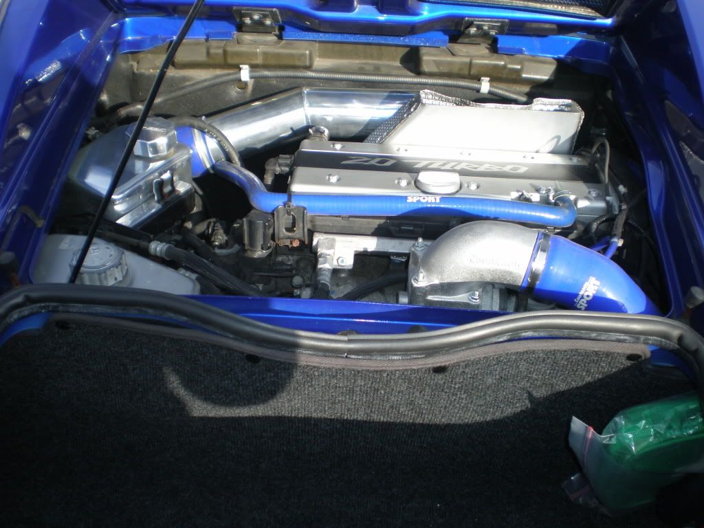

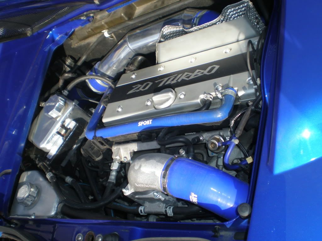

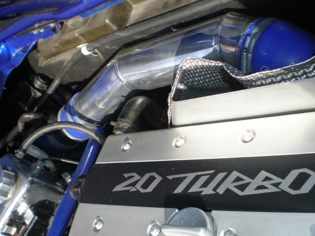

Ok Tom has kindly sent some pictures over - the catch tank for the crankcase breather been worked on this week to complete
    Bing (1)
