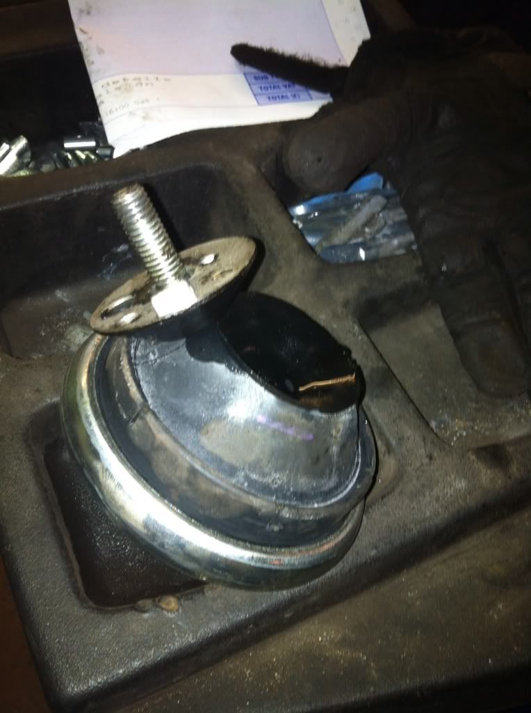

Ok iv just changed the gearbox engine mount on vx tubby but have come to a problem, the old mount was a big heavy mount but the one from auto vaux was smaller and lighter, carried on fitting it finished the job took it 200yds and BANG!!! Grrrr coffee noise, took it apart and has split the mount clean in half. im pretty sure its not the mount failing as it is half an inch smaller then the one i took out?? and the engine when not supported does not sit on mount?? Has anyone come across this problem.?

u get a front and back engine mount then the left and right side damping mounts. Upload some photos of the old new

Sounds like the wrong mount fitted - picture for us will clear it up sir ;) DG

http://i1172.photobu...z1/56e1410f.jpg

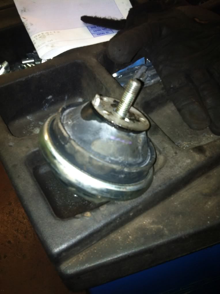

http://i1172.photobu...z1/72ad6fc0.jpg
Broken

Sounds strange - those are 100% the correct top mounts for both turbo and n/a What is the current setup with the bottom 2 gearbox mounts? Maybe they need slacking off to let the engine sit flat on the top mounts and then tighten back up? DG

Ok i didnt realise the cntre mounts were adjustable, it does seem as though the engine is sat hghi compared to my own tubby?

Autovaux have been very good over this immediate replacement sent out and also they assured me this has never happened with one of there mounts.. again im sure its not a failing mount it has split due to engine not sitting on mount.

Looks like we'll be adjusting engine position then before tearing another mount in half!!! LOL

The front and rear mounts aren't adjustable. Not sure the nearside mount supports the engine in any meaningful way anyway. There's no need to support the engine when changing the nearside, so that says it not bearing any real weight (and is probably why it moves around so much and breaks in the first place).
