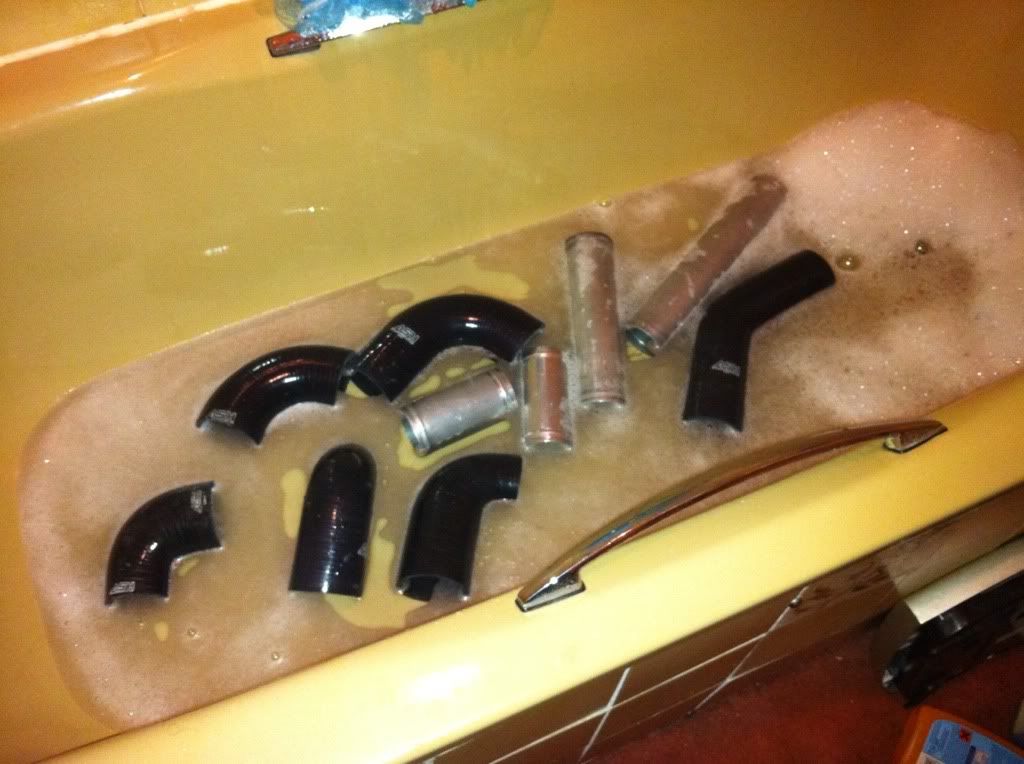

swaged the cooler pipes
then washed them in the bath hehe

bath time!

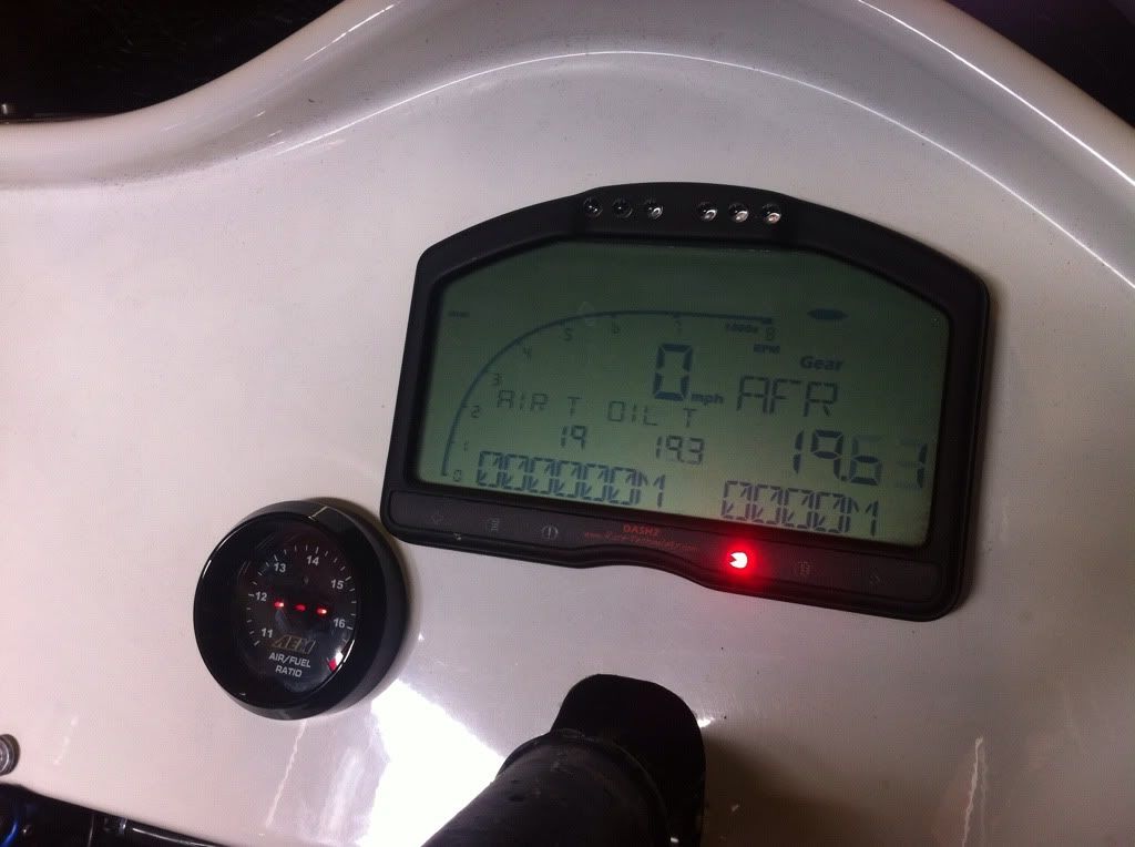

dash displays setup, it also does gear, revs speed, shift lights, and warnings high and low for everything great bit of kits and i interface it with the omex to pull most of the reading with no additional sensors!
wideband fitted also dispays in dash to can log min and max

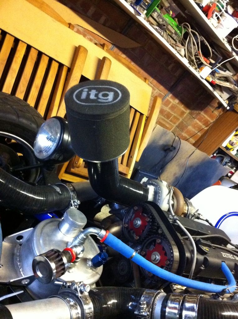

air filter 4x4 style

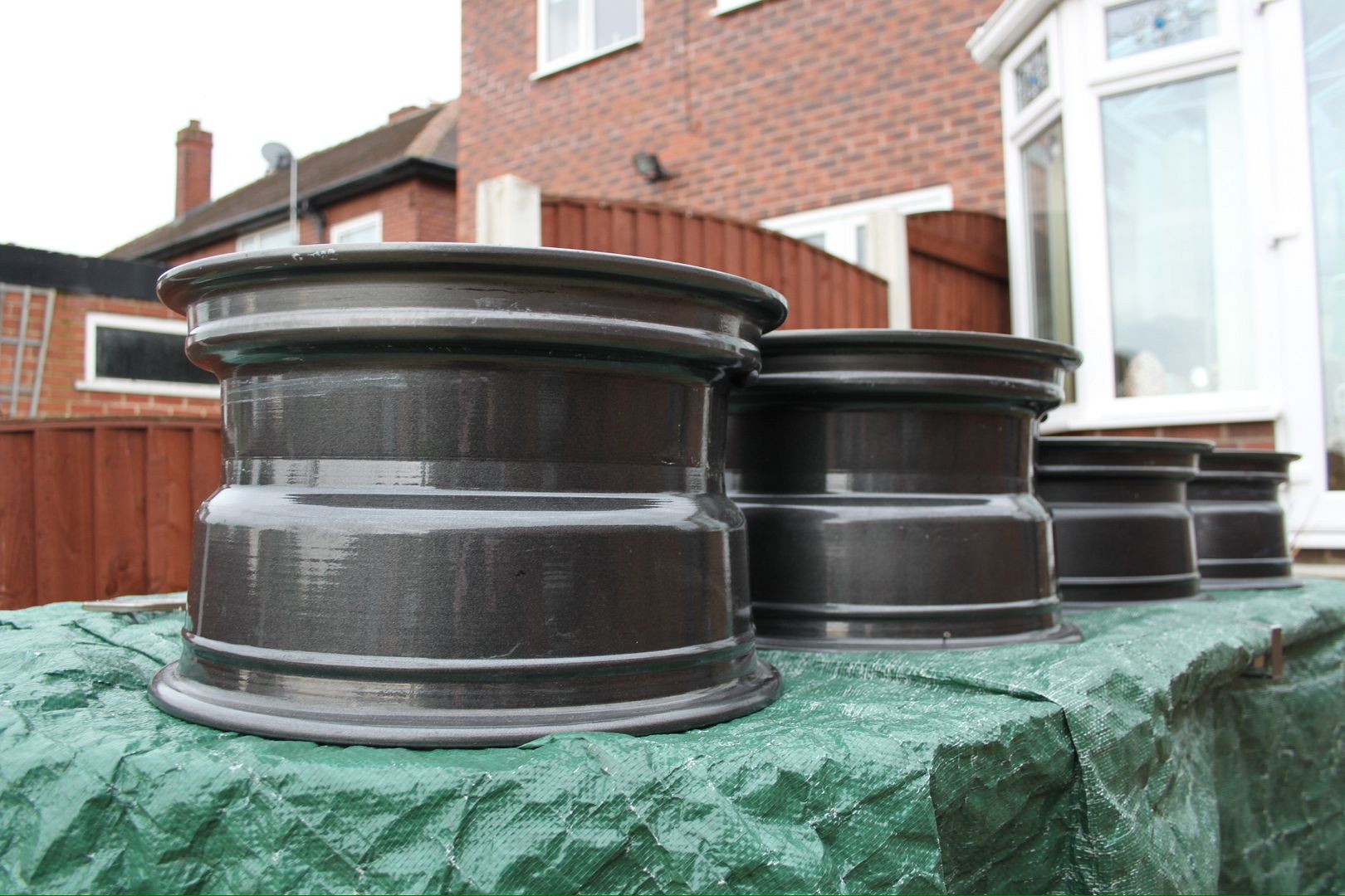

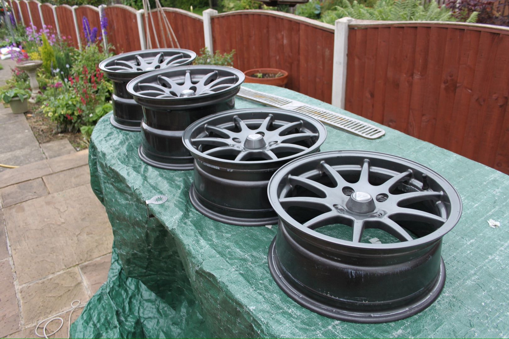

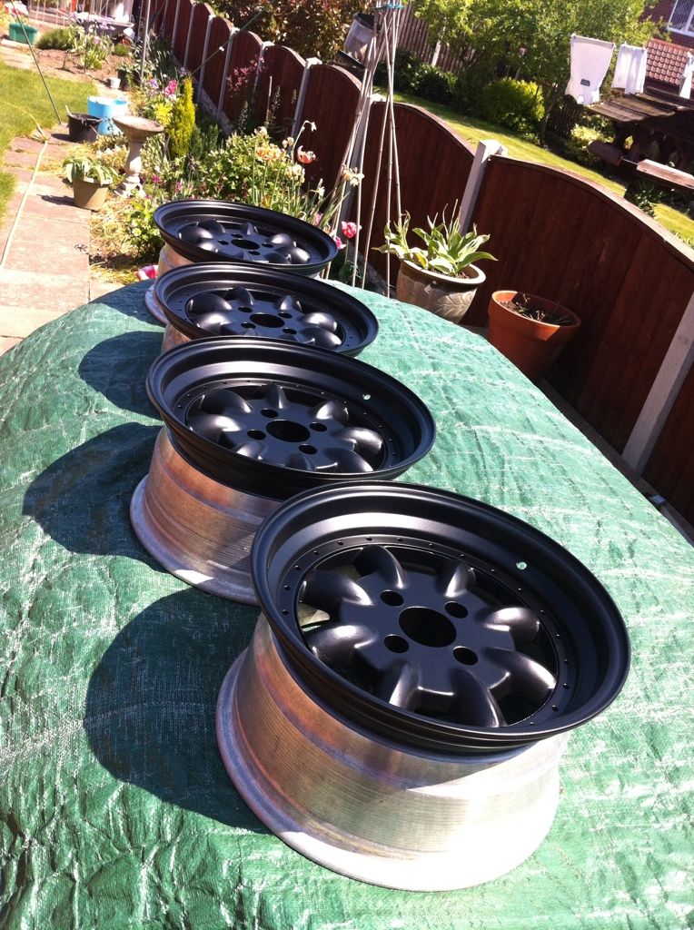

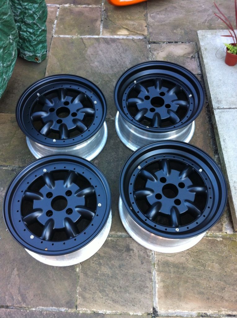

got wheels refurbed and wider at the rear now the 7x15 up front 8x15 at the rear
i like wheels, then purcahsed a set of caterham csr wheels
massive

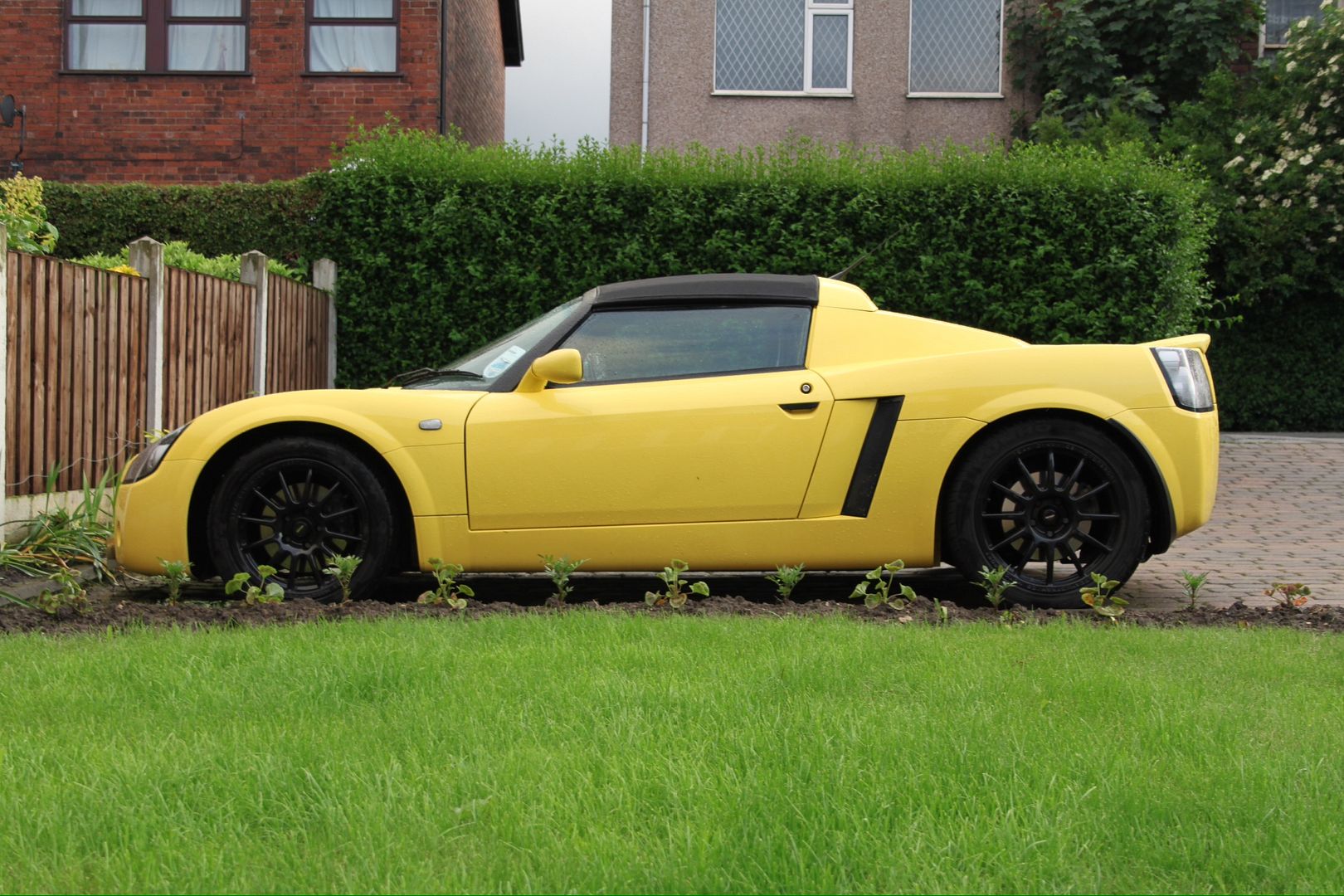

then i got sidetracked any purchased a vx!
