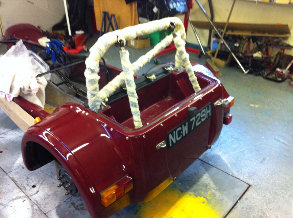

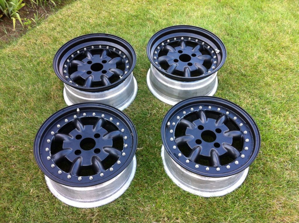

bodywork take 2, the new stuff!!!!
takes ages marking cutting testing etc....
getting there though!
another set of wheels
13" this time less weight

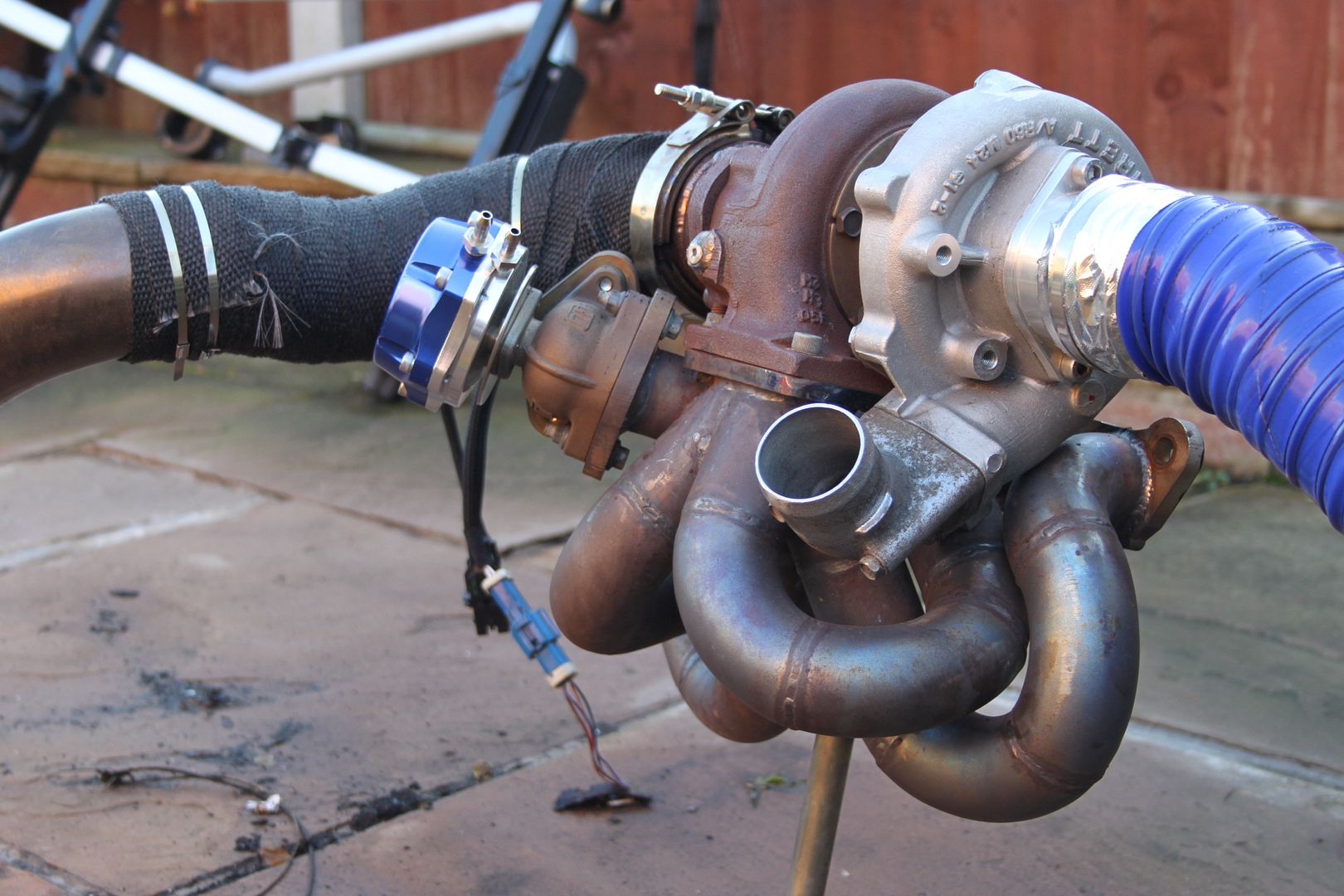

washed
had to cutout bonnet top for turbo
smaller front tyres, running 185 up front 205 at the rear
set of carbon front archs fitted
boost solenoid

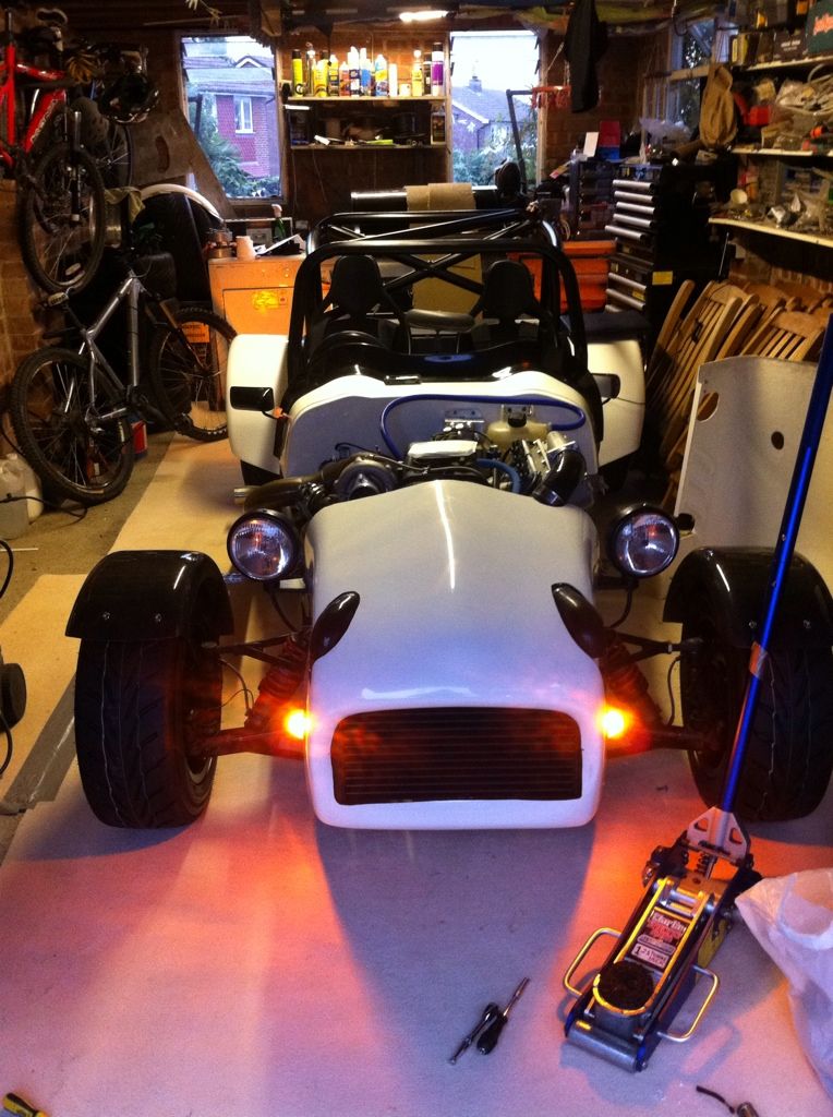

#85 Thealastair34
Thealastair34
  • 988 posts
  • Location:Wakefield

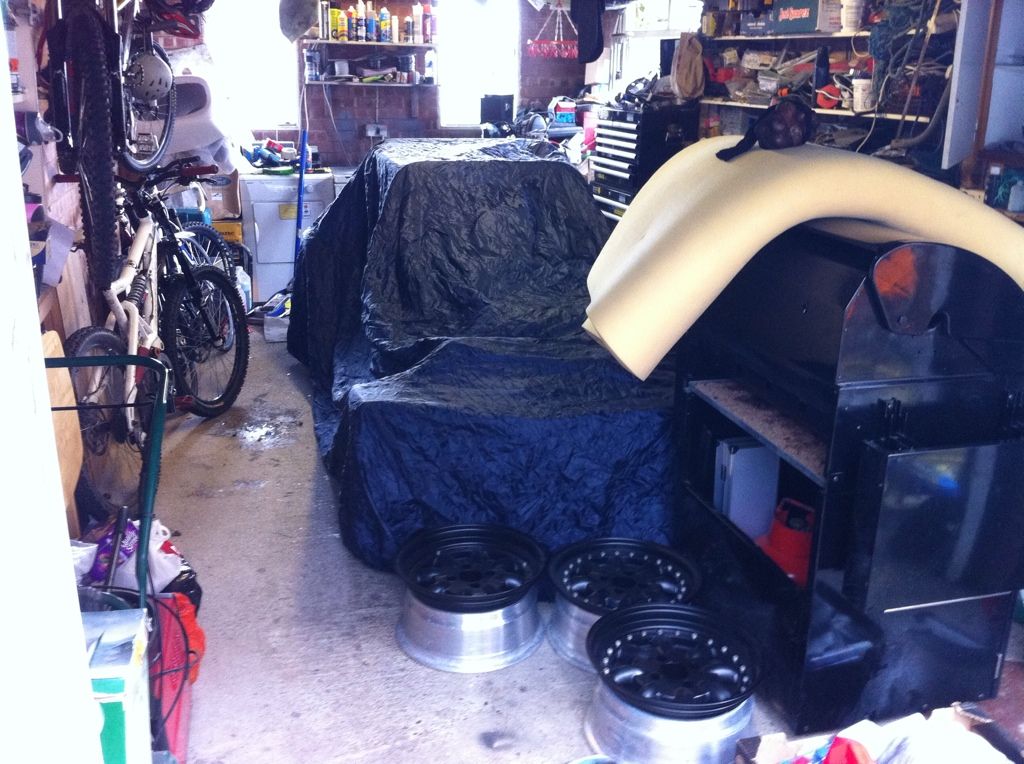

Posted 31 December 2012 - 09:17 PM
carpeted garage luxury with added duct tape
vac tank made, need this to sort the issue of the vac take offs having direct to head throttle bodies
front indicators
sold the 15" splits rims and r888's for a healthy profit
quarter turn fasteners to old leading bonnet edge
big front plate fitted, carnt decide what do do about the plate might run a small one or a vinyl on the bonnet your thoughts would be good on that point
take off the throttle bodies then into the vac tank

new fuel pump catch tank oil hose and heat refelctive matting
breather lines fitted and catch tank

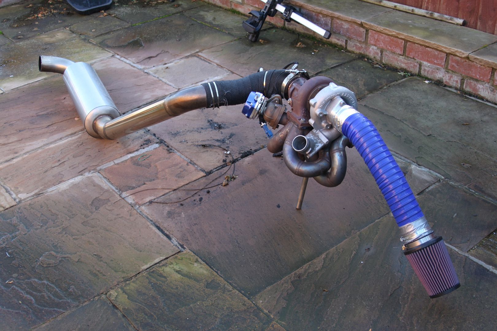

Posted 31 December 2012 - 09:24 PM
exhaust lagged
heat mat fitted
wide angle rear view mirror
had a set of wheel spacers made for the rear
fitted
nearly finished

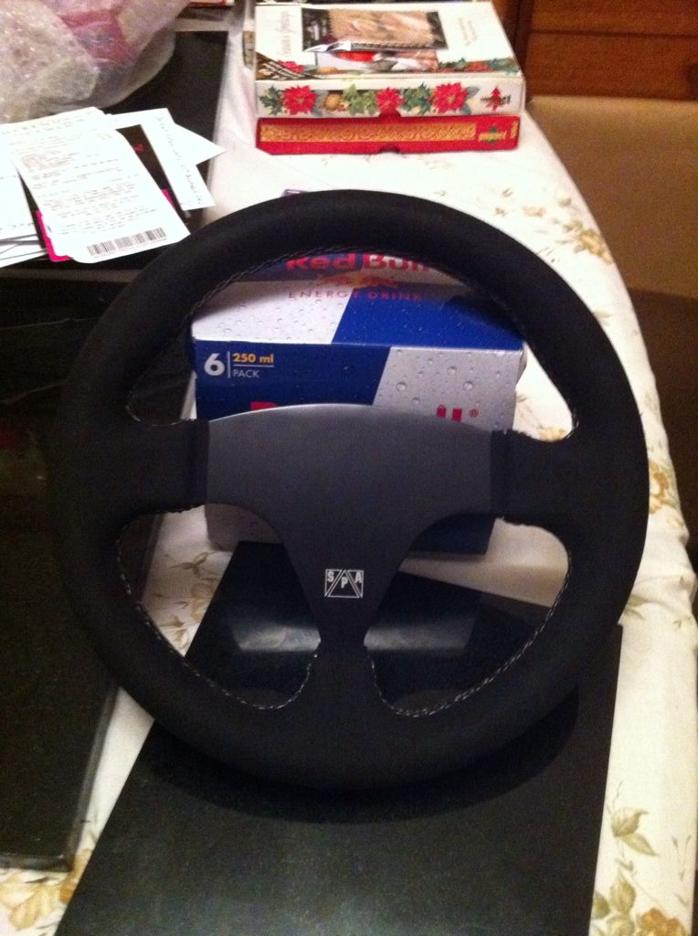

needed to change afew bolts they were not long enough, had play in the steering column too
so on with those tasks, decided to make a new column from scratch to do this exhaust had to come off
got a new wheel too as i like them smaller nice SPA item!

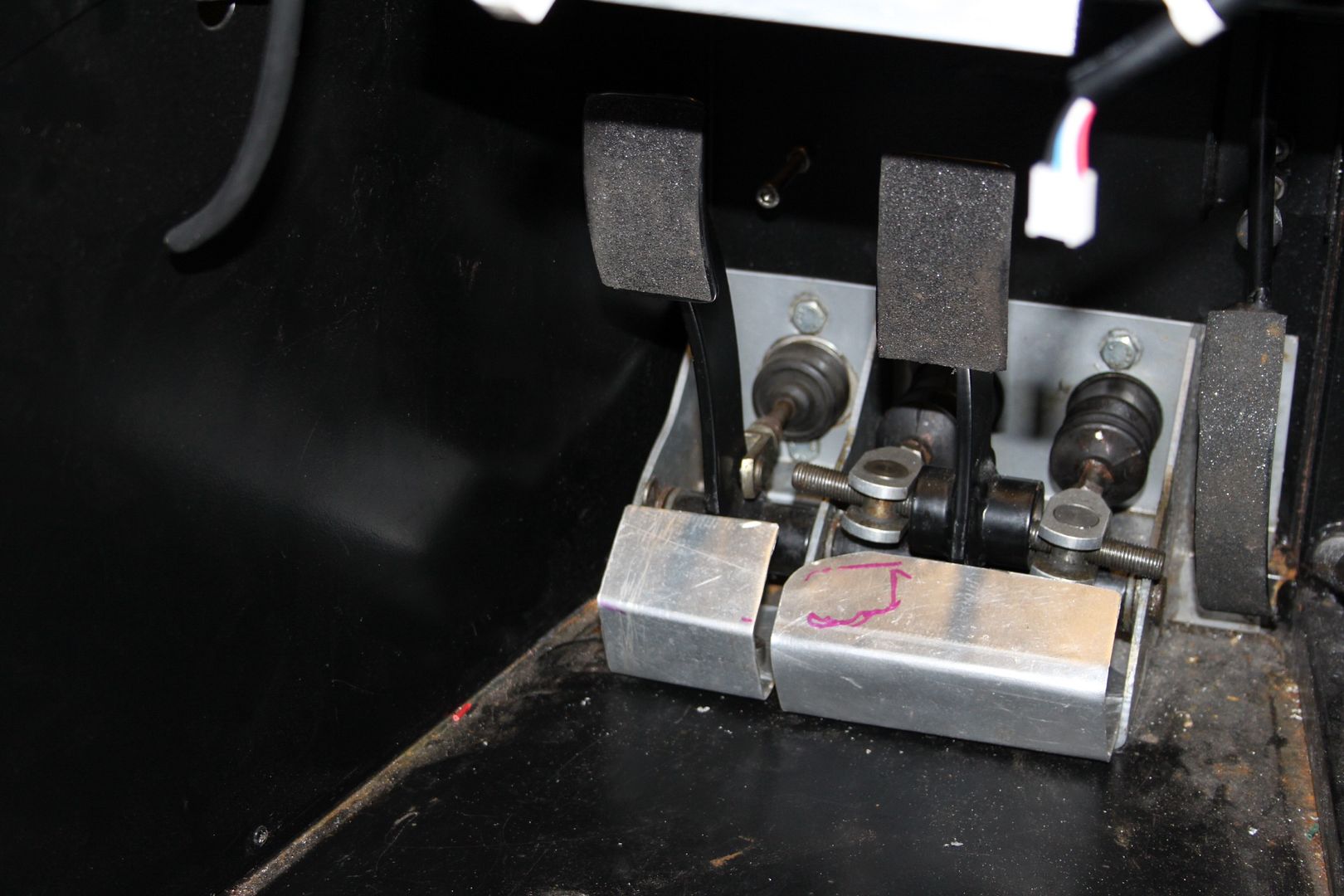

also needed to sort brake lights, they were working from a pressure sesnor in the rear lines but they didnt work untill you really stamped on the brakes which i wasnt happy about
pedal box, small feet need only apply!

column work
purchased the mk2 escort threaded section to cut down and sleave into the lower column i had
test fit column
spot welded up
ready for proper welding
drilling and coutersinking the wheel
mounted

back to the pedals
decided to use micro switches mounted infront of the pedals
knocked up some alloy mount that bolted down to the pedal box
fitted sorry for crap pic

column all fitted and done
well happy with that, zero play and saved some weight
