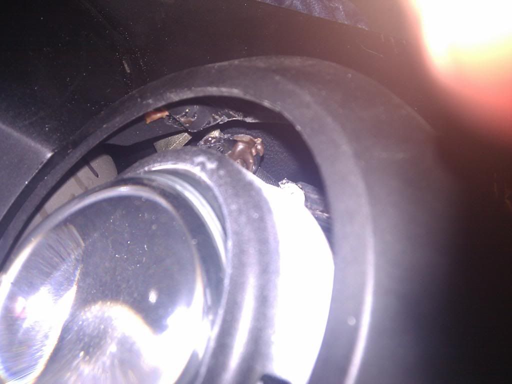

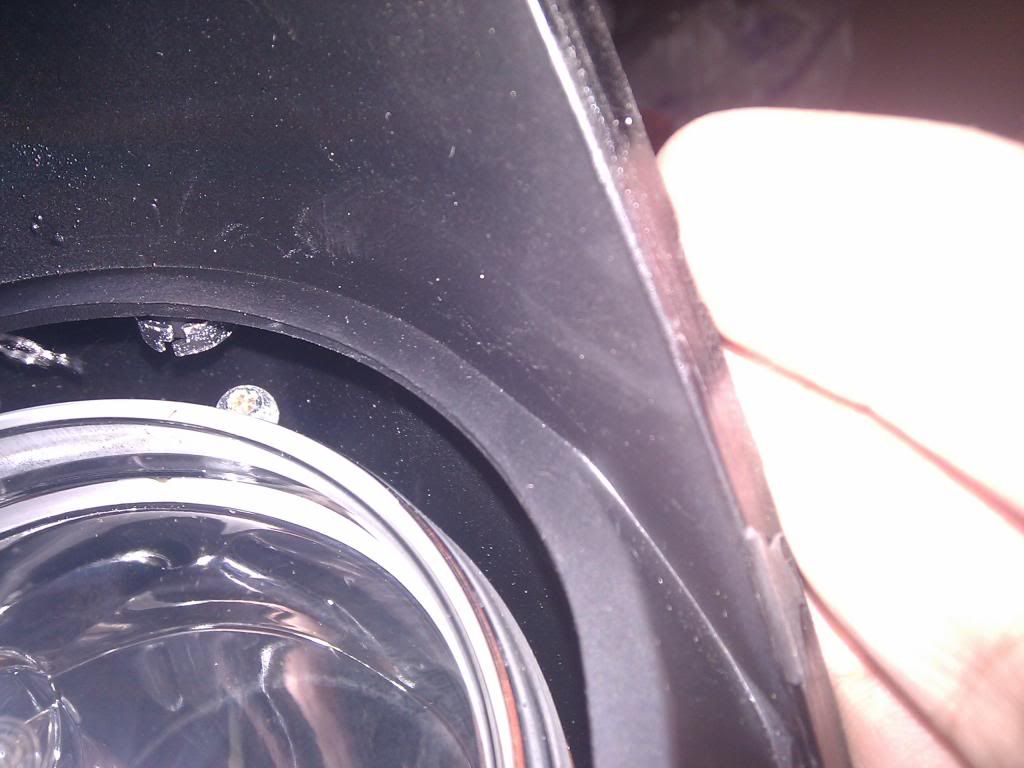

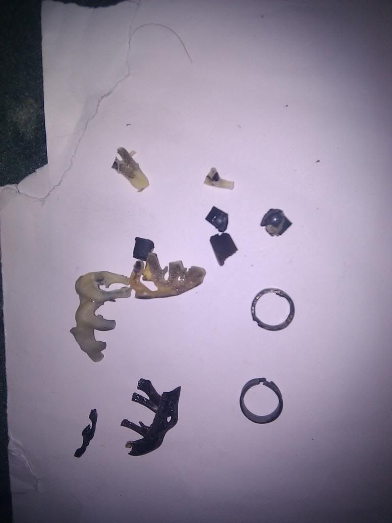

Bad news. Had a proper look at the headlight. Removed the lens and although the lens itself is OK (though a bit scratched), looks like the shock has loosened things up a bit inside.
Lights are not firmly in place, moved around and had some rattles. Bits below...
Lights themselves seem fine. Just the locating points.
I reckon it should be possible to position and fix in place with a suitable epoxy adhesive etc. but could be tricky.
Suggestions ?
#90 Zuber
Zuber
  • 1,429 posts
Posted 20 August 2013 - 10:47 PM
Just to add, most of it just looks like unimportant debris, but I'm curious what the 2 rings are ?
#91 smiley
Posted 20 August 2013 - 11:01 PM
Here's some pixies of a belgian guy doing some repair work on the mount points:
http://www.speedster...t=4575&start=30
Lights out, and rear removed by baking to gain access though.
Interesting, Thanks.
So you can disassemble it... Not sure yet if I need to risk it. Anyone able to advise/translate on 'Baking' steps. Is a Heatgun an option ? Are we working with tigerseal again ?
Google translate so far 80 degrees 20 mins...
I did mine not so long ago, took two crap headlights and made one decent one, it's not too hard, fiddly and time consuming but not difficult if you have some common sense!
I just put mine in the oven on the lowest setting, you'll soon get the hang of how much heating is required to remove the glue, obviously doing small bits at a time, reheating, repeating etc.
#94 fezzasus
  • 7,689 posts
Posted 21 August 2013 - 05:05 AM
The two rings are collars that go around the plasic posts for the light mounts, they're not needed.

#96 fezzasus
  • 7,689 posts
Posted 21 August 2013 - 07:19 AM
A bit more detail about fixing the headlights.
I've deconstructed one headlight to as part of my efforts to produce new ones, the headlights are made up of three parts; the lens cover (obviously), the centre section and the rear cover. The rear cover is bonded on using a black polyurathane glue much like tigerseal, so removing the rear should follow the same approach as removing the lens - in the oven at a very low temperature, put a flat head screw driver to separate the two parts, and re-heat if the glue starts to get hard.
Once you have the rear off you can re-seat the projector units and bond with a two part epoxy.
