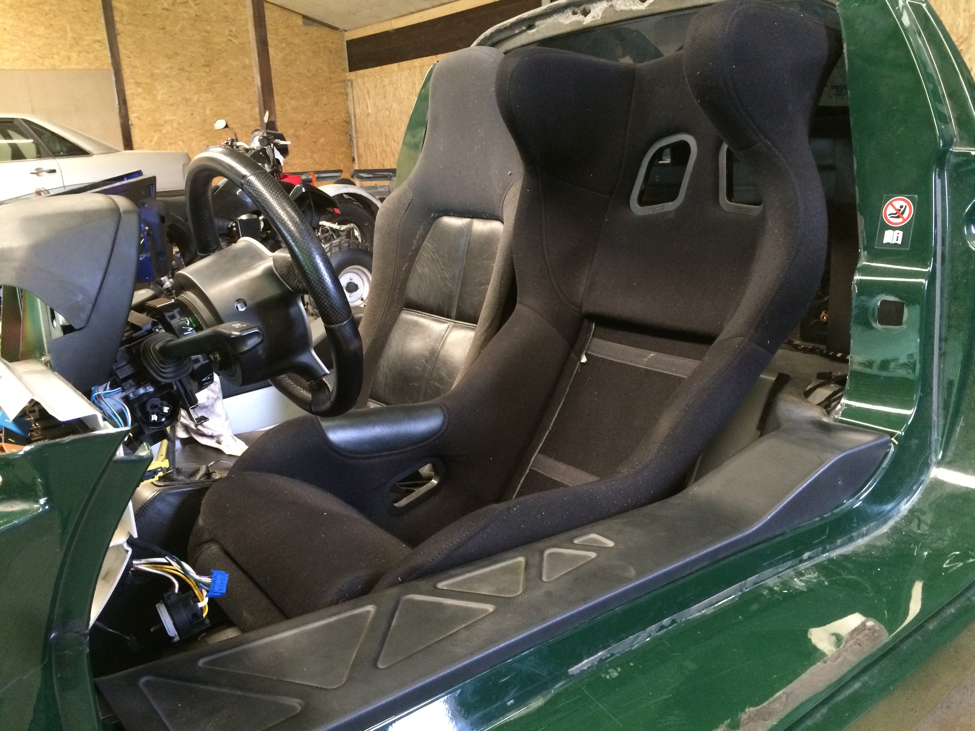

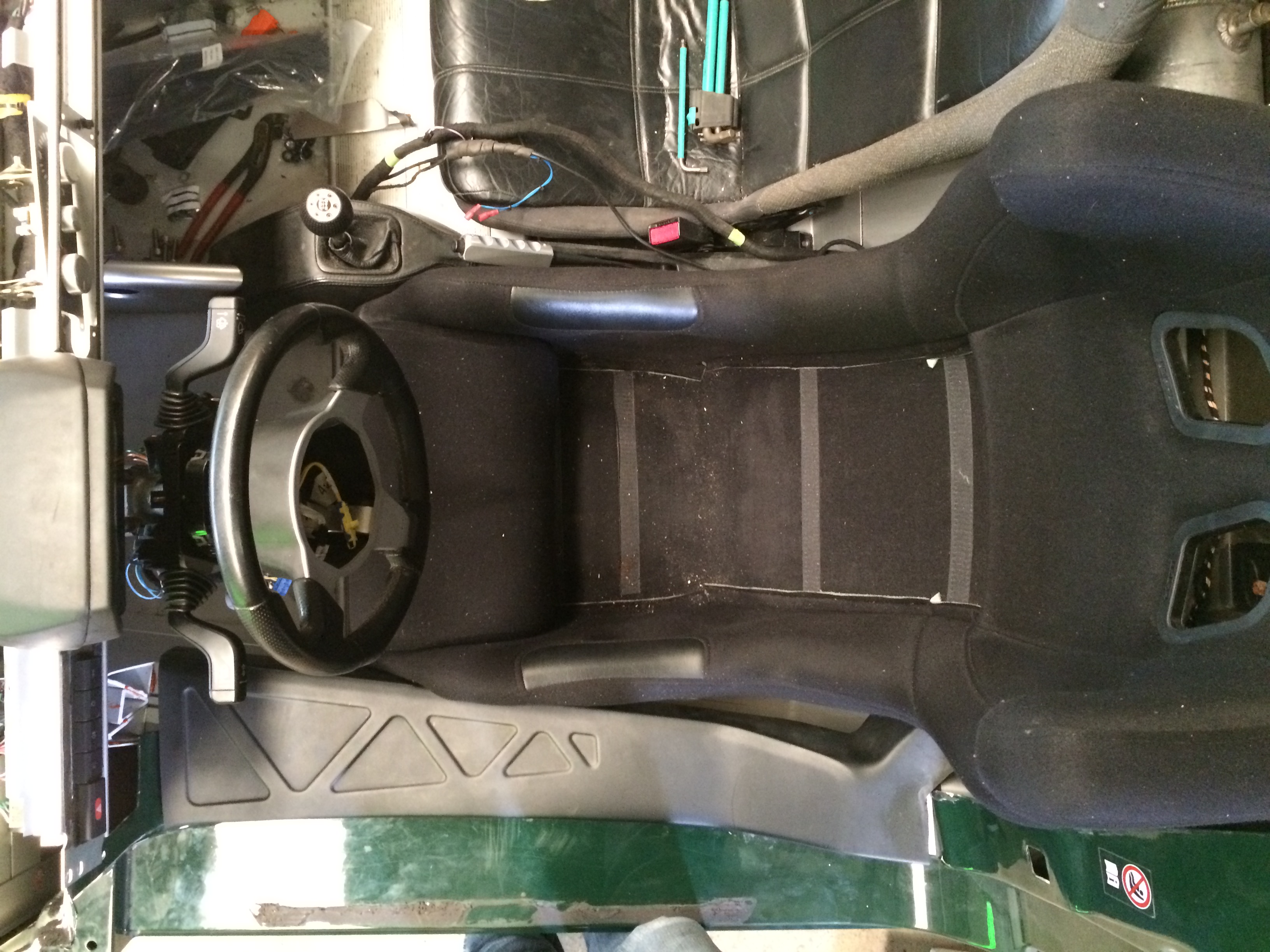

what is this?... a school for ants?
pedals moved ~30mm downrange
Swapped to an S2 Elise roll bar so I could mount the mirco right back up against the rear bulkhead, and have fiddled with 1000 versions of inclination etc to gain as much room as possible
Steering column raised ~20mm at the wheel rim
Stock wheel is 315mm
If I can bring the wheel another 20-30mm closer, fit a quick release, and go to a 330mm wheel, that'll probably get my fat arse finally ergonomic, and let me get in and out of the car!

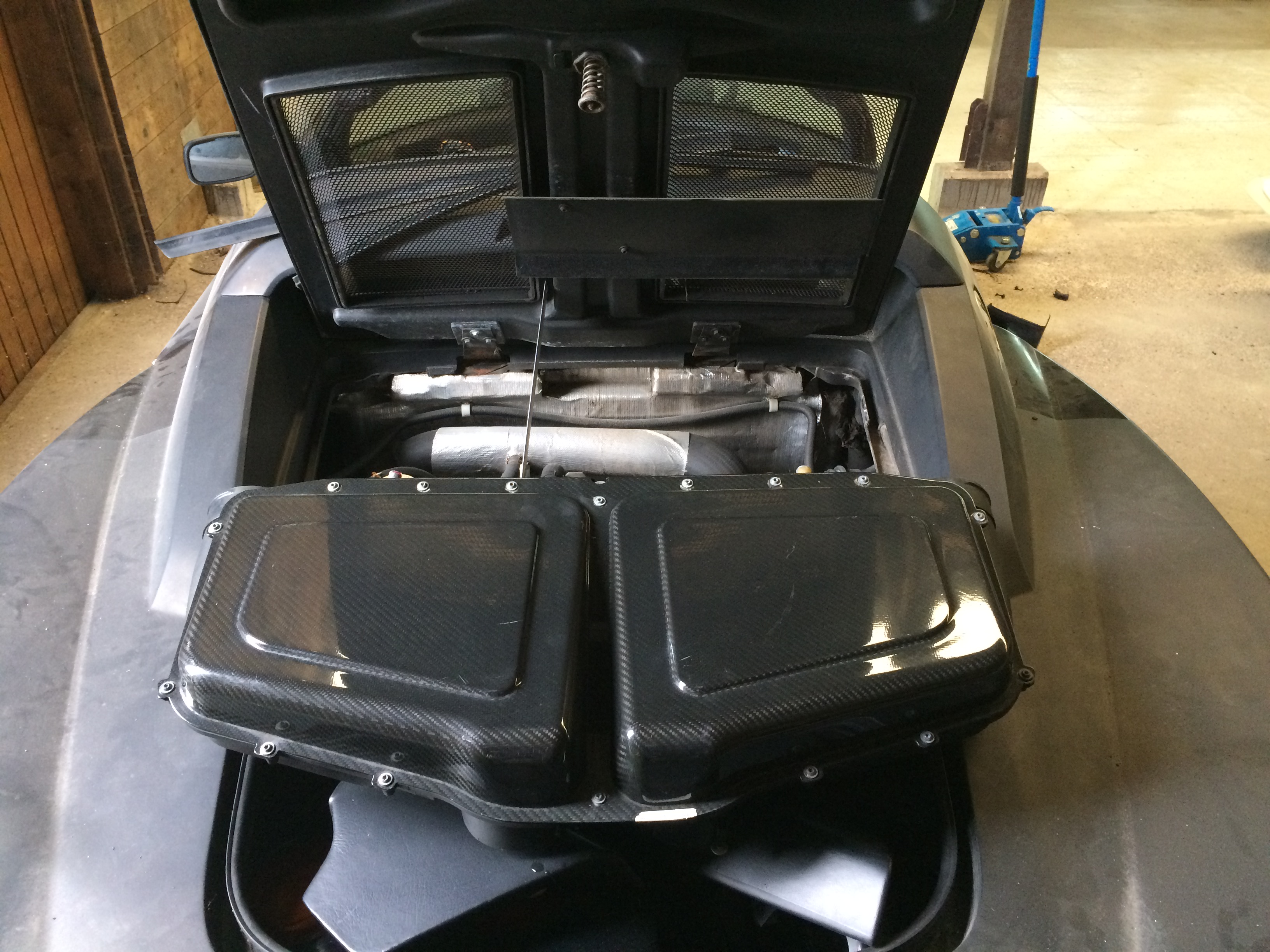

i win internet shopping this week :D
RS6 Carbon airbox with twin 4" intakes and dual filter assembly

#369 ultimate
ultimate
  • 261 posts
Posted 08 July 2016 - 07:37 PM
What are you planing to do with that airbox?

Posted 09 July 2016 - 06:12 PM
Needs a bit of imagination, but you get the idea:

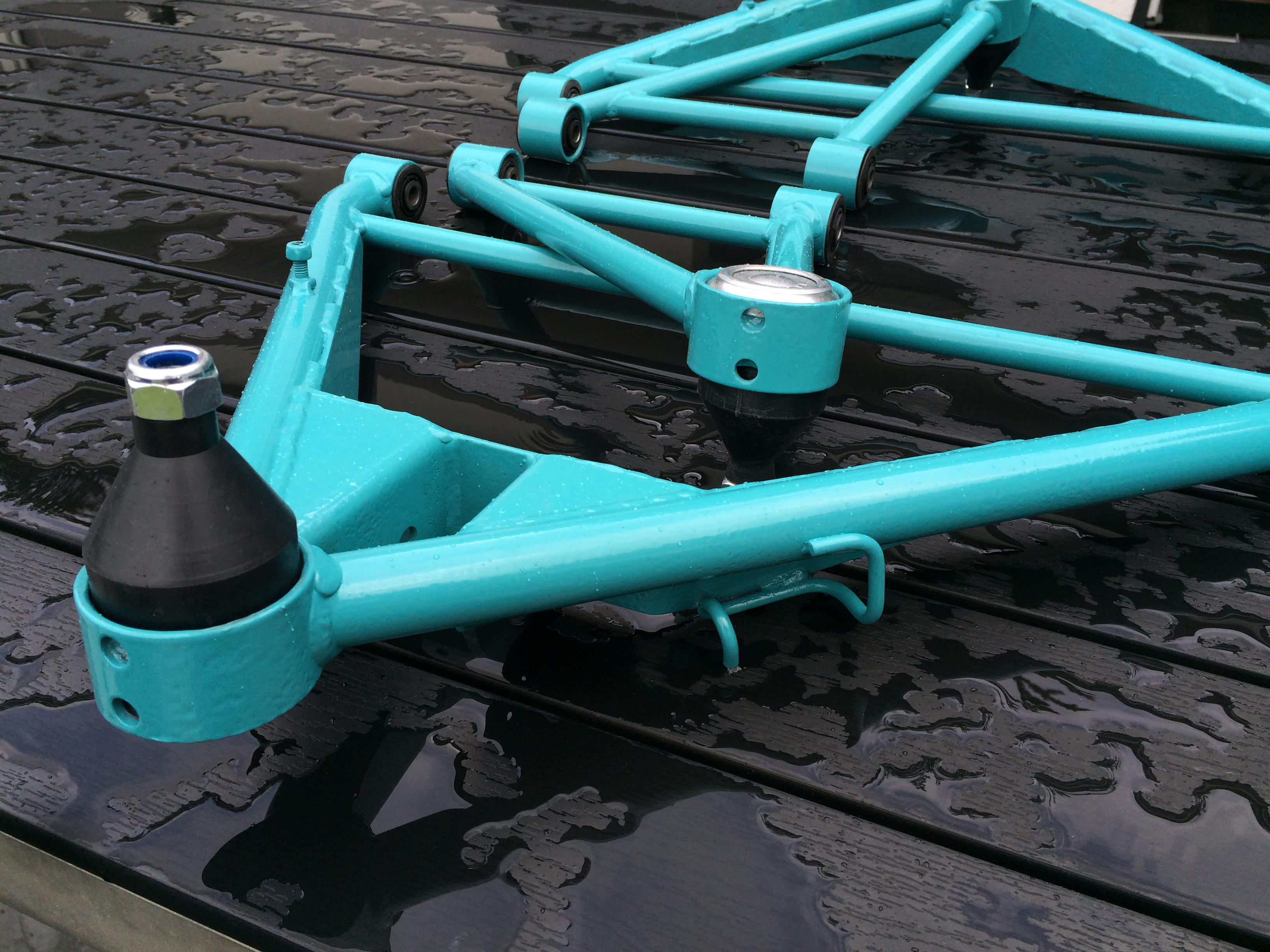

props to Chris and Jon at Jon Seal Sportscars in the UK:
Stripped and Blasted
RAL 5018 Powdercoat
Exige Bushes (Harder Durometer)
Delphi Ball Joints
#372 Doctor Ed

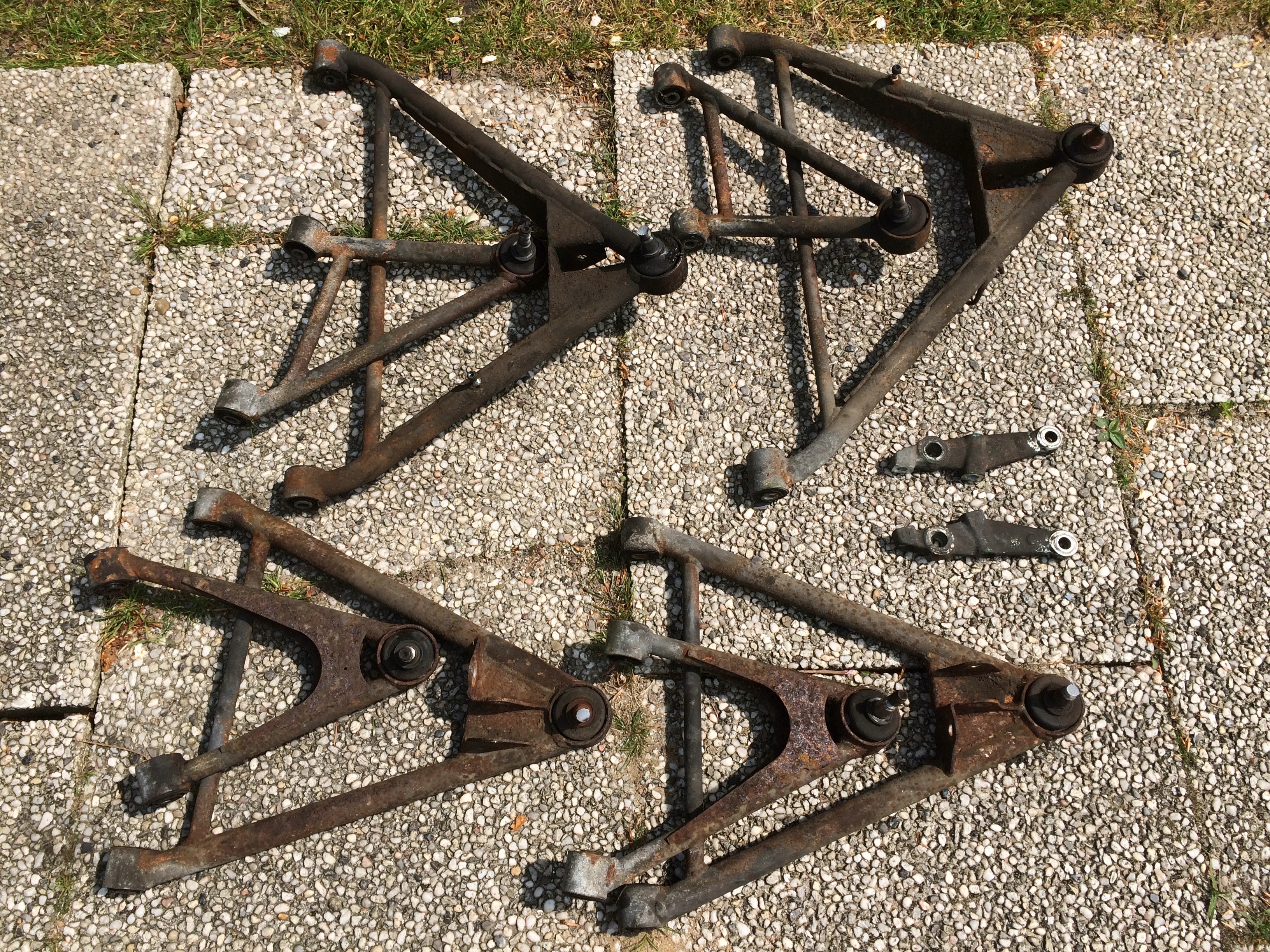

the 'before' shot:

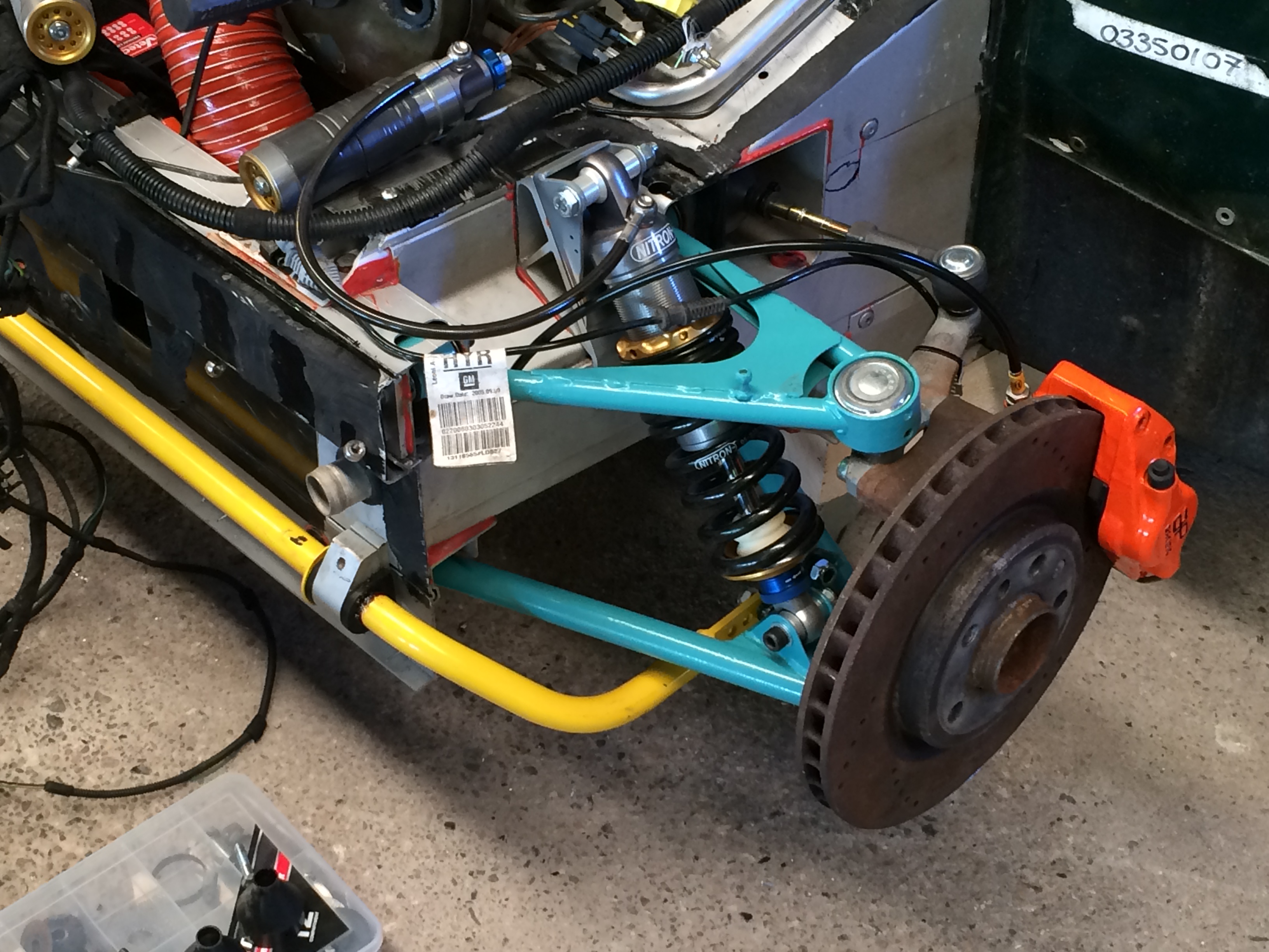

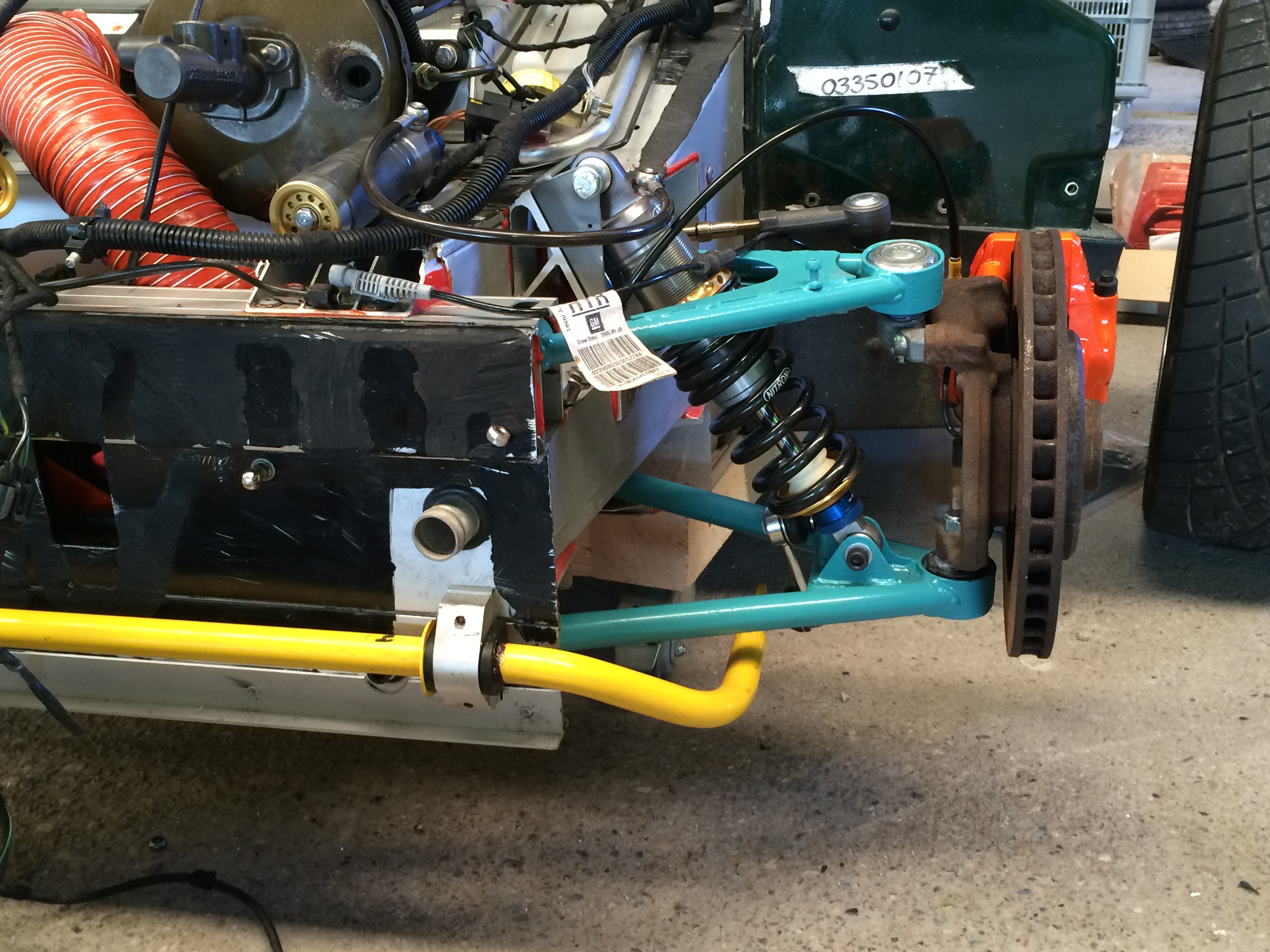

So, despite enthusiasm to get these fitted, I had to make up some caster shims, plus kids and wife got in the way :)

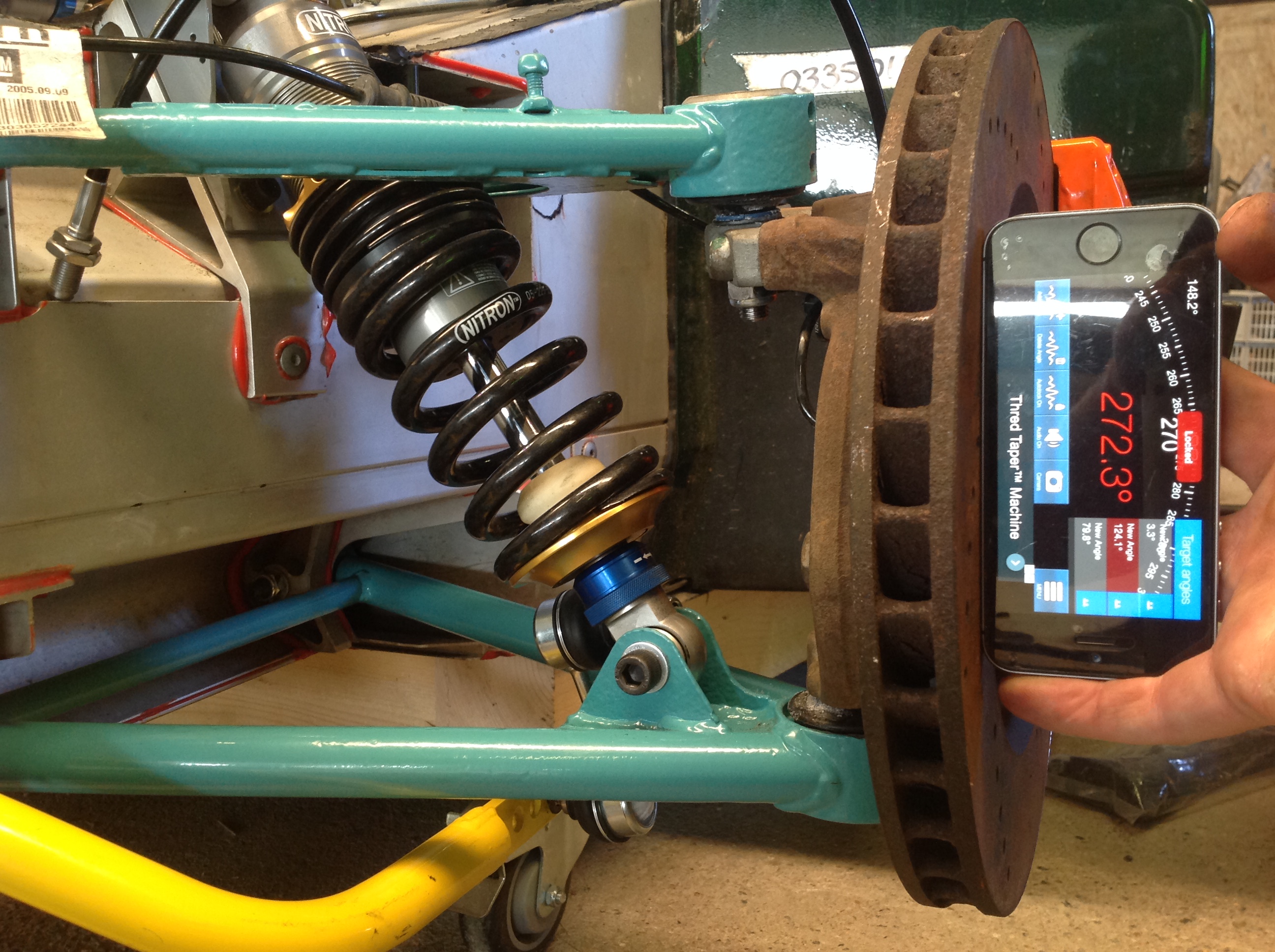

And for my mate Brad
2.3deg of static in full droop (no shims). No idea what neutral position is, so will have to wait till wheels are in and I drop it. Radom guess would be 2.6-2.8deg.
#377 Doctor Ed
Doctor Ed
  • 1,188 posts
  • Location:Germany
Posted 13 July 2016 - 08:36 PM
Actually, looking at the pics a little closer, looks like there's not of droop in it the way the shock height is currently setup... So final static camber is probably more like 2.4-2.6. Still plenty!
#378 Arno
Arno
  • 1,238 posts
Posted 14 July 2016 - 06:32 AM
From the Opel/GM adapter cable it looks like you're going for the new Hall-effect wheel hubs/sensors.
Will you be using the BOSCH motorsport ABS or late (post-2011) Elise/Exige ABS unit?
Bye, Arno.
#379 Doctor Ed
Doctor Ed
  • 1,188 posts
  • Location:Germany
Posted 14 July 2016 - 07:21 AM
to be honest, i havent even looked at detail like that yet. these uprights came out of a 2008 Tesla Roadster and I have no idea what kind of hub sensor it uses.
