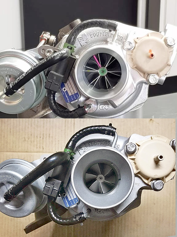

#1122 Doctor Ed
Doctor Ed
  • 1,188 posts
  • Location:Germany
Posted 17 November 2018 - 04:54 PM
hehehe
hope i didnt just fcuk it! its rather large :lol:
#1123 Rosssco
Rosssco
  • 4,185 posts
  • Location:Aberdeen
Posted 19 November 2018 - 09:47 AM
Modified compressor for more top-end flow..? 350bhp should be easy now.. ;)
#1124 Doctor Ed
Doctor Ed
  • 1,188 posts
  • Location:Germany
Posted 19 November 2018 - 01:44 PM
yep :) the stock compressor can make good midrange boost (2.0-2.1bar), but it cant sustain that boost at higher flowrates and noses over pretty badly. so rather than tonnes of boos at 2000rpm, opted for a compressor that flows more up the top. should sustain 2.0bar right to redline now. what the midrange performance looks like well have to see. it is a very small Turbo so itll hopefull still perform well in the low and midranges, just have a bit more puff up top. 350?... the oem Turbo does 350 ;)
#1125 Rosssco
Rosssco
  • 4,185 posts
  • Location:Aberdeen
Posted 19 November 2018 - 05:03 PM
Nice. I thought the standard turbo has to scream its tits off to make 350bhp, so this should be a good upgrade..
Given the rest of the tech of this engine, I doubt you'll notice much discernible difference once the calibration is sorted.
#1126 Doctor Ed
Doctor Ed
  • 1,188 posts
  • Location:Germany
Posted 19 November 2018 - 05:14 PM
yeah 360-380 and its game over really. i think dominik was saying he sees 2.1 bar around 3500, but only 1.5-1.6bar by 6000. that's enough to get a reliable 360, but its wayyyyy off the efficiency map of the compressor
