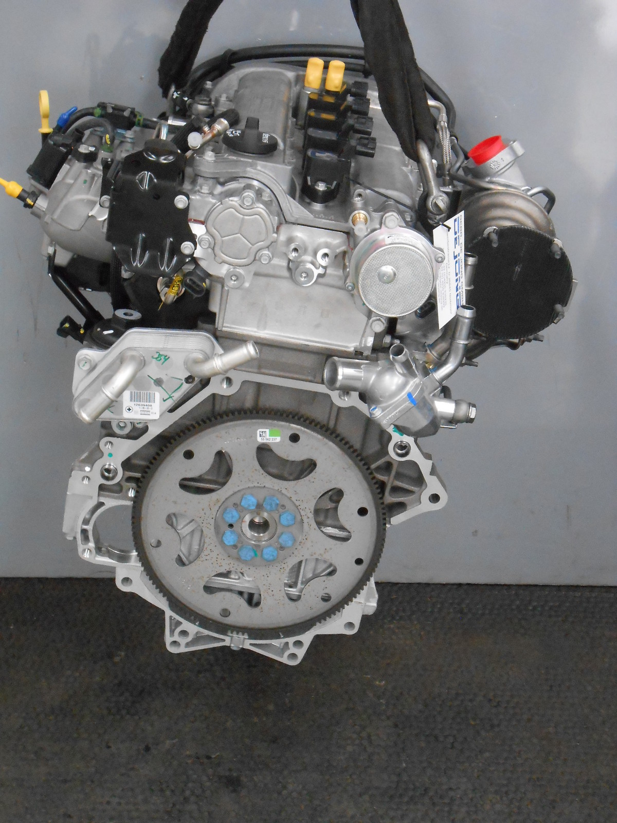

Talking about it in this thread reminded me I needed to talk to the place that had the motor.... Anyway, got off the phone just now owning a factory new A20NFT That pretty much settles that then!

#179 Doctor Ed
Doctor Ed
  • 1,188 posts
  • Location:Germany
Posted 08 April 2016 - 06:05 PM
