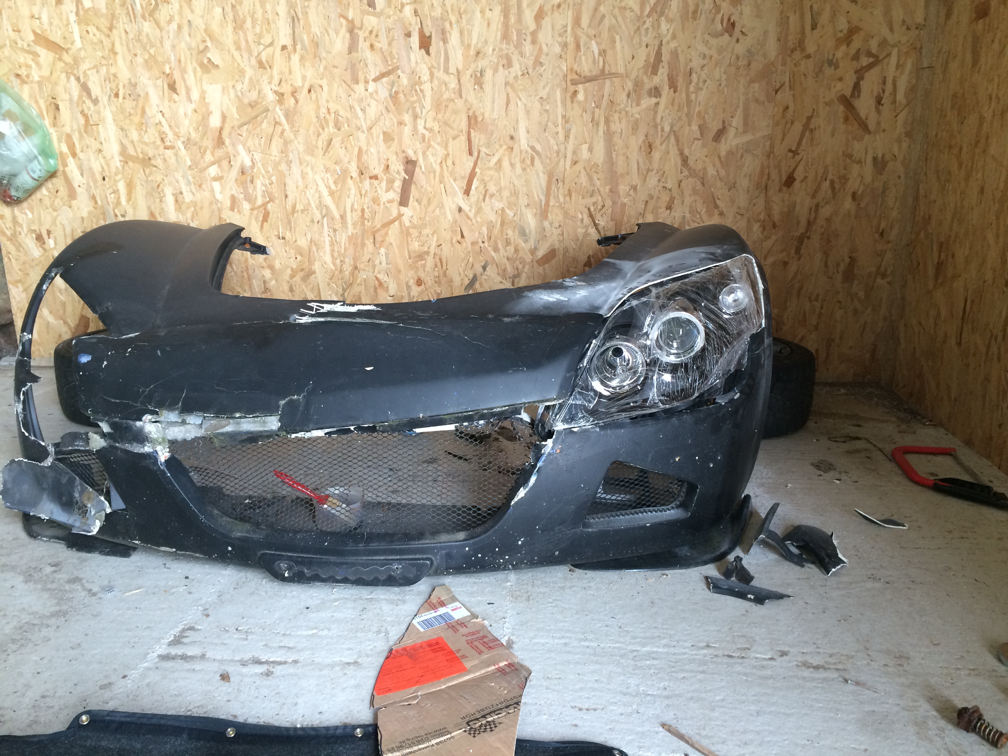

the dead clam in the corner fell victim to a moment o f'wonder if this will fit
Renault Laguna III sedan headlights
for relatively littel fiberglass work, these would actually fit pretty damn well.
- will park that idea for when ive got the luxury of time
Edited by ed.oates, 04 April 2016 - 06:31 AM.
#144 Mangham54
Posted 04 April 2016 - 06:43 AM
You aren't the first, I just recall the last to try found they looked out of place once they were glassed in and painted.

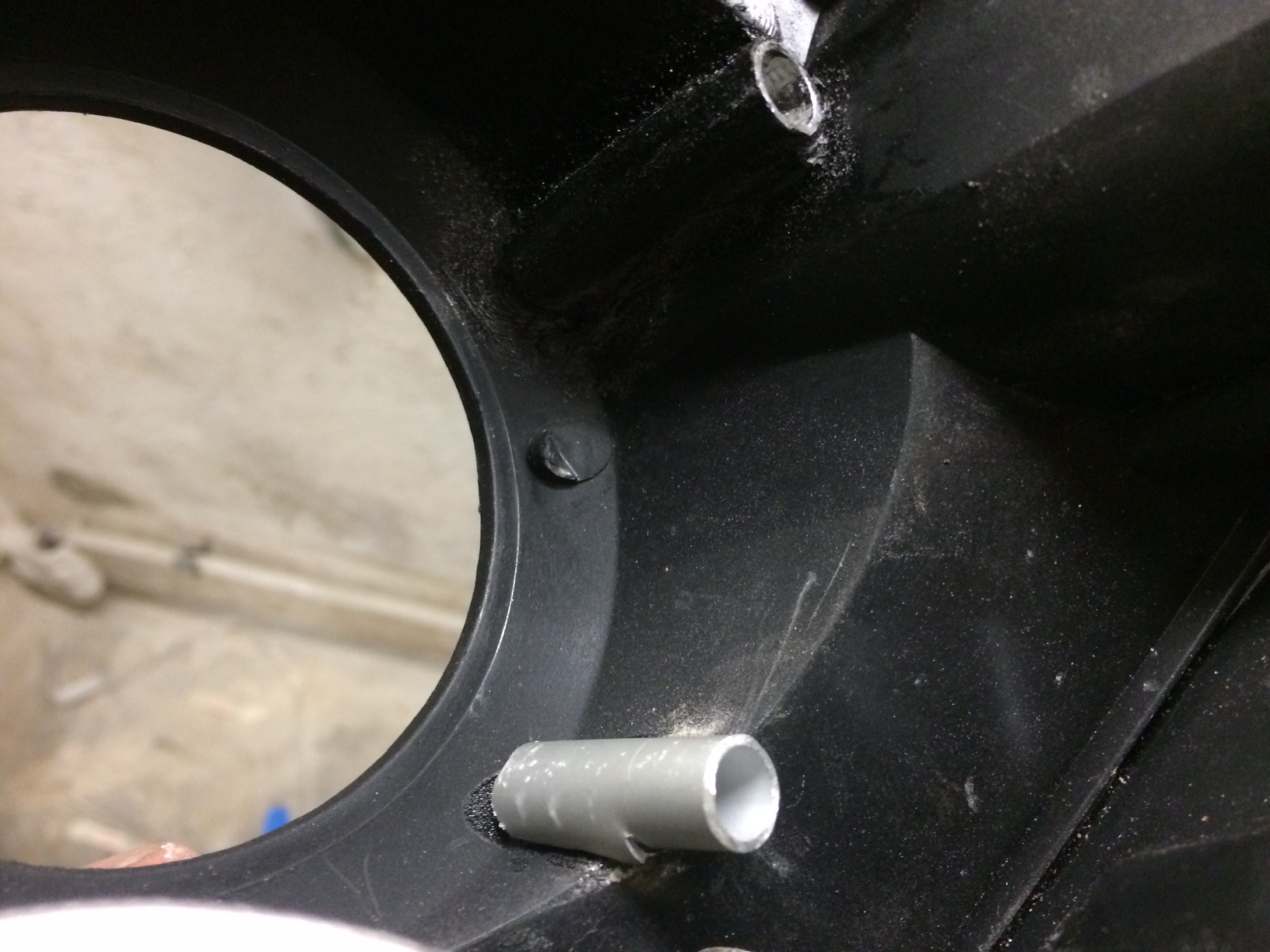

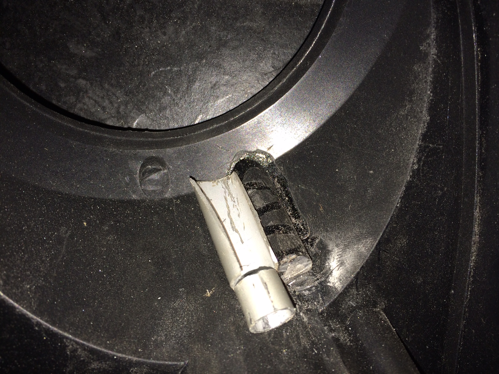

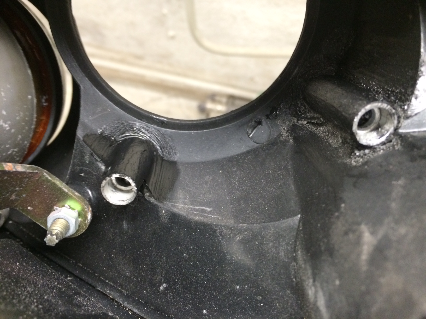

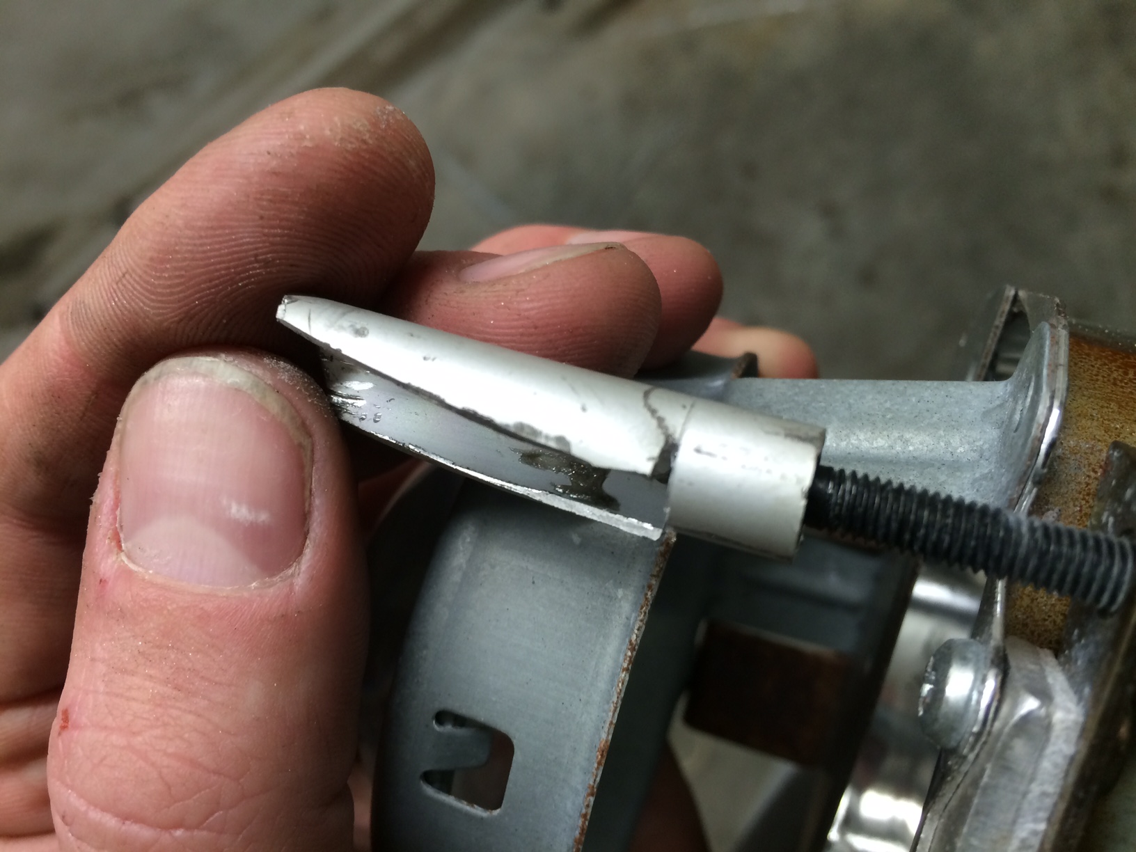

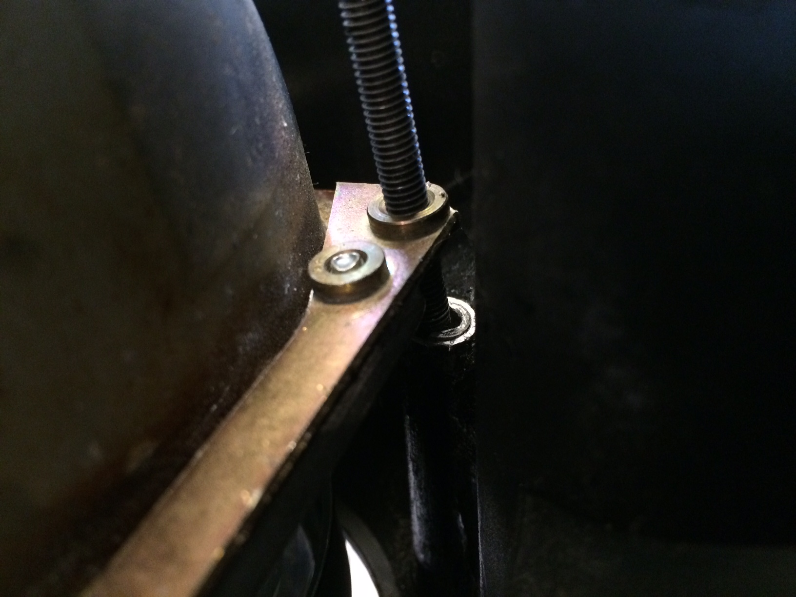

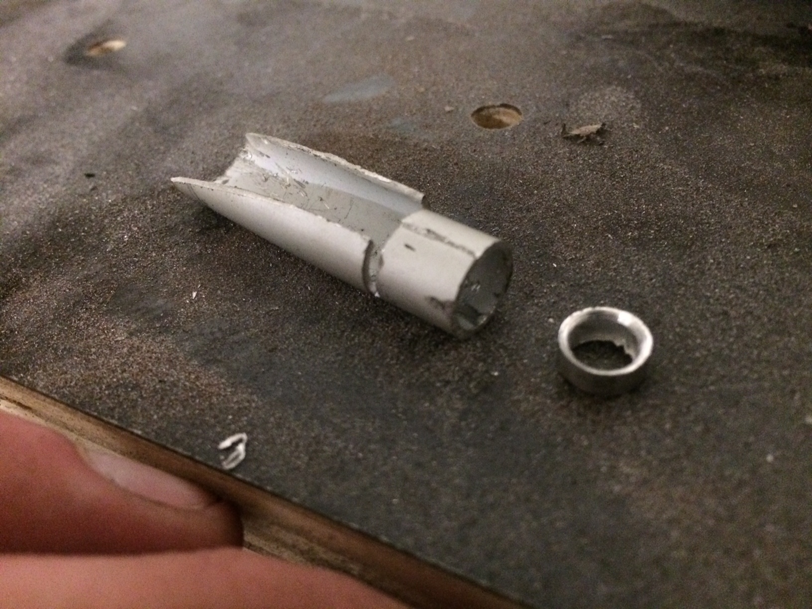

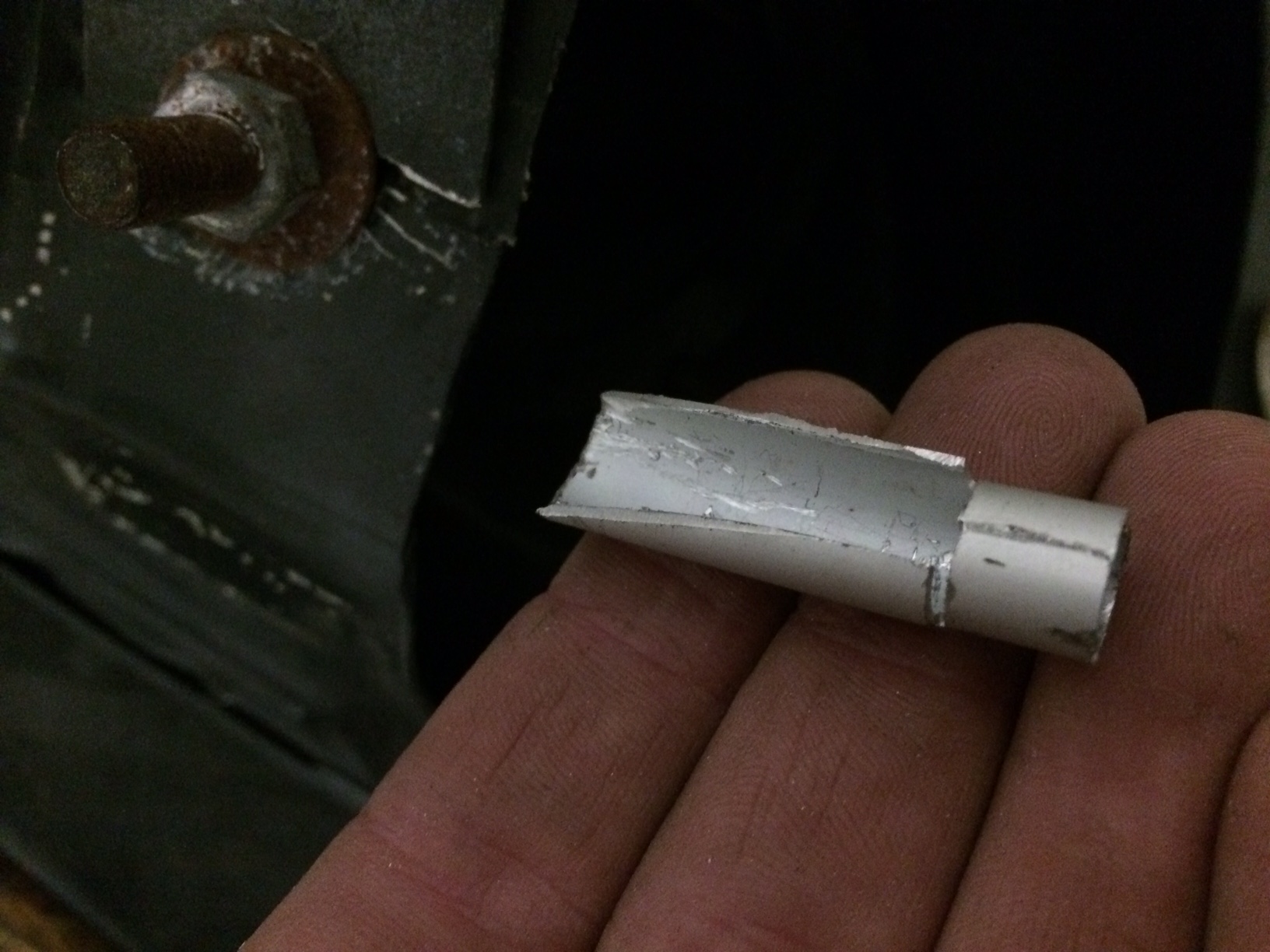

so my headlights balljoints were busted
now fixed
#147 Doctor Ed
Doctor Ed
  • 1,188 posts
  • Location:Germany
Posted 07 April 2016 - 06:38 PM
Edited by ed.oates, 07 April 2016 - 06:39 PM.
#148 Doctor Ed
Doctor Ed
  • 1,188 posts
  • Location:Germany
Posted 07 April 2016 - 06:53 PM
basic details (the pics fill in the blanks!):
outer sleeve 10.0x1.0mm tube
inner sleeve 8.0x1.0mm tube
10mm sleeve cut to length (42 and 30mm respectively)
the top 10mm of the tube kept in tact, the rest of the length split, profiled, and opened so as to 'click' over the existing plastic stump
palstic stump trimmed so that the top 10mm of the tube sits flush over the top
inner sleeve / lower locating ring made and chamfered 45deg, insetred into the base of the top 10mm section
bonded in place with loctite 660
the whole shebang then 'clicked' over the plastic stump with sikaflex 221
further inner sleeve / upper locating ring made, chamfered and slotted, then slipped over the threaded rod above the ball
headlight reassembled, balls slid into new aluminium receivers
upper locating ring then slid down over the ball into the 10mm tube, again bonded with loctite 660
worked a treat, joints are pretty firm, but turn smoothly with a socket
aluminium/sikaflex/loctite isnt going to break  :tt:
(but really, what a sh*t design these things are!)
