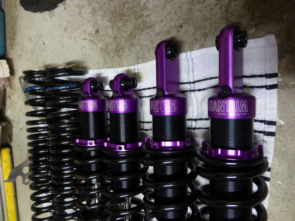

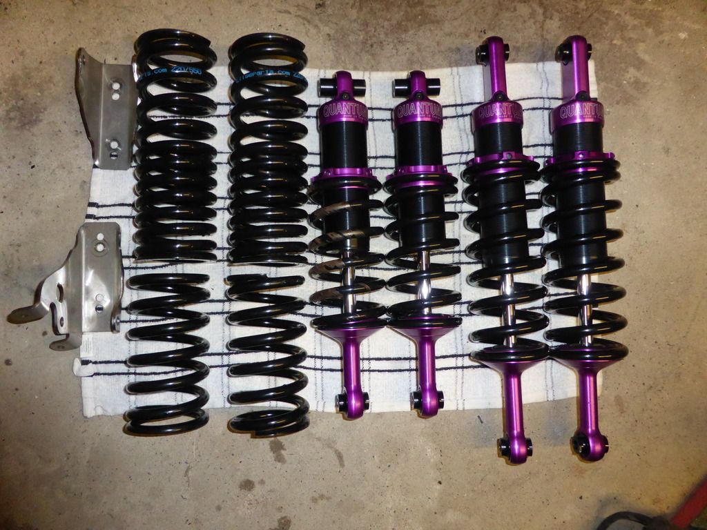

#5 Horace
Horace
  • 1,290 posts
  • Location:Barnsley
Posted 13 April 2016 - 06:27 PM
Oh and here's some pictures of the lovely Quantum's (after removal from the car).
