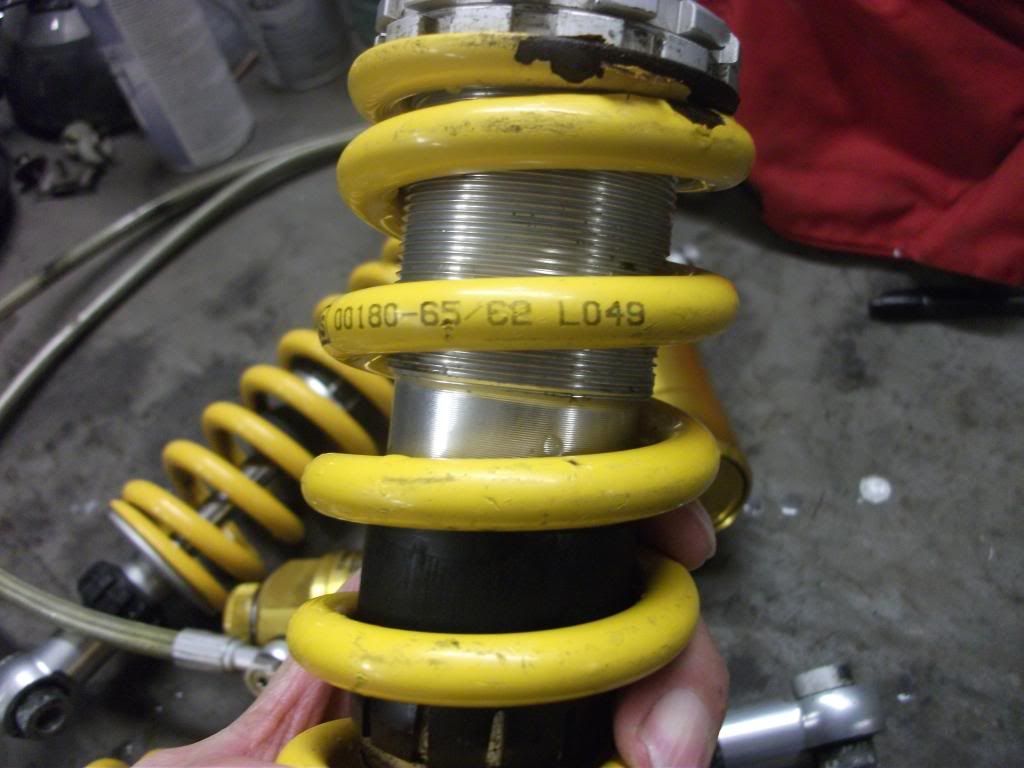

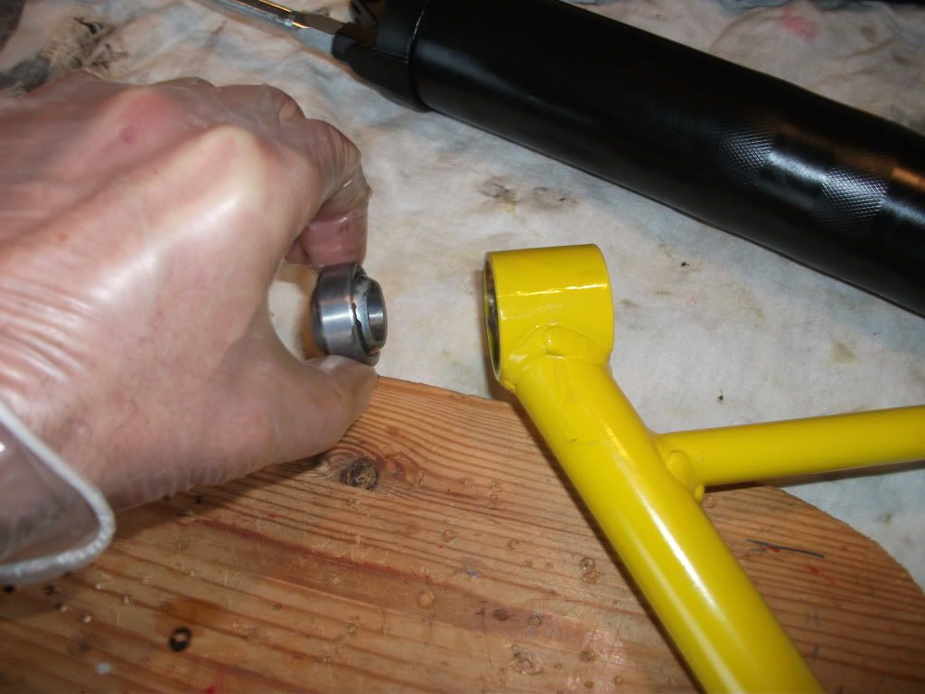

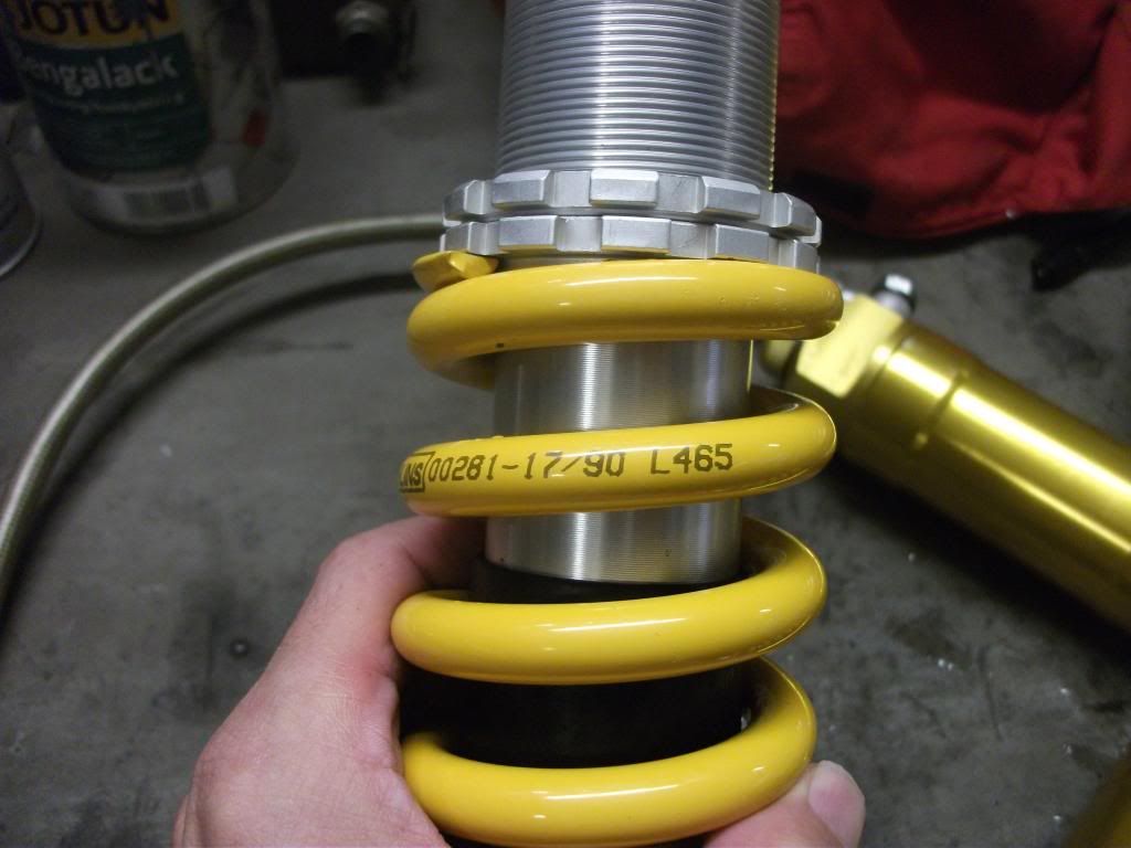

Hi
I could try to write something about "rose joint" mine also comes from Elise Shop but they are the same as Nitron.
But remember this is written in a language I normally do not use, so something may be lost in translation.
I made several modifications simultaneously.
ARB front and rear of http://www.cornering....com/index.html
Light flywheel
Removed balance shafts. (NA 2.2)
New engine mounts.
To begin with, I used the original Bilstein shock absorbers with original springs.
These were switched to Ohlin with relatively soft springs,In terms of comfort, it was not much difference between these two But in handling was a big improvement.
Do not think the comfort was so much worse with"rose Joint" compared with the original bushes.
Whatever comfort is not the reason why this car was bought to begin with?
I have no problem about recommending "rose Joint" if the vehicle is used on track occasionally,if only for road use is perhaps a bit too much?
And it is perhaps a little more maintained with these?
FRONT
Back
