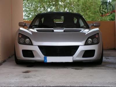

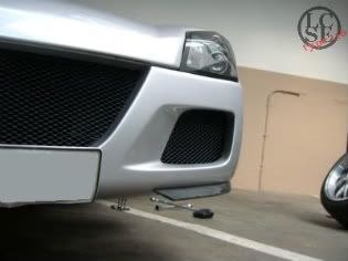

if there were to be any change to the original i think that all of the suggestions so far have covered them (CF :wub: )
but silent1 got me thinking re the fog light/ colling ducts and remembered one of jawz photos on his site
the only clam mod that compliments the original imho B)
as for the rear grill/ heat shield the only thing that springs to mind is some kind of louvered section instead of a grill??

severnless - I really, really like those but I'm not quite sure what they'd achieve? You've got the radiator cowling behind there, if you remove that you have the arch liner, removing that you have the tyre face... luna - not THAT expensive but you'd have to assume only one person was going to want a set of them like that and price accordingly which would probably stick a couple of hundred quid on the price for that one. The front arch vents could be moulded straight in but I'm not sure what you'd achieve that couldn't be done by a bodyshop with a bare clam for the same price?

I can't be alone in thinking that looks the nuts?? :wub:
