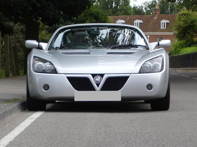

I put them on today. I thought I was mentally prepared for the shock of the tractor gap but it still pained me once I saw it. The pic below is slightly wrong as there is a side slope on the drive and the gap is a nadgers bigger than it is in the garage. That said, it will go up with VXR suspension so the pic is representative in this regard.
I really don't know whether to go with the brackets (bear in mind I am clueless and will fail to fabricate any form of ABS bracket), the grooves in the suspension (let's be honest - I'll ruin the suspension, have my eye out or both), leave it and don't worry or buy some other sort of suspension instead. Gonna sleep on it.
Need to swap the insurance over before I can drive it ....

Retset,
Now you have the 16 inchers on the front, if you have time, measure the centre of the 16 wheels to just under the arch.
On the VXR it is about 368mm, both for the front and rear wheels from wheel centre to arch. I know the NA is a bit lighter, but unless the suspension pickups are different from NA to VXR then I assume your NA would sit at about the same ride heights (just a touch higher due to less weight) as a standard VXR when you fit the VXR units on a NA.
Your front ride height with the 16s on looks much higher than a stock VXR with 16s in that photo.
Edited by burnerblowout, 22 July 2008 - 03:59 PM.

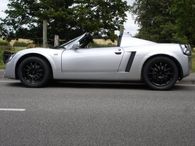

#54 Retset
Retset
  • 1,766 posts
  • Location:Somerset
Posted 22 July 2008 - 04:17 PM
BB,
I measured it last night in the garage (i.e. on flat ground) and it was about that figure - 367mm as near as I could tell. As I mentioned above, the photo was taken on non level ground. I could get one finger more in the right arch than the left but the same once in the garage.
Here's some pics I took today. Parked on a camber but fairly representative although I forgot to count how many fingers would fit ... if you see what I mean :blush:
Still look too much? I'll re-measure when I put the car to bed later.

#56 burnerblowout
burnerblowout
  • 290 posts
Posted 22 July 2008 - 04:35 PM
Have to say that looks about right to me and your measurements back it up. The VXR coilover units should also be slightly shorter than the NA units when measured from the unit centre line mounting points due to the higher VXR spring rates. I will be surprised if the ride height changes from what you have now when you pop them on.
