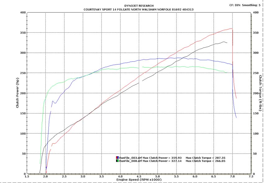

We are going to run the car later today (first chance we've had) with standard cams, just to see what difference they make. I will post the graphs later. Jon

Okay here is the graph
327BHP 266LBFT
The Comp cams certainly do help! However the standard 2.2 cam profile does give more bottem end torque with an extra 45 lbsft at 2200 rpm. We also hit peak power with the standard cams at about 6850 rpm. chinky chinky

Amazing the difference the cams make, they will have to go back in ASAP ;)

We've been playing with a new Harrup HTV Supercharger. This unit is a direct replacement for the LSJ M62 with an output of 1.3L VS the M62's 1.0L litre.
The engine is a 2.2 with Steel Rods, Deleted Balancer Shafts, Modified Head and Cams, 470cc injectors, complete with an awesome 3" 2bular system the Manifold is a 4 into 1 design with 2" primaries- thanks Jim.
359.93 BHP & 287.35 LBS FT. You can also see that we have not hit peak power, just smacked the limiter set @ 7000rpm!! Yes we were tempted to rev it further but we have maxed the fuel pump, so thought better off it :wacko:
:blink: :blink: :blink: Now weve got to turn it all down as our brief for the build was 300bhp !! and we are a little over the spec for the pistons!!! :blush: Jon

Yea the Harrop bolts straight on although it uses a 68mm TB the pistons and rods are perfect so no mods there. The head will be good as well as it has stronger valves. Double valve springs with the com S/C cams. Piper are doing a 2.5 exhaust but 3 inch will almost certainly be required for these levels of power. High pressure fuel pump also.
With standard cams we came up with 327bhp so you want the comp ones. It seems a stand alone ECU will be required at the 400bhp mark.

What pulley size and pressure did you run for this power level?
For sure there is some extra headroom in the Harrop, as the US guys run around 320-340WHP with the standard 2.0LSJ engine. :rolleyes:

I am running the Standard 80mm size but I believe they run them at the 70mm size and below + watermeths Not certain the engine are standard at those BHP
