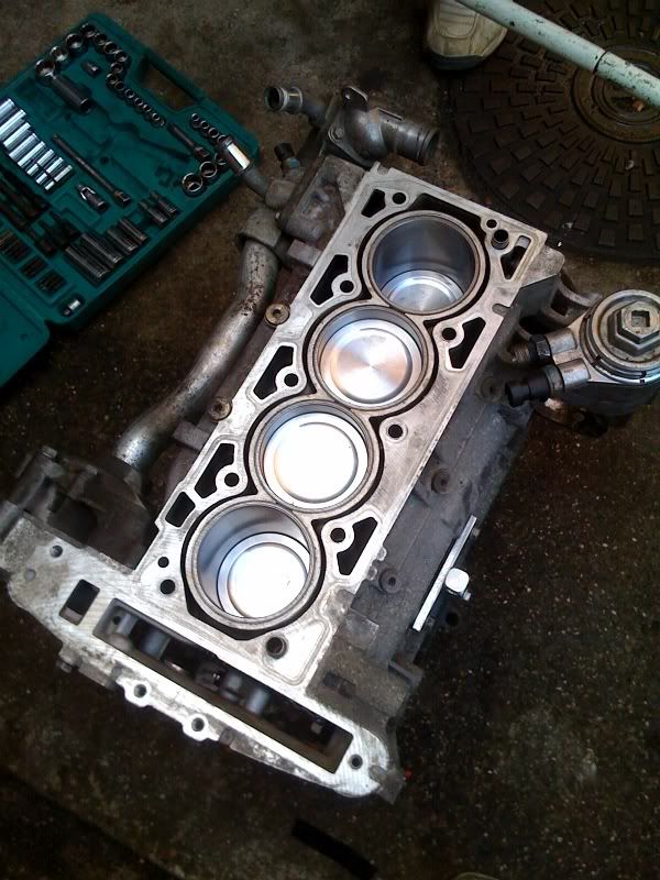

Posted 01 May 2009 - 07:59 PM
your pistons and rods look even better fitted Imnotworthy
#207 The Batman
Posted 01 May 2009 - 09:45 PM
you cant say that without posting a picture!!!

Posted 01 May 2009 - 10:01 PM
Does that mean you've had the rebore done Joe? Did you use T&L?
#210 The Batman
Posted 01 May 2009 - 10:15 PM
yup rebore was all done by T and L engineering, they are top guys £84 £20 a bore and £4 for pressuring washing etc. top guys!

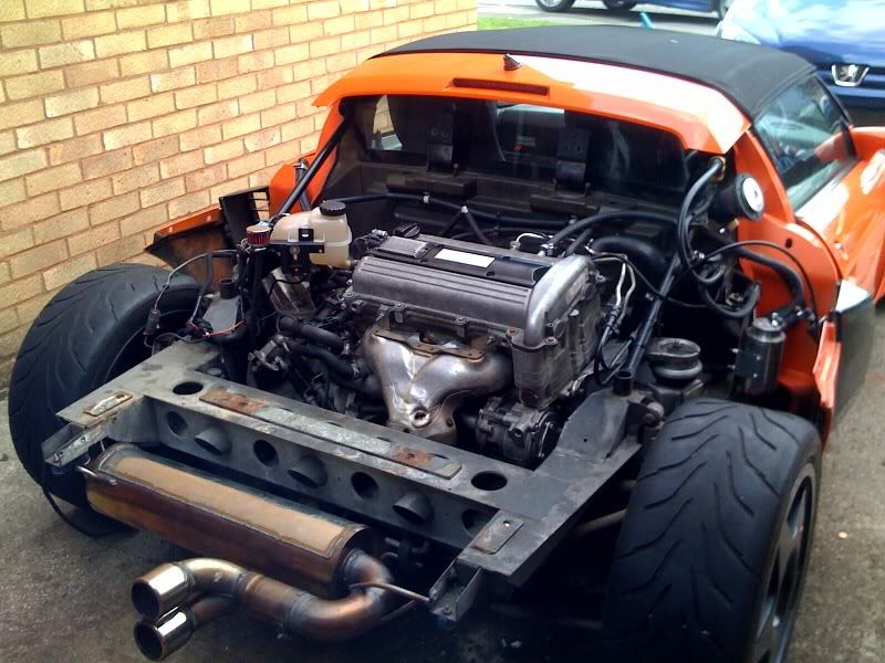

bye bye shiny parts:
4 hours after starting B)
just waiting on duel pass mod and charge cooler rad to come from courtenays...

#220 The Batman
Posted 02 May 2009 - 04:15 PM
cant go on because the duel pass mod is not on
