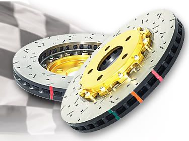

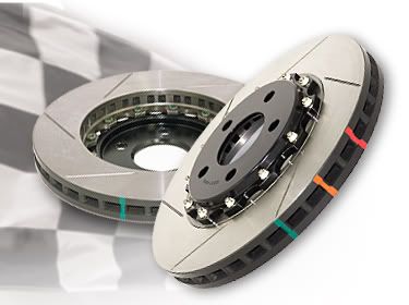

DBA make an off the shelf 288mm dia rotor, with their 'unique' vented design, but they can't supply bells for a 5x110 pattern (without minimum order etc..)
They come out at £210 + VAT for each rotor including fasteners
They weigh in at 6kg per rotor, or 5.5kg if you were to go for the 'upgrade' 296mm dia rotor
