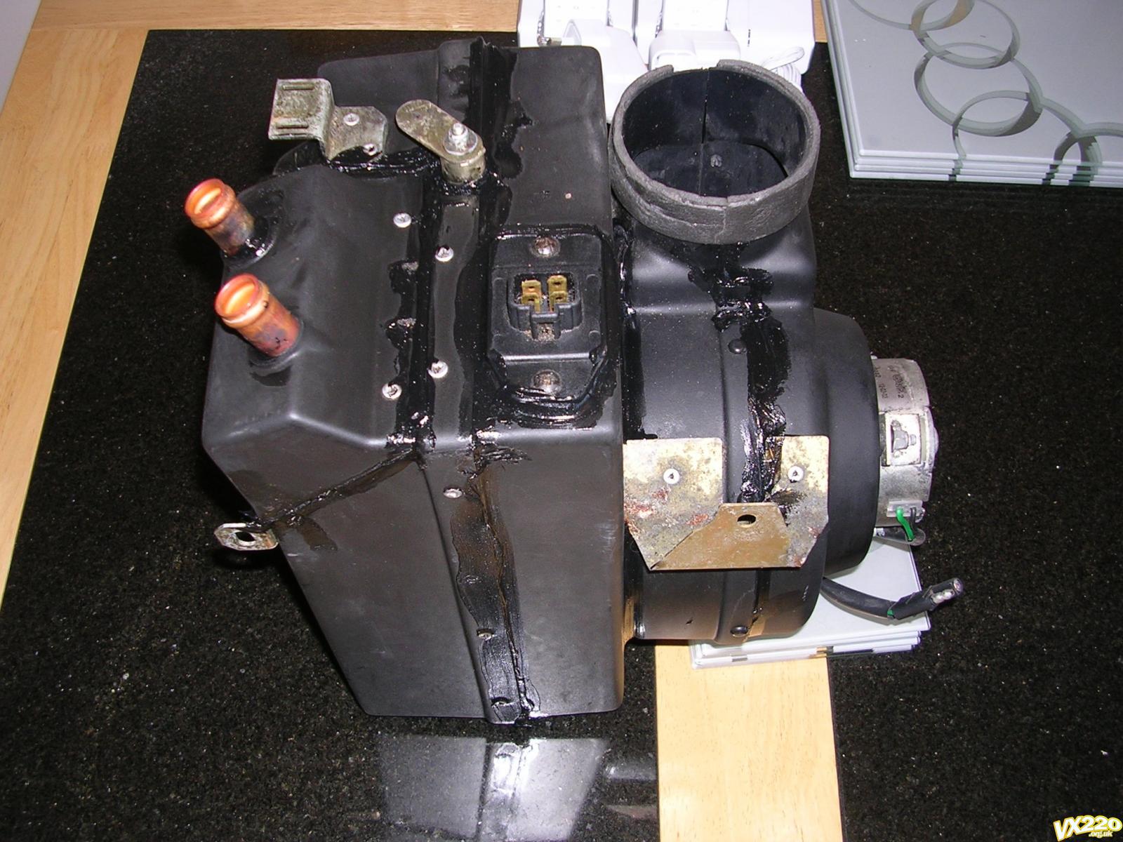

Sealed up the underside of the dash and Managed to fit the new heater pipe this afternoon, the car took forever to reach 85 deg but once it did it was nice and cosy inside, i gotta say i was perhaps expecting a little more flow but i guess its only a little fan in a small box, still, happy with the results, especially if the 2 fartherest vents are closed, dont know how bad it may have been as ive never been in a VX before. I'll just have to remember to leave the heater on the night before and warm the car a little earlier than my last car. Spoke to Village Fox or MVS racing in wales regarding my clam and i was told it would be on its way tomorrow for tuesday delivery. Its like christmas come early :) Just need to source a passenger side headlight and im almost ready for MOT time. http://www.vx220.org...197_1237265.jpg Stereo section tomorrow too :) :)

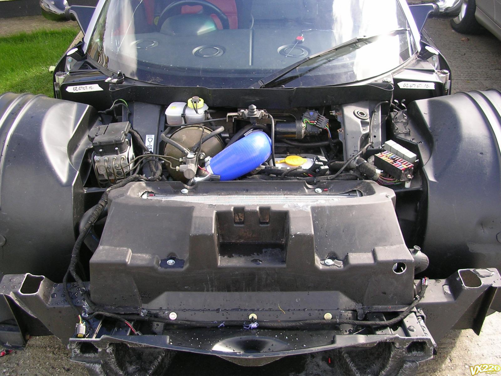

Well not been able to do much while i was waiting for a 2nd headlight, cant put it off any longer so i had to get a new one from AutoVaux today, hopefully it will be here thursday.
Car is booked in for Monday the 25th so only 7 days away from being fitted, prepped, primed and painted :happy: :happy:
still not sure what im doing about the fog lights, there are a few sets available but no mounting brackets. I'll have a chat with the spray shop tomorrow about it.
Ordered a HID lighting kit, hopefully that will arrive before they refit the clam.
The alarm has settled down now and the proximity sensor has been adjusted, seems to work very well on this car compared to others, probably due to the fiberglass pannels.
Stereo sounds flatter than in my last car too, i think im going to have to replace the rear surround with a custom one similar to the sub box i saw on here, i will probably split the box in the middle to let each driver have its own space, hopefully generating better depth.
Below is a pic of what she looks like sitting in my garden, very excited now waiting to see her finished in metallick black.

Good progress thumbsup We left the fog lights out on ours as the brackets were rotten and never used them anyway, probley use the holes as brake ducts or something :unsure: Sam.
#38 techieboy
Posted 18 October 2010 - 08:25 PM
Sam.
You'll definitely need to stick some ducting in there, if you're not fitting the fog lights. I know of one VX'er who lost his arch liner and a good chunk of the sill at high speed, due to the force of the air coming through the fog light holes, with nowhere else to go. :o

Is it me or are all the holes missing ie side indicators, mounting holes, headlamp fixings etc Also you need to align the bonnet correctly adjusting the hinge bracket as this cannot be done with the clam fitted.
Oh i never thought about that!! i will sort something out thumbsup
