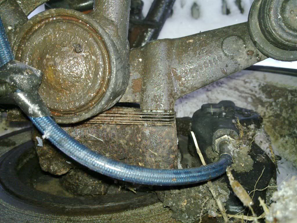

Yes there was a couple more after but still completely my fault. Should of been doing 5mph instead of 30mph on the duel carraige. Drive to the conditions and all that. Just been to look at it again. All suspension and wishbones are fine. Rear toe link has snapped at the threaded bit on the inner joint. Front upper hub carrier bolts have stetched a little. Radiator has a leak where the bonet pushed into it. Crashbox hasnt been touched at all!! Radiator housing is broken in a couple of places. Front and rear clams are totaled. Pass side sill has 2 cracks near the ear. 1 headlight is the only one of 4 left haha. Bonet has a few gouges in it. Will be written off then really. So parts required: Front clam Rear clam Toe links (will be new) Hub carrier bolts (already have) Pas side headlight Rear lights Radiator + housing. Should be drivable again pretty quick but sourcing the clams may be a bugger.

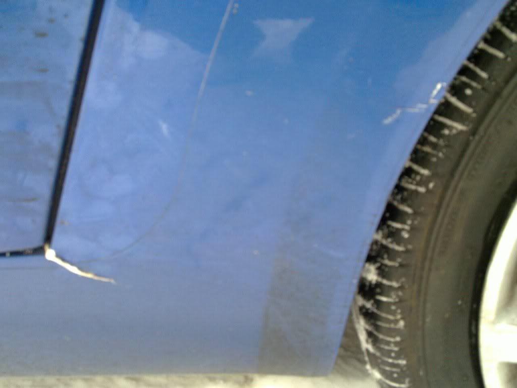

Cracks i the sill behind the rear. Easy repair?

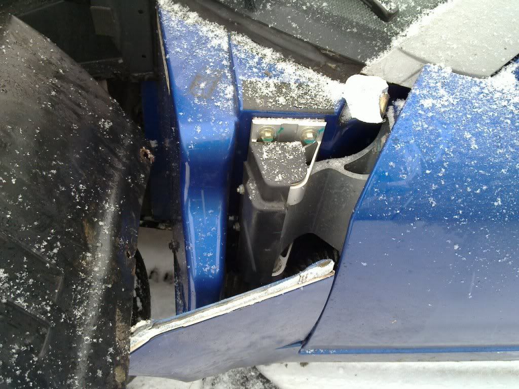

Ripped the front clam off but didnt touch the door or sill

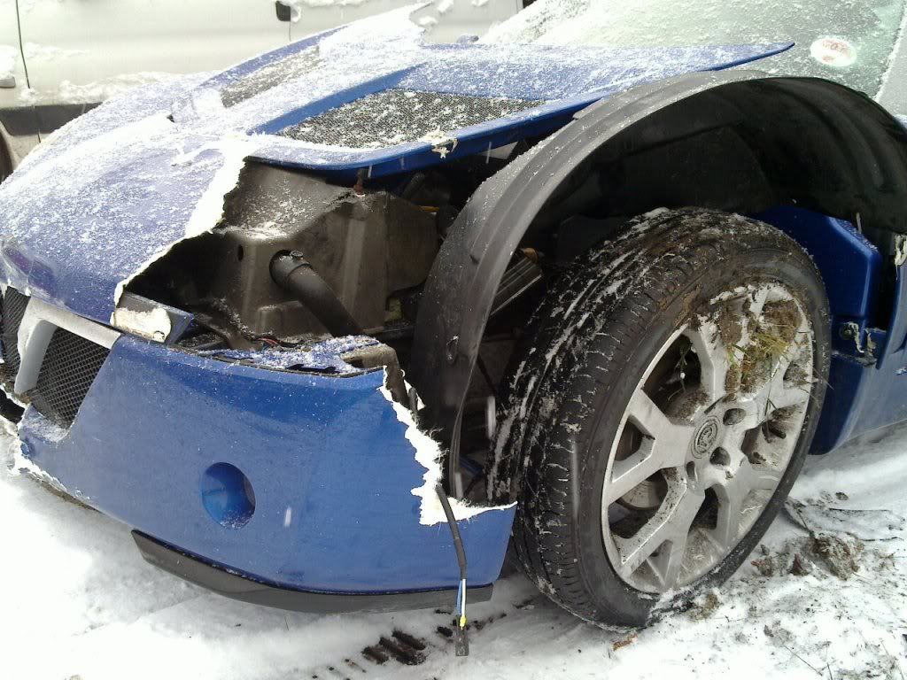

Front wheels a little muddy
As you can see the top bolts have stretched. Hopefully just a matter of replacing the bolts

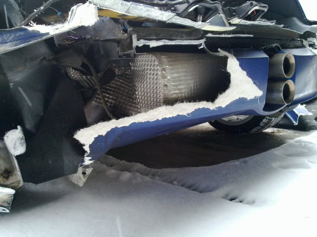

Quite a big chunk of the rear clam missing but missed the exhaust

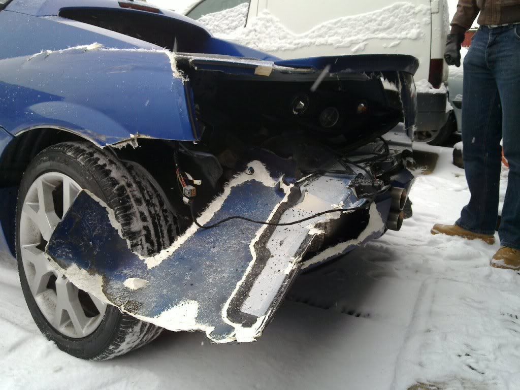

sorry again , could not help but to see man with fist clenched in photo :angry2: , hope all gets sorted with out to much fuss

Thats the guy that was the passenger. All the damage is his side haha.
