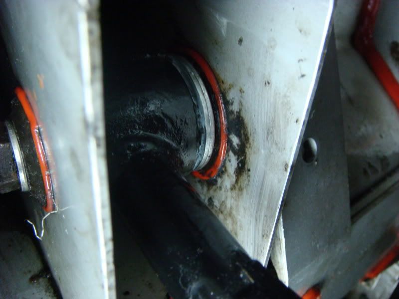

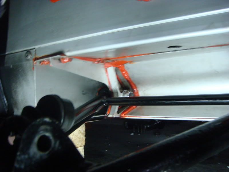

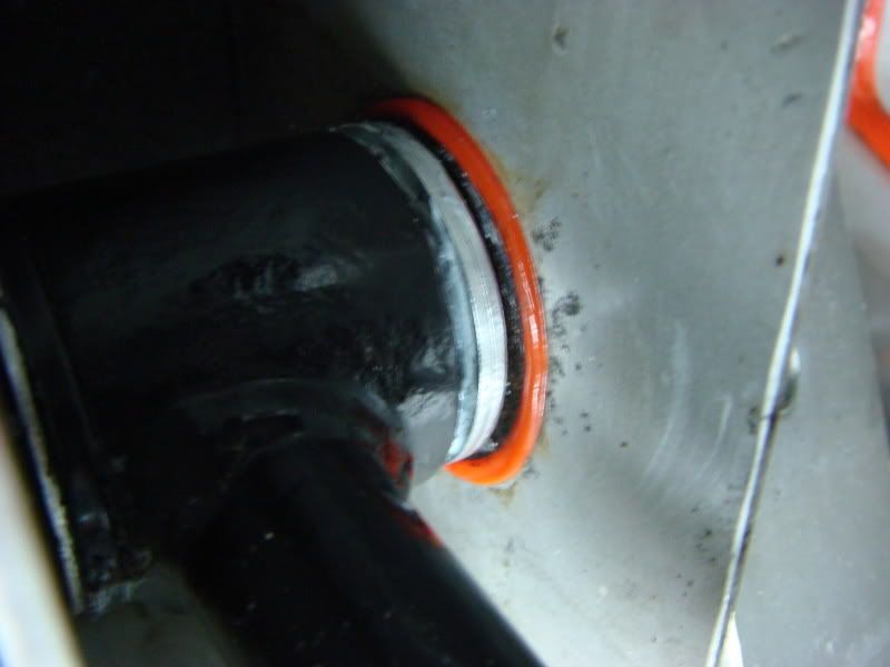

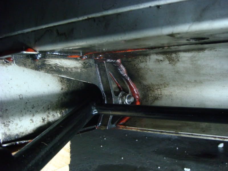

#55 robin
robin
  • 3,810 posts
Posted 28 January 2012 - 10:49 PM
Ive taken some pictures on mine ill post tommorow, i just cleaned mine so is nice and clean, and yep have a few bits of corrosion but nothing too bad.
#56 robin
robin
  • 3,810 posts
Posted 29 January 2012 - 01:07 PM
some pictures off my car
the dirt you can see stuck onto the ali next to the suspension fixing point.
then a picture of it cleaned off and you can see some corrosion on the ali where it used to be.
i cleaned this off with a small brass wire brush takes a little time but it worth it.
while at it i gave rest of ali a clean
