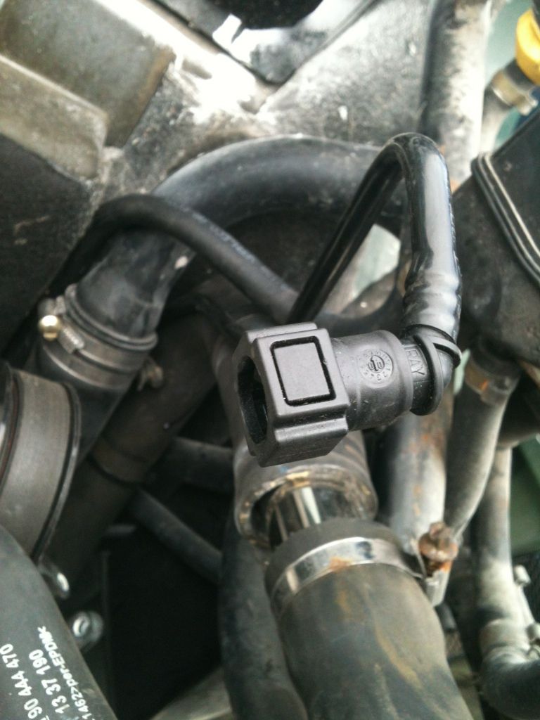

What is this?
#88 chris_uk
Posted 15 May 2013 - 03:07 PM
it goes on your throttle body or if you use a 68mm sc setup its open to atmosphere.

#89 nicollow
nicollow
  • 3,801 posts
  • Location:Edinburgh
Posted 15 May 2013 - 03:08 PM
Thats the vent pipe for the fuel tank...
#90 vocky
Posted 15 May 2013 - 03:26 PM
Batman is no were to be seen today!
What is this?
cut it off along the straight section (going downwards in your picture), then connect the chopped off end onto the 68mm TB, then join the two pipes back together with some 8mm fuel hose.
#91 Andrew aka Stuwy
Posted 15 May 2013 - 04:05 PM
sweet, thats what I thought and done that :)

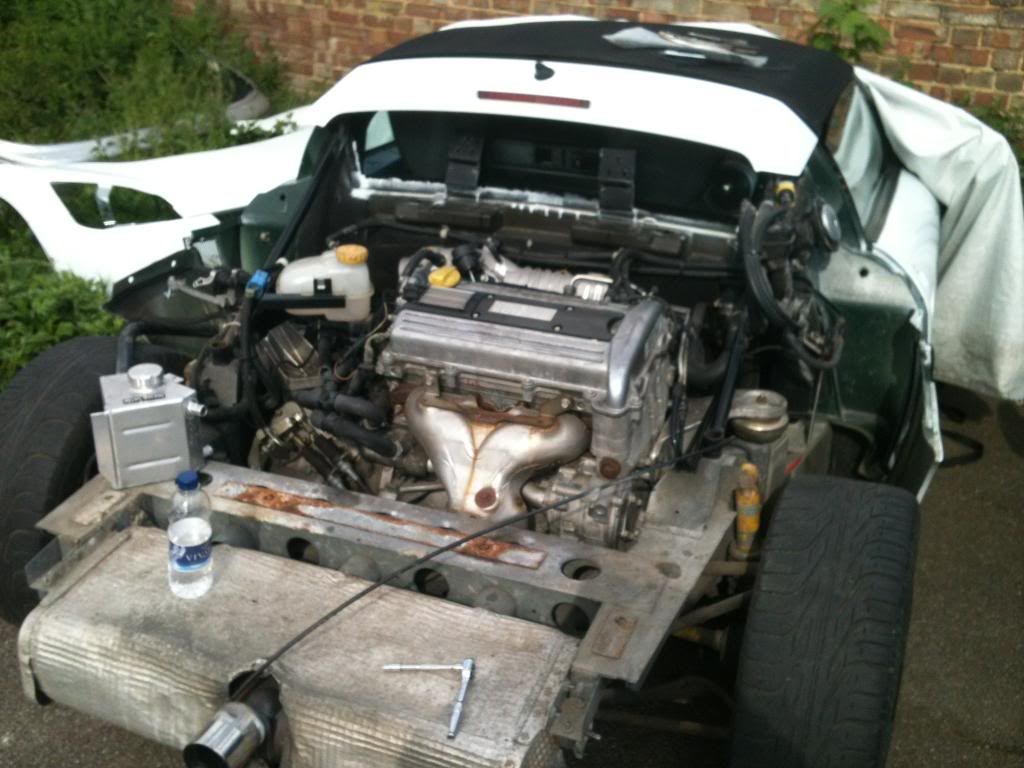

on a side note.. errr I finished... its all done (not the whole to do list) but the conversion :) If I had a drill I would have started it, but I need a drill to mount ecu and CC tank.. also I want it checked over first :D
pics to follow

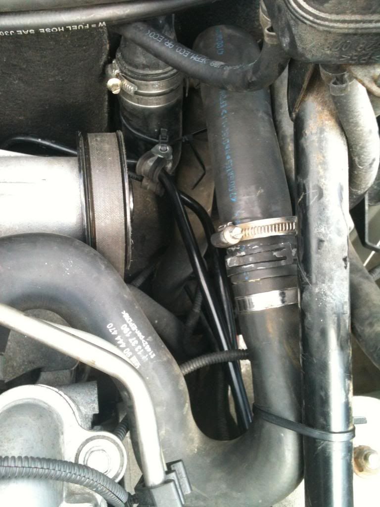

Posted 15 May 2013 - 04:25 PM
Is this ok? Nothing is touching and I re-routed a few cables and wires so there is about a inch gap

#95 CHILL Gone DUTCH
Posted 15 May 2013 - 04:30 PM
Is that where your old fuel lines ran? I was very worried where I was going to run them I ended up running mine over the alternator
#96 vocky
Posted 15 May 2013 - 04:44 PM
Is this ok?
err, NO thumbsdown
that small single cable tie is all that's stopping your car from burning to a pulp :mellow:
You need at least two heavy duty, good quality cable ties, preferably made by Tyrap (they have steel inserts to stop the cable tie from failing)

#98 vocky
Posted 15 May 2013 - 04:50 PM
I hate those fuel lines being there (on the sc conversions), the other option is to chop the fuel lines and move them over to the gearbox side :sleep:

#99 oakmere
oakmere
  • 2,143 posts
Posted 15 May 2013 - 06:27 PM
I would at least put another cable tie around as a backup. As at the moment it looks like your 1 cable tie away from a fire ball. Can you not clip them to more than one point?
#100 CHILL Gone DUTCH
Posted 15 May 2013 - 06:29 PM
I ended up putting several cable ties just in case
