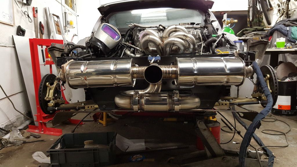

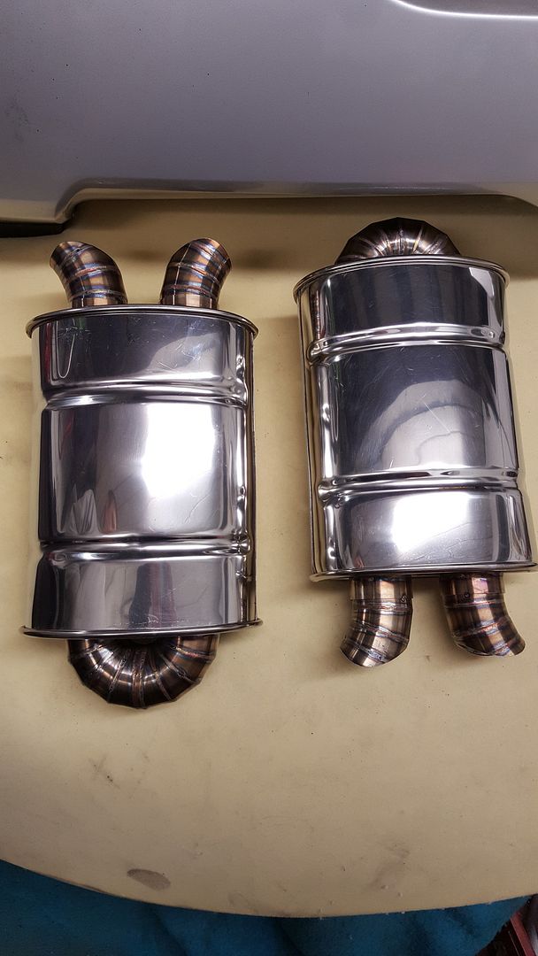

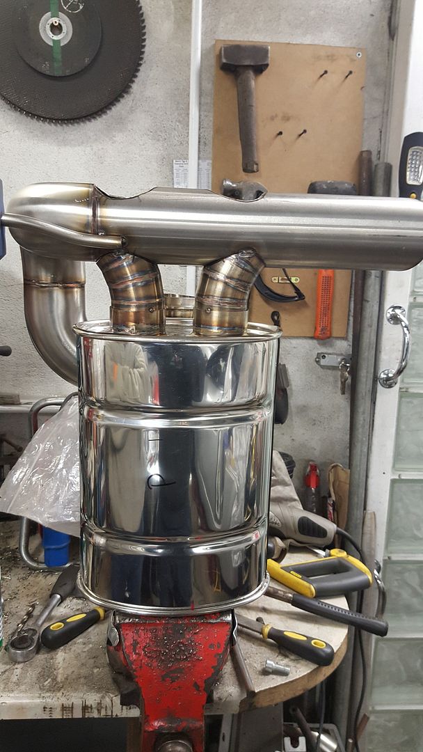

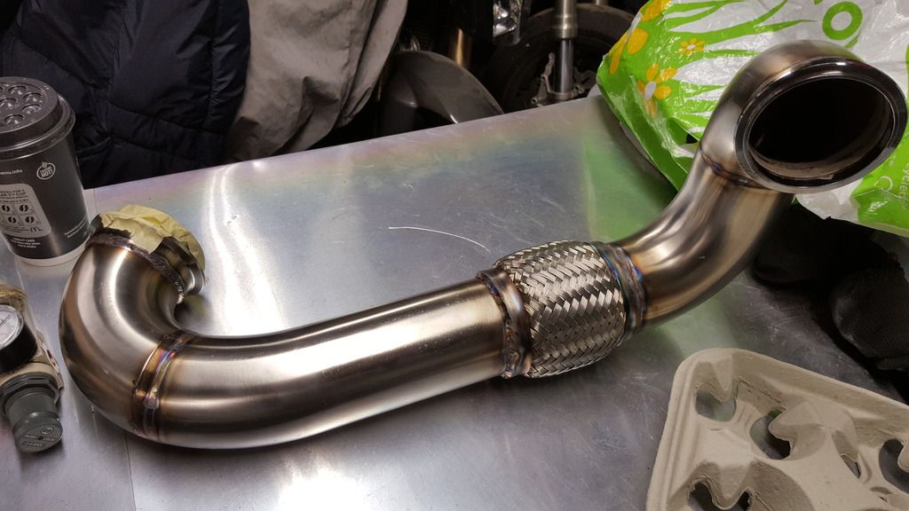

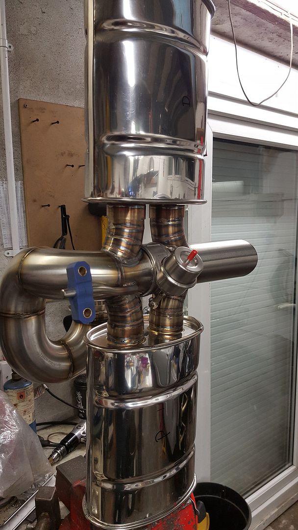

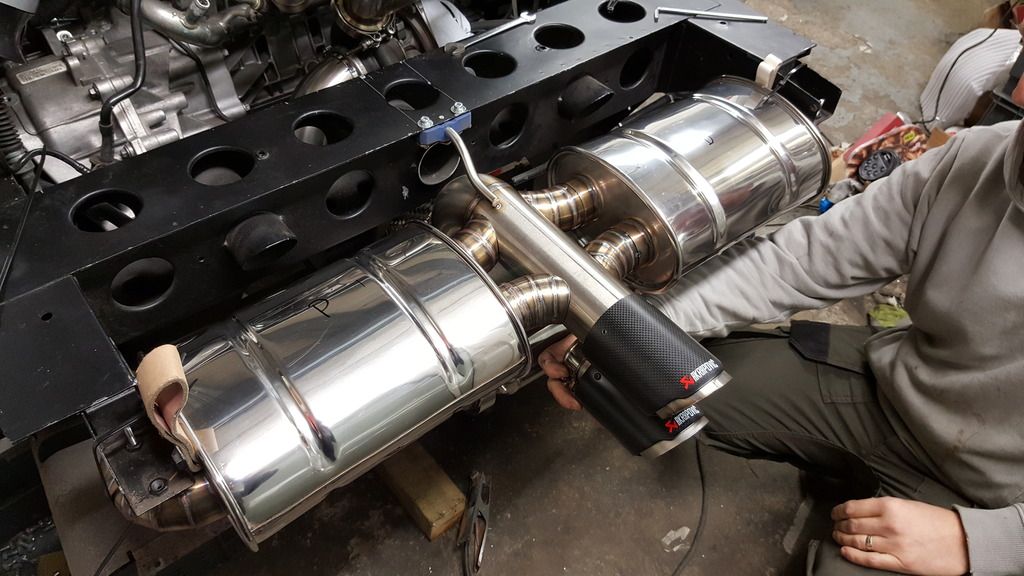

So much time has passed but still so little done :( working 6 days most weeks atm which is leaving no time spare to work on the car...i have a jumble of pics which show the work weve completed upto date.....

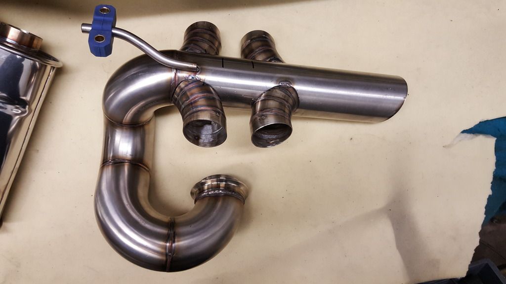

Weve had to tack the exhaust together and break it apart so many times just to get everything positioned in the rite place but were nearly there now. Just a small bit of welding to be done around the valve and the added tailpipe and it will be pretty much complete. Also just starting to finish weld the manifold.
You will notice the mounting points have been moved. This was just to make sure that we had some room around the exhaust so we wouldnt end up with any knocking etc. Heres the pics.........in no particular order because i just cant remember lol.

top work there looks a great job keep up the good work ;-)

Looking very good
#250 The Batman
Posted 29 February 2016 - 09:56 PM
That is a holy grail exhaust system! Wow just wow!

love it

That looks freakin lush! Top marks...

That's going to sound mental with the valve open! In awe of your skills.
#254 Nev
Posted 01 March 2016 - 06:24 AM
Goodness me thats a complex yet well executed exhaust. I'll be interested in how effective it is and how it sounds through the valve opening transition, as I am thinking of doing something simlar on mine.

Nipper in straight through mode... I'll get the hearing aids on order ;)
OP... amazing work :)

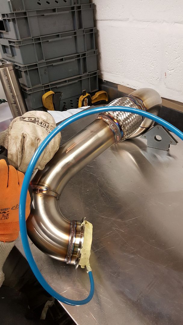

Do you find purging the air in the pipes prior to welding is worthwhile?
#258 vxt5
vxt5
  • 199 posts
  • Location:s wales
Posted 01 March 2016 - 06:48 PM
Thanks for the comments guys
It keeps the weld cooler on the back side and helps wet out the weld a lot better. Also by back purging you wont get no sugaring on the back of the weld. It uses a lot of argon but for some parts that we could reach we used solarflux to do the same job but found this only really works well when you have a tight butt joint or a lap weld. If you have the slightest of gaps it tends to pull through into the weld :/
