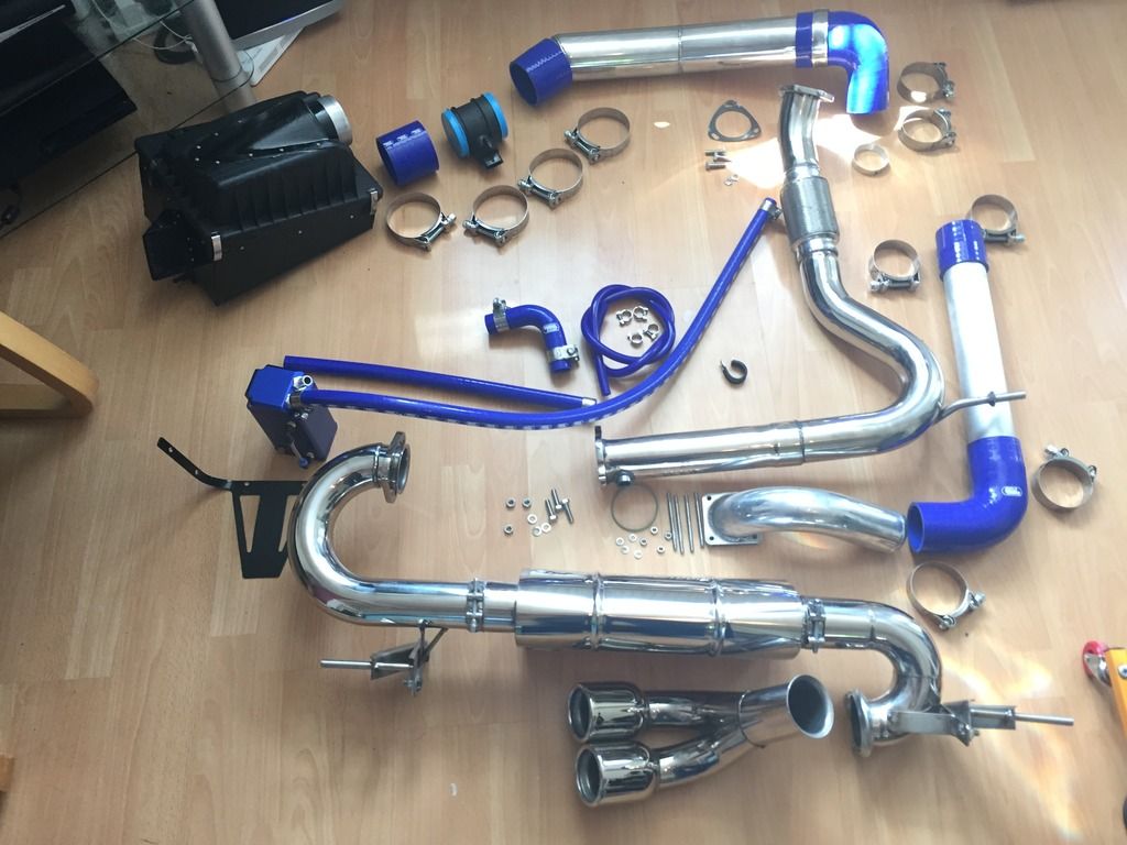

Can anyone confirm that I've been a complete donut. Fitting all the stuff to the car was a complete PITA as every stud or bolt snapped and had to be replaced. I finally got it back on the road last week and had my first proper outing today down to Bruntingthorpe. I know people say Larini systems are loud but I was pretty shocked at how loud. I've already discovered a balls up in that I forgot to order the pre cat down pipe to make it a full system. However, I'm looking at pics of the secondary sports cat I ordered and the part I've been sent and they look different. From the pic of all the bits on the floor on the last page, can someone confirm that I've been sent a secondary decat pipe as opposed to the secondary sports cat I paid good money for? I suspect this is why it's so bloody loud too. Thanks.

Pic here for convenience.
#85 Zoobeef
Posted 08 August 2015 - 07:13 PM
It looks very straight throughy!

Posted 08 August 2015 - 07:31 PM
Looks like a straight through decat pipe to me. I've never seen a larini in real life so possibly not qualified to comment.

Posted 08 August 2015 - 07:40 PM
Straight throughy pretty much sums it up. I really don't know how I didn't twig before. There's no pic of the Tubby decat on ES but my guess is that this is it.

Bit of an update.
Spent the weekend removing the decat pipe from the blue one. Have refitted the original secondary cat and the Larini backbox is now a lot more civilised. Hoping to get the sports cat and primary decat in the next few days so I can finally get it mapped to stage 2.
