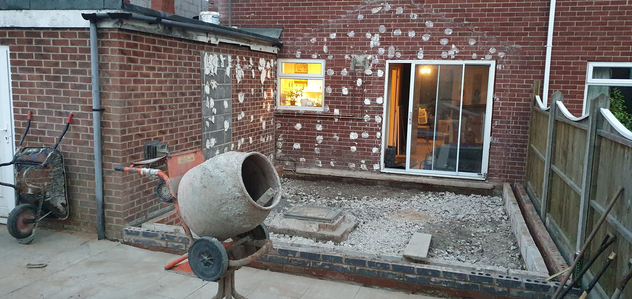

Posted 02 February 2021 - 01:13 PM
Started work last june/July I think.
Ripped down the conservatory and flogged it on Facebook. Lucky punter collected that jigsaw.
Dug the foundations, had to Jack hammered through 8 inches of concrete and block paving to get to them.
Rain water pipe on the right got moved (after a small discussion with the old woman next door) to her side of the fence. Its a shared drain and it meant we could build closer to the fence.
If she said no I would have pointed out to her that the fence is actually on my land and to move it, so would have gained the space anyway.

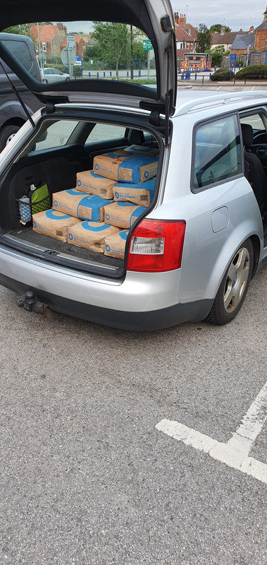

20 bags of cement fit perfectly fine in the Audi (500kg, although I've trumped that with tiles more recently). I think I've bought about 80 bags now.
Building inspector turned up and looked at the foundations and said they were fine so I started borrowing cement after mixing. All 5t of it.
I think it would have been more efficient to go do some overtime at work and just get a big cement mixer to pour it. But its done now.

Cut back the fascia on the single storey to find the bricks didnt go higher than the bottom of the fascias, so an extra 3 courses we didn't know we'd need.
Got the blockwork started though.
Rear extension was taken up to damp proof.
For some reason the gas pipe came out the garage teed off into the house to feed the hob and then went back into the garage. The hob is actually adjacent to the garage wall so I cut it back, drilled into the house and sent it directly through.

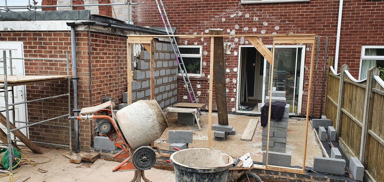

Hired a couple of brickies for the day (I think they did 3.5 days in the end)
They build houses every single day and the brickwork would be on show so made sense.
I'd loaded up and was supplying them with tea and gobbo.
They didn't use it as fast as I could make it though so got the bifolds mocked up and started the blockwork downstairs.

It was at this point the mrs dad broke his ribs after slipping over next doors fountain doing the brickwork on the right hand side of where the conservatory was.
So I was on my own for a week, old woman was being a doodah saying I had to get another builder in if he was injured. Didnt happen.
So I continued the blockwork on my own. Got some sheet steel and extended the boiler flue and built round it so I didnt have to remove the whole boiler yet and be left with no heating or hot water.
Also got the blockwork done on  the other side.

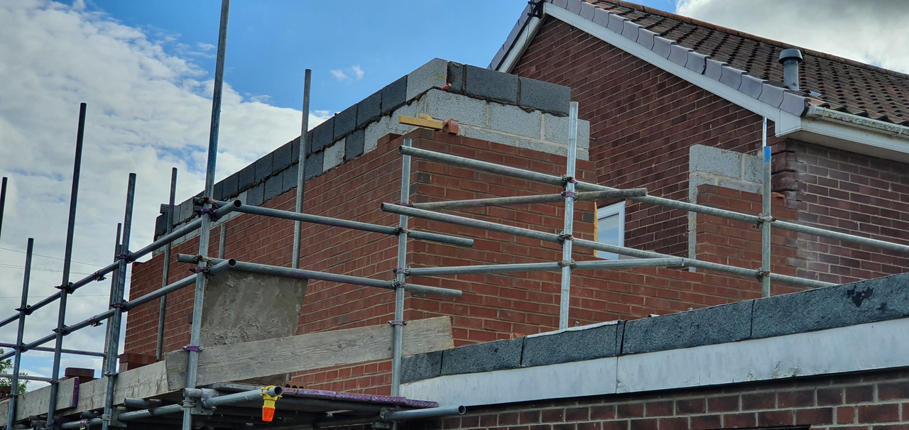

Posted 02 February 2021 - 02:11 PM
Brickies came for the second day and got up to the point of needed a second lift on the scaffold.
On my own supporting them so barrowing sand round, mixing, taking it up, restocking bricks on the scaffolding had me pretty tired.
Also the mixer went down early morning. The fan had melted and the motor overheated. Cooled the motor and then bonded the fan back on and ran it without the finger guard. Its been great since.
Scaffolders turned up and put the second lift on.

Posted 02 February 2021 - 02:17 PM
The issue was they put the scaffolding inside the rear extension to no put any weight on the roof so it meant I couldn't do the rear roof until the side scaffolding came down.
Got a company out to measure for the main roof trusses so they could be in the pipeline.
Old woman was being a pain in the dick saying the rain was going to damage her fence panels if they weren't slotted between the posts. So we cracked on with that, building both skins of the wall at the same time.
Took out and bricked up the rear exit out the garage, it was behind some shelving so I never used it. Just did it in breeze as it'll be rendered at some point.
