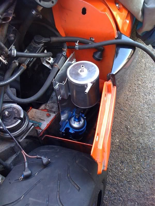

Also it will go
tank pump -> swirl pot -> high pressure pump -> rail/reg -> return to swirl pot. the Swirl pot will take its highest outlet to the tank return.
So the pot should have 4 connections to it. atleast one low one and then atleast 2 high ones and the other, well that isnt mega fussy where that is :lol:
this is the diagram i have been following:
personally I'd swap the returns over... as once the pot is "full" to the rail return level its going to make things a little harder to get the return fuel into the pot (only marginal but its best to play things safe)

decided to have a play today and designed a better bracket for the fuel pump
#306 vocky
Posted 26 September 2009 - 06:16 PM
looking good Joe, much better feed to the pump thumbsup

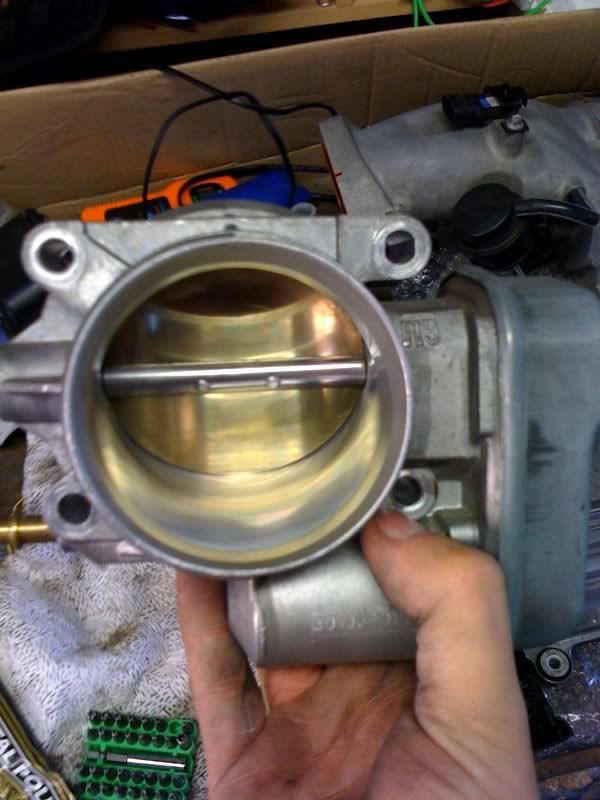

got a bit bored this weekend so thought i would polish the cam cover, supercharger and tb
heres a picture of the cam cover :D
heres a picture of the tb:
apparently it is a bad idea to port the supercharger and the tb so just thought i would tidy them up a bit :)

yes it has the dual pass mod thumbsup also the fuel rail return goes to the top of the swirl pot and the fuel tank return goes to the upper side take off.
