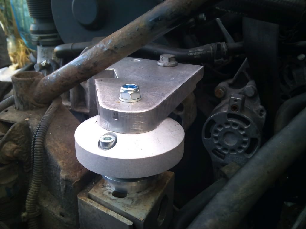

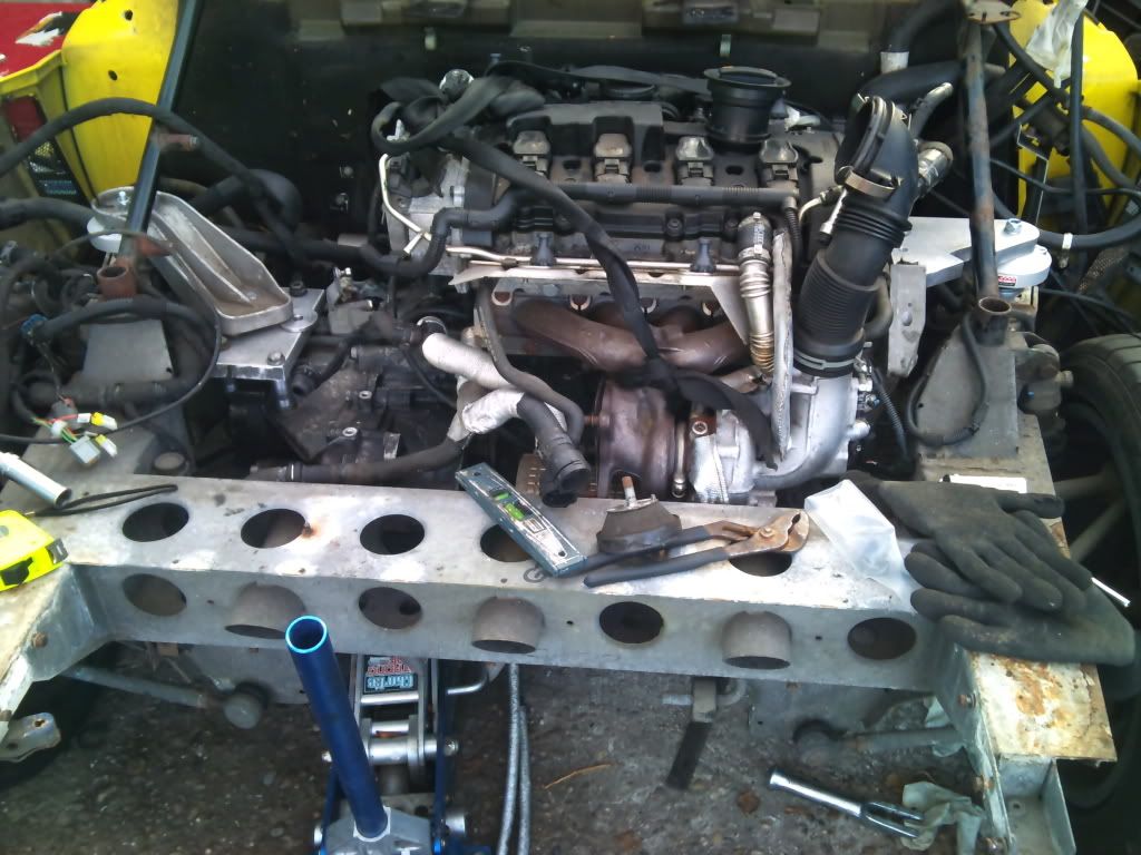

Posted 09 February 2012 - 03:31 PM
Ok thought I would share a small update / well a picture lol :)
Well as per previous update this is version 3 top engine side mount bracket after my OCD took over and made 2 revisions to the engine location lol
Will get a pic of it fitted but seems the extra few hrs of triple checking and measuring means it fits like a glove......never doubted my drawing for a second lol
Hoping the weather eases off this weekend to do more and hopefully drop zacs car off to the RR
DG
Not this is done I can triple check the box mount which it a bit less wrok and finish the bottom bracket which needs to have the others finished 1st

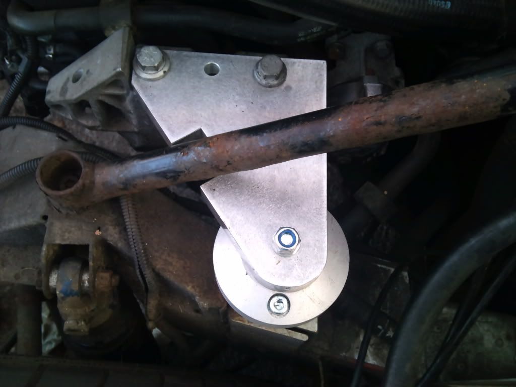

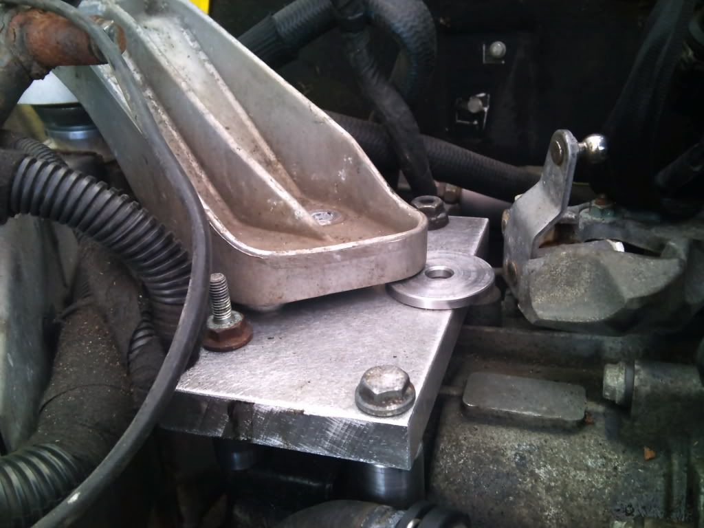

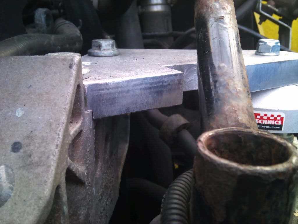

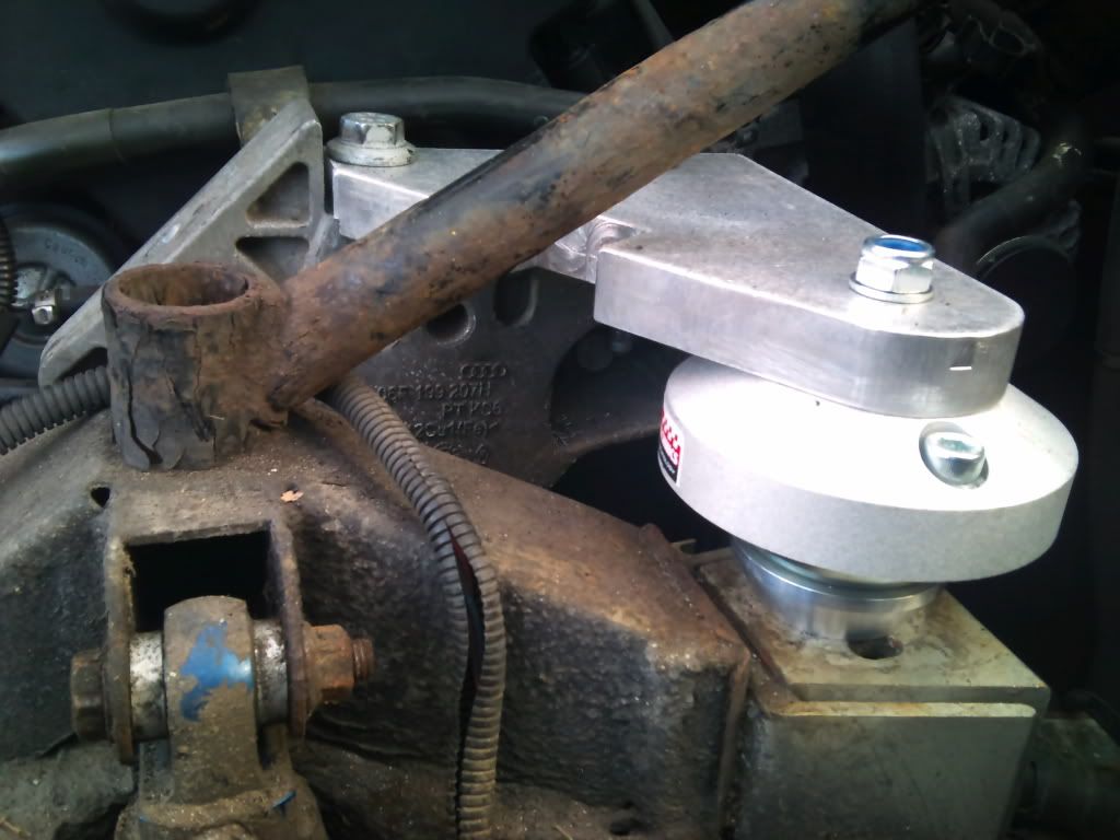

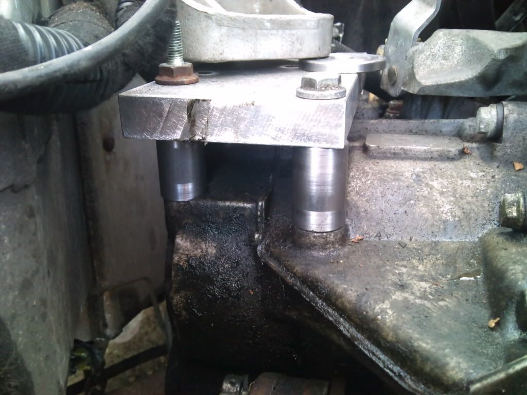

Posted 13 February 2012 - 09:25 AM
Some more pictures
Drivers side top mount had further work to counter sink the bolt not shown in picture and the gearbox adaptor plate has been drilled, tapped and the spacers redone with added 5mm as required to make the spirit level happy :)
Will get some of the finished pics up this week as it was late when fitted last night and too clold to get camera out lol
So finish bottom mount this week and can get started with driveshafts
DG
#115 Duncan VXR
Duncan VXR
  • 5,284 posts
  • Location:Lincolnshire
Posted 13 February 2012 - 09:27 AM
Oh and machined a section of the plate off to clear the gearshift mech ;)

  • 13,615 posts
Posted 13 February 2012 - 09:51 AM

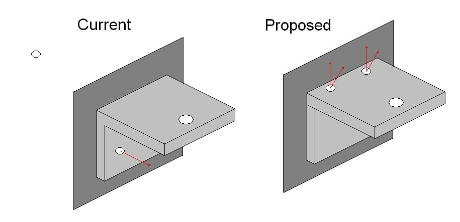

DG
The sheer on those two bolts looks pretty unkind? I think i'd want some form of triangulation, or at least some form of mounting in the horizontal plane rather than the vertical.
Great project though. thumbsup

Posted 13 February 2012 - 10:07 AM
I had been reviewing this myself JG when I made it from billet alloy over the steel option - the billet alloy is 20mm thick and have ran it past a good friend (engineering bod) who stated as it was not solid mounted it should be fine but would not be a great pain to beef it up if required so will get him round to actually have a proper look for me :) DG

#118 fezzasus
  • 7,689 posts
Posted 13 February 2012 - 10:30 AM
The stresses on the bolts in that mounting arrangement shouldn't be much different to the original mounting approach. DG: I still want a set of those mounts

#120 JG
  • 13,615 posts
Posted 13 February 2012 - 11:03 AM
Yes it is, its completely different.
On the standard engine,. the mounting is bolted on the engine on the horizontal plane. so the bolts are stressed along their length (which is what they are designed to do). on the above configuration there is now a sheer stress across the bolt, which they don't like at all. On the standard arrangement you also benifit from having a greater surface contact area which helps.
I can work out the stresses and strains if i had a few measurements, the rough weight of the engine, and the relative locations of the mounts to COG. Big enough bolts may take it, its just not very good practice imo. This might illustrate it better.
