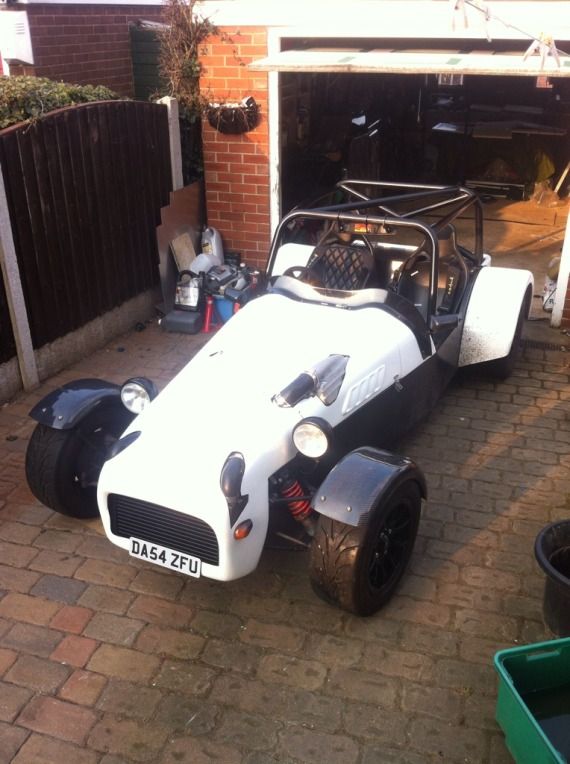

thanks, and no because it looks like this other wise you welcome to take it out sometime!
