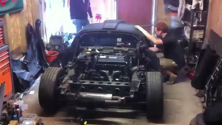

Then begins the lead up to a momentous occasion......
Oil in. At this point, no water / coolant or brake / clutch fluid and i wanted to check the engine was going to work.
After a check and clean of the spark plugs, a lot of rolling back and forth to prime the engine......i re-connected the new battery.......
1st success....the interior light works. Phew.
Also my Clifford Alarm proved that not even a couple of years dormant could quieten down the howl of the the noise when it goes off!!

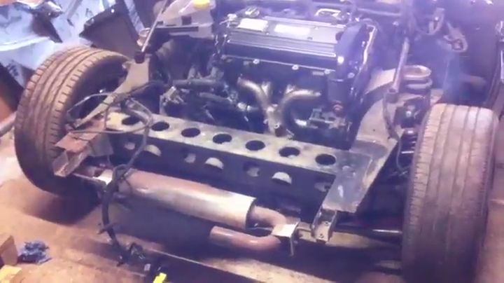

A Click of the key.......the dash lit up.......The fuel pump primed.....and the engine clicked.........The Time had come........
<embed width="600" height="361" type="application/x-shockwave-flash" allowFullscreen="true" allowNetworking="all" wmode="transparent" src="" flashvars="file=http%3A%2F%2Fvid1336.photobucket.com%2Falbums%2Fo653%2Fgingerjon1383%2FVID-20130914-WA0002_zpsdf7f8aa3.mp4">
Undetered and already smiling that she was at least trying to come back to life.....a check of various connections and tighten up of the battery terminals...
Then, time to press the button again......
<embed width="600" height="361" type="application/x-shockwave-flash" allowFullscreen="true" allowNetworking="all" wmode="transparent" src="" flashvars="file=http%3A%2F%2Fvid1336.photobucket.com%2Falbums%2Fo653%2Fgingerjon1383%2FVID-20130914-WA0001_zps4fb7ba52.mp4">
SHE LIIIIIIIIIIIIIIIIIIIIIIIIIIIIIIIIIIIIIIVES!!!!
After 2 years and a heart transplant she fired up 1st time!!!
Obvioulsy i didn't run it long with no coolant inside but i was almost overcome! :blush:  :wub:  :wub:  :wub:
Not wishing to tempt fate, i left it there this weekend. I have the water system to bleed and the brake and clutch system to follow, tighten up all the lambda sensors and exhaust connections (That'll be the real test to see if i did actually put it all together properly)...... :tumble: Then, i may even try and select a gear and press the right pedal.....
2 looooooooooong years, a fair bit of money and hell of a lot of learning (Insert massive help from forum here) and the first major hurdle has been cleared. There is a long way to go, but christ......today was tense!!!!!
Bring on next summer! rallly
Jon
Edited by gingerjon, 14 September 2013 - 03:03 PM.

Works of you follow the link to photobucket. Sounds like it has no exhaust on. Well done getting it this far. Shame you're going to have to wait until next summer to enjoy it. After all the work the wait over winter is going to be tough.
