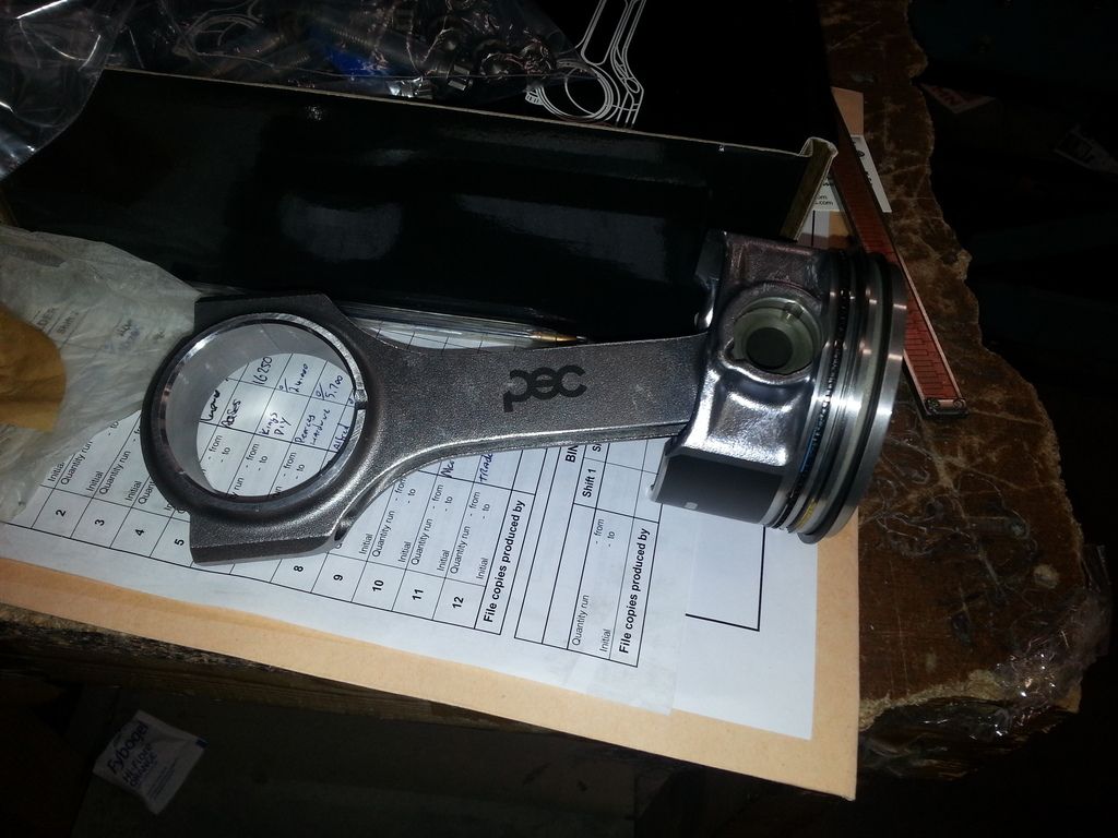

No updates atm. Been way too busy in work for the last two months but will be getting on with it within the next couple of weeks hopefully..... i have bought some new goodies to go with the build so il just give you a teaser of whats to come :)

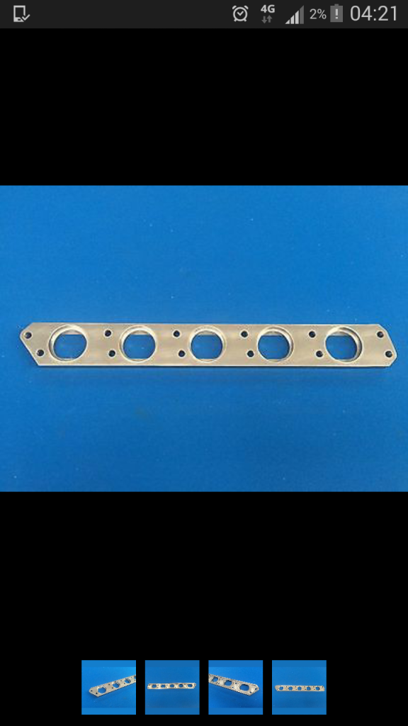

New flange for tubular manifold to be fabricated next..

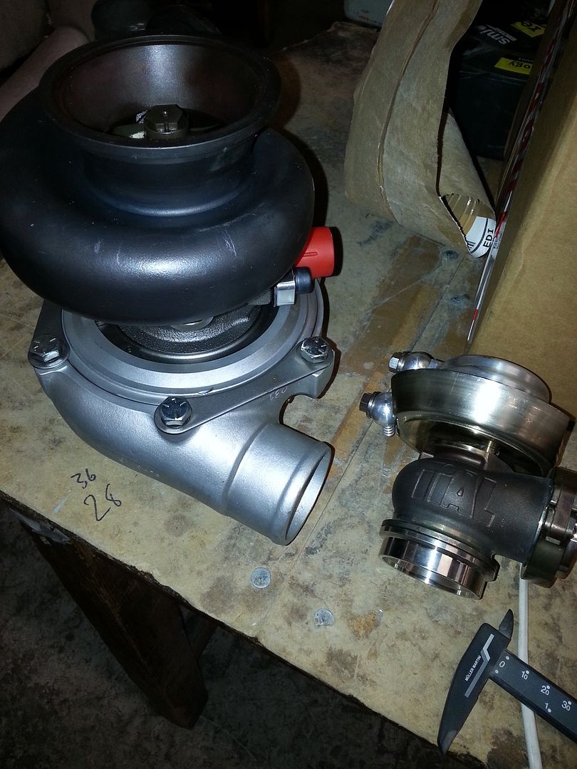

gt3071r with tial turbine housing and tial wastegate..

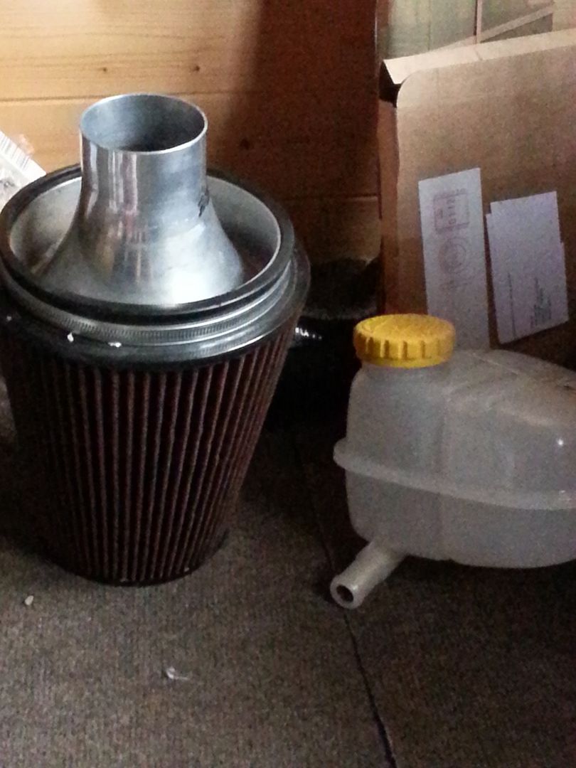

group A air filter and new expansion tank

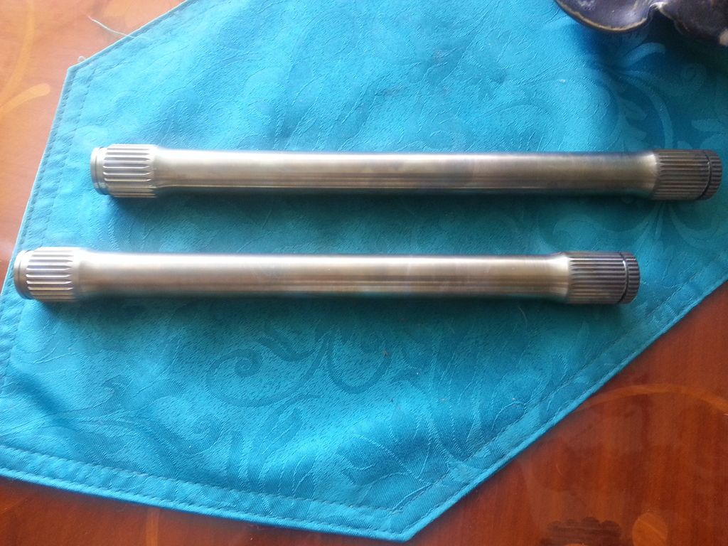

ive had my driveshafts made up :)

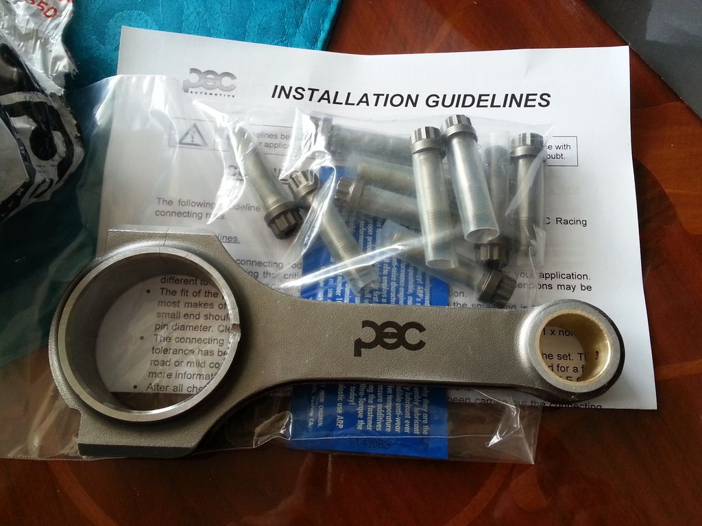

lasty ive got some PEC rods and rs mk2 pistons.
sadly i think the pistons will be the limiting factor on this build at the moment as they will be maxed out at around 440bhp, although im sure this will be more than enough power and the torque should be quite impressive.
cant wait to get back down the garage and get my hands dirty again :)

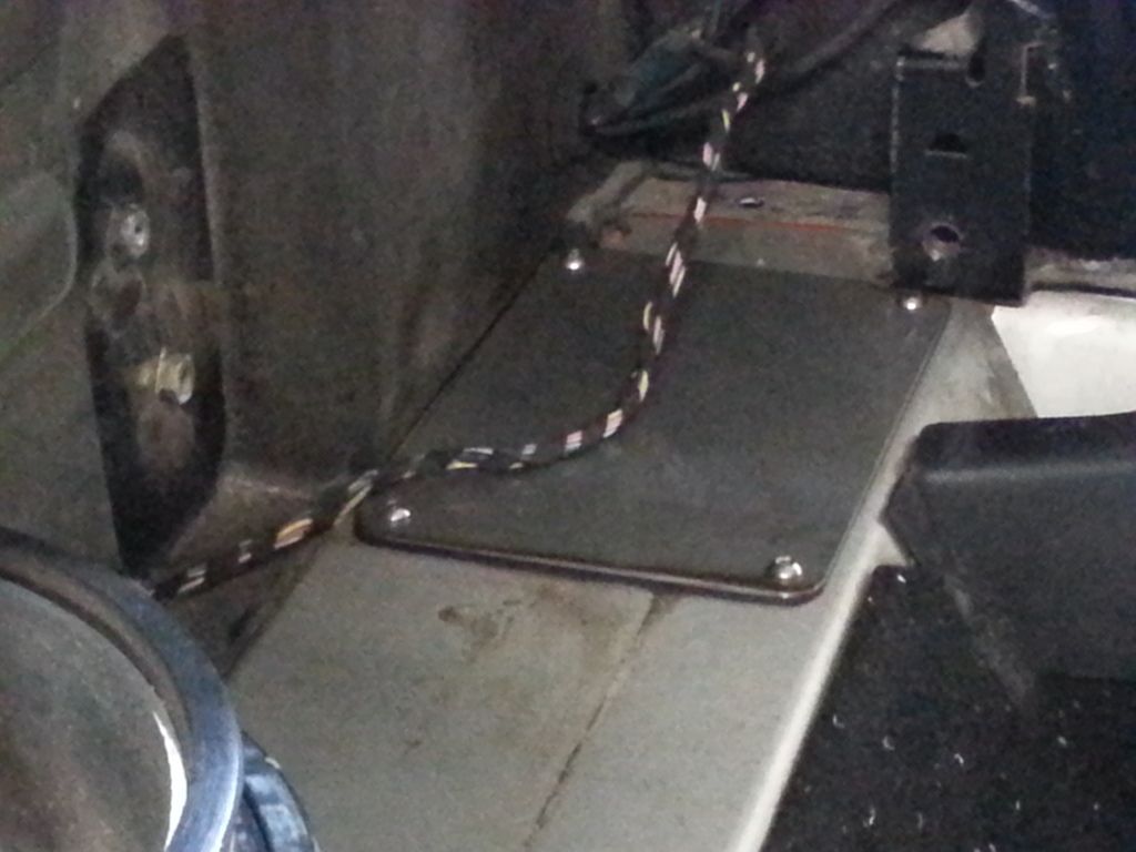

First thing i decided to do was the cover for the access hole to the in tank fuel pump. Just a simple piece of 1.6mm ss plate cut to size and new mounting hole locations drilled. Rivnuts put in and some m6 bolts to hold it in position.
I made a simple gasket from some nitrile i purchased to use elsewhere just to keep any nasty fumes entering the cabin.

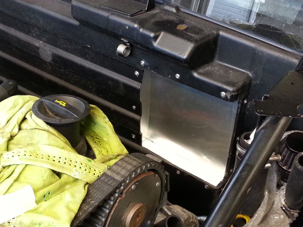

next up was the hole i cut in the bulkhead for the throttle intake pipe. I planned all along to have a go at repairing this in fiberglass but while i was there and cracking on with things, i decided to use what i had to hand. I quickly drew out a template and cut out some aluminium printers plate id previously aquired from work. Riveted it into position and bonded and sealed it with some p.u sealant . Heres the outcome.
not exactly pretty but its functional and should look fine once ive given it a lick of black paint to blend in with the rest of the bulkhead.

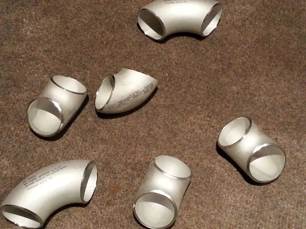

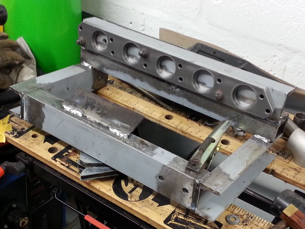

The whole exhaust fabrication has been holding us up for some time now aswel as me changing my mind on many things such as the turbo and manifold etc. Now ive decied what i want weve started to seriously put our ideas into action after taking many measurements. Weve made the jig for the manifold. Just waiting for my tial flange to come back so we can make the collector and then put together the tubular manifold. Thats where these beauties come into play....
obviously thers a lot more where they came from.
Heres the jig all finished with manifold flange mounted.

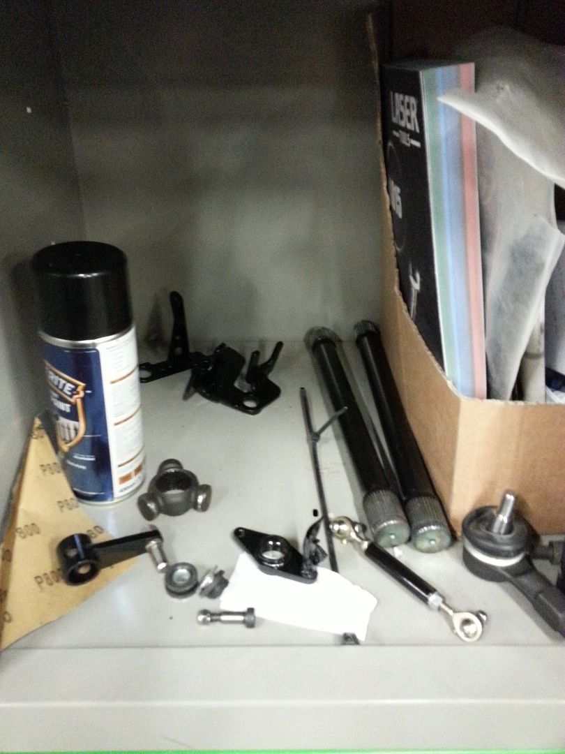

painted some more parts like my driveshafts and gear linkage etc ready to go on the car.

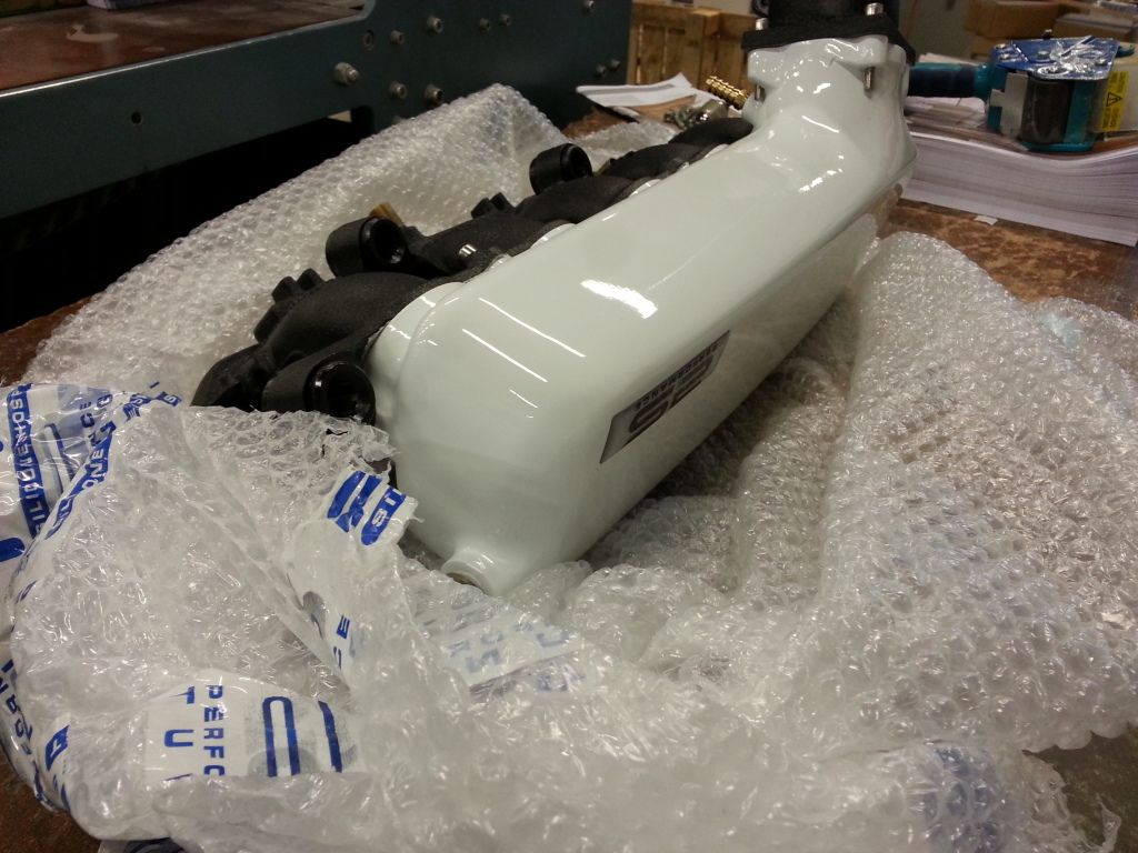

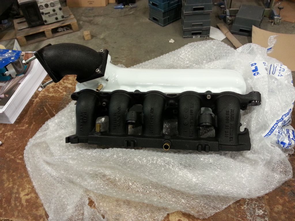

and finally ive got my inlet plenum and painted the lower manifold and intake pipe...
thats it for now hopefully will have more for you on the exhaust fabrication next time :)
