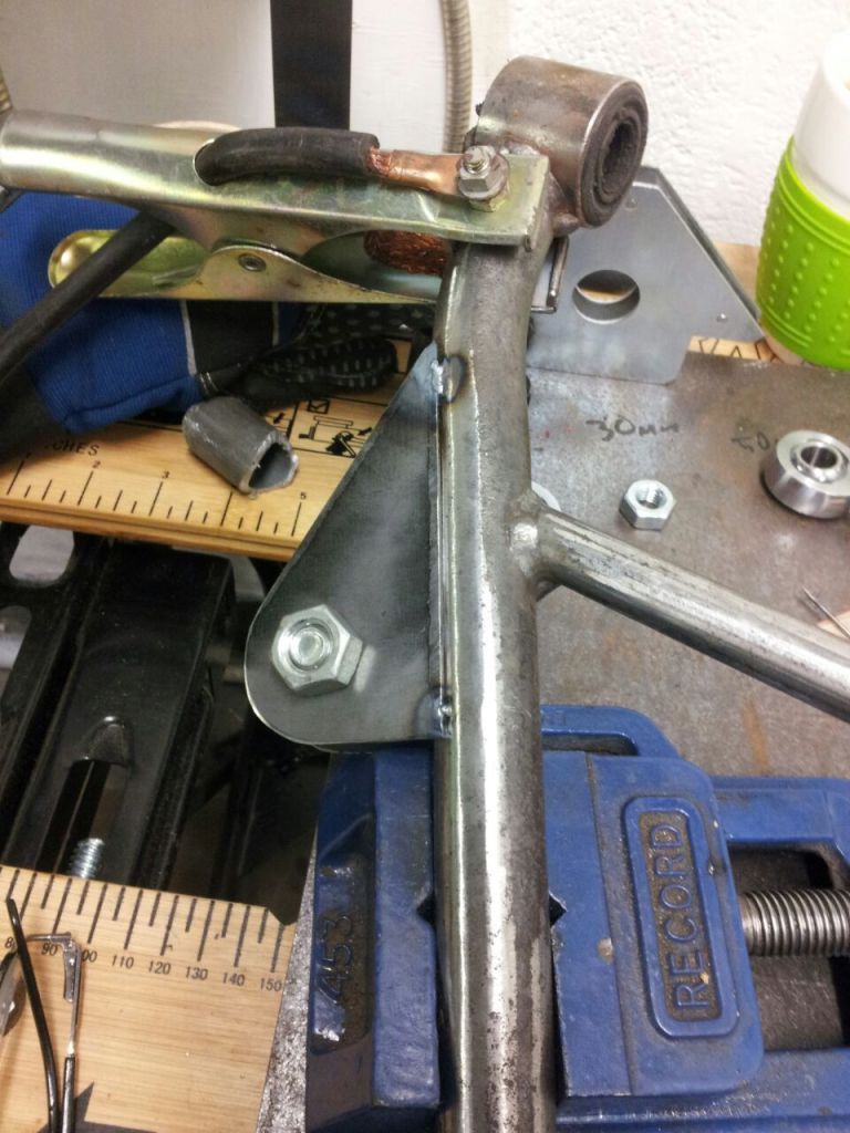

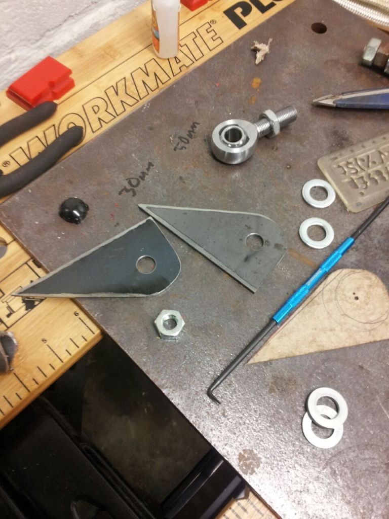

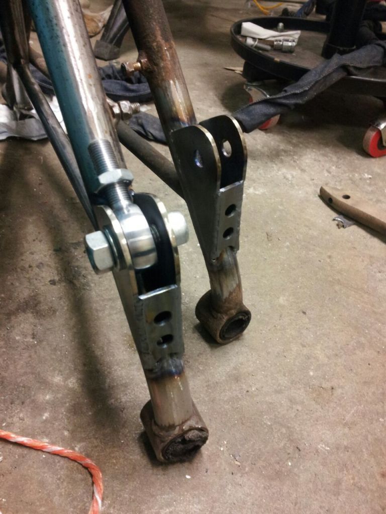

We repaired the subframe legs and added a little strength by cutting new circle tabs, welding them in place onto a piece of 3mm plate and then welding this in place on the leg, this way we wernt welding the small tab in place ontol the already damaged area of the leg and the plate would spread the load out over the area bit better. These plates may also be base plates for a bracing bar between each leg which we may make removable...
You can see the new plates either side here in thismore recent picture..

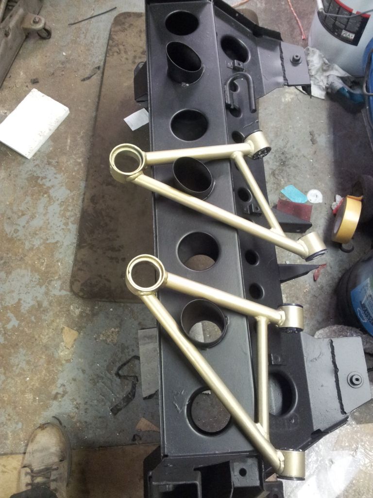

Due to this we decided to change the control arm mounting points and have relocated them to the lower arms. The inner side of the controle arms will now be attached using a rose joint on the new mounting points. Hopefully this will also make the control arms stronger as they will be much shorter. We havent yet made these but well do this once we put the rear end back together. Heres some pics of the lower arms being put together they still need to be cleaned up and given a lick of paint Posted Image

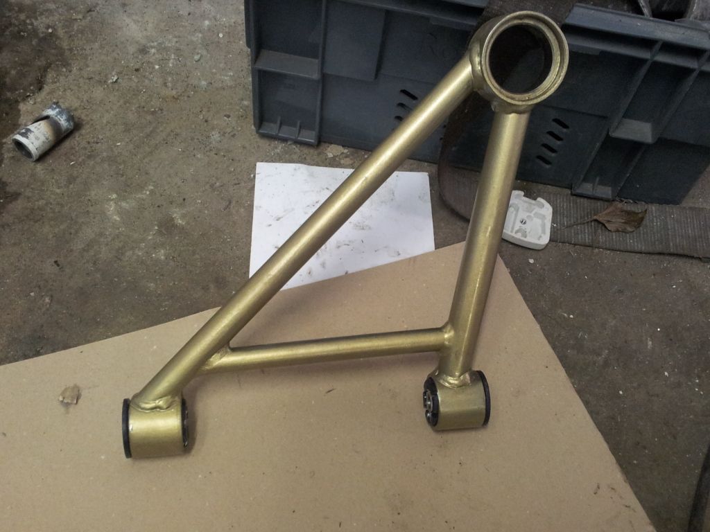

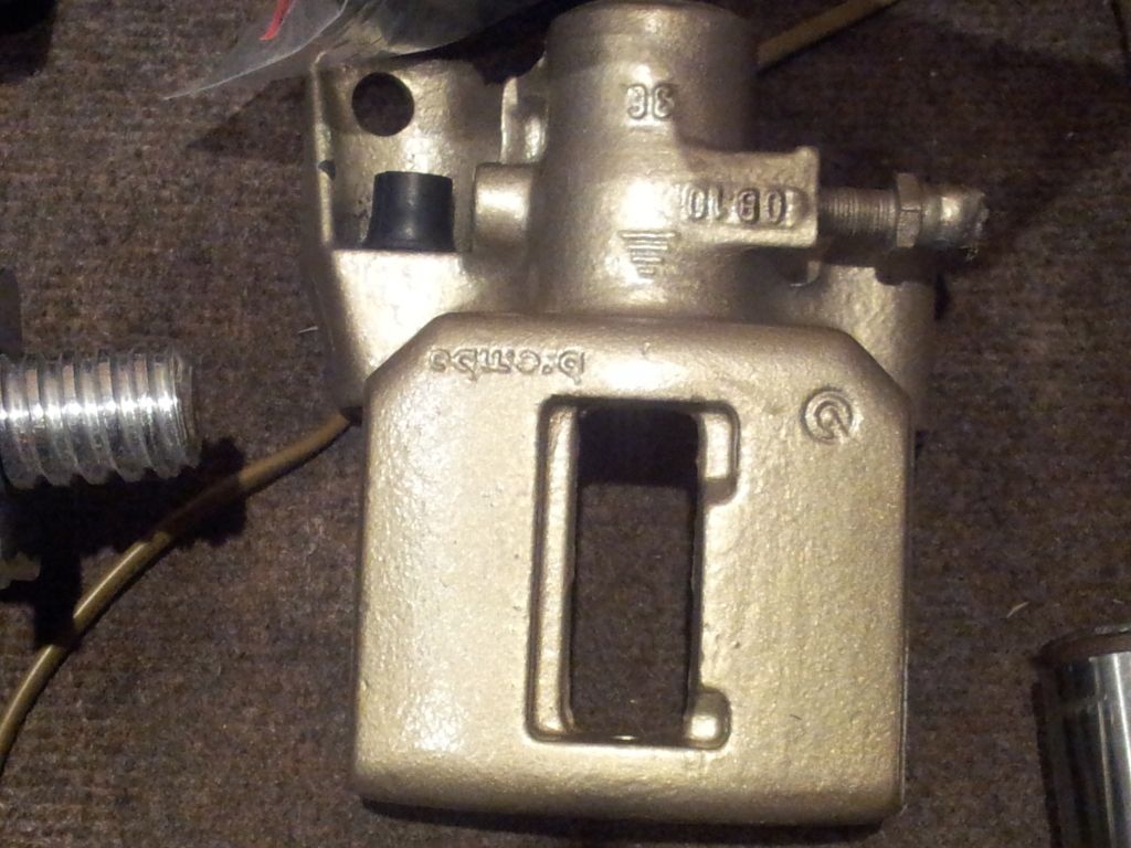

More recently ive given my upper arms a clean up and a lick of paint. Ive also poly bushed them and finished painting the subframe. The arms could do with a quick touch up before reassemble of the rear end as I marked them fitting the bushes and I am yet to fit the ball joints.
Ive also been giving my rear brakes a clean up as a background project at home. What a pita!!!
