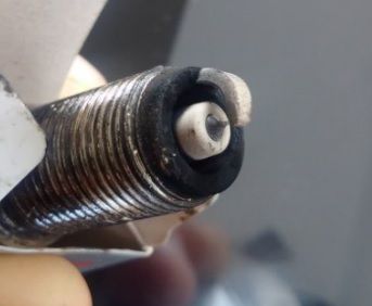

That was my first thought, however I have replaced the map sensor with a spare from Martin and didn't make any difference at all, wires all buzzed out to ecu OK as well. Chill could I email a photo to you as I haven't got my head around posting pics up yet? Pm me your email please. Plug looks as expected to me but would be good for more experienced eyes to look at it. Thanks

pm sent but you need to photo all of them to see if its only one cylinder or all 4

They all look the same, will email in a minute. Thanks

Thanks for doing that, any thoughts?

ccan you take apic so we can see the gap
