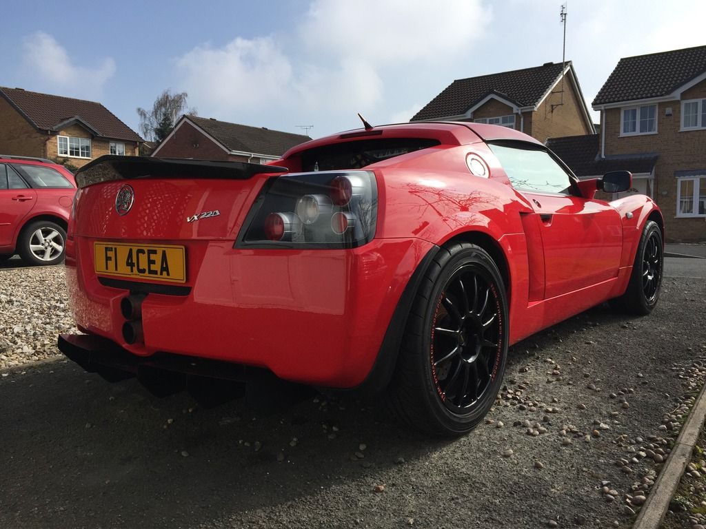

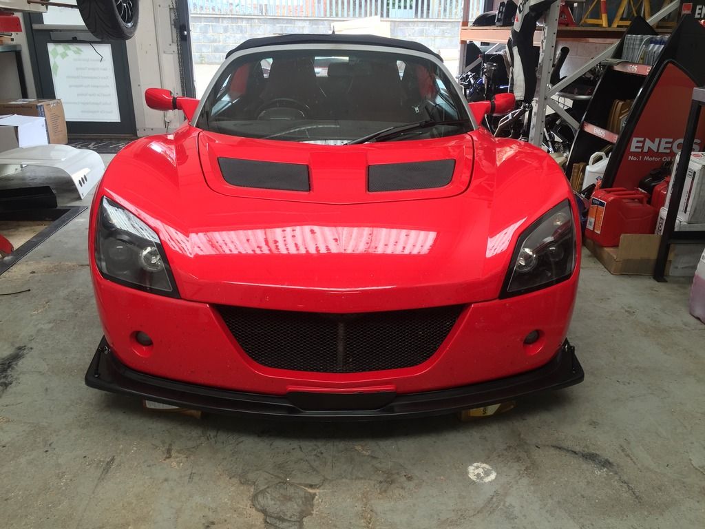

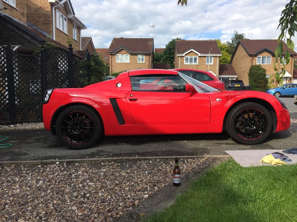

#308 ChrisS1
Posted 19 August 2016 - 06:58 AM
Any photos of the actual car?
Please tell me it looks completely standard from the outside
#309 1cobrav8
1cobrav8
    Joe is faster than me
  • 516 posts
  • Location:Market harborough
Posted 19 August 2016 - 07:24 AM
Posted ImagePosted Image
#310 1cobrav8
1cobrav8
  • 516 posts
Posted 19 August 2016 - 07:28 AM
That's how it pretty much sits at the moment, planned things.... Coupe conversion Turbo ears Rotor wheels Big brakes Rear wing New bottom end Diff There the big jobs next on the list

#318 Jocke_D
Jocke_D
  • 407 posts
  • Location:Örebro, Sweden
Posted 19 August 2016 - 11:25 AM
Is that small rear wing a normal turbo one ? It looks a bit different. Maybe I'm fooled by the angle the picture was taken in?
#319 smiley
Posted 19 August 2016 - 11:35 AM
No, that's an eltech Italy extended version.

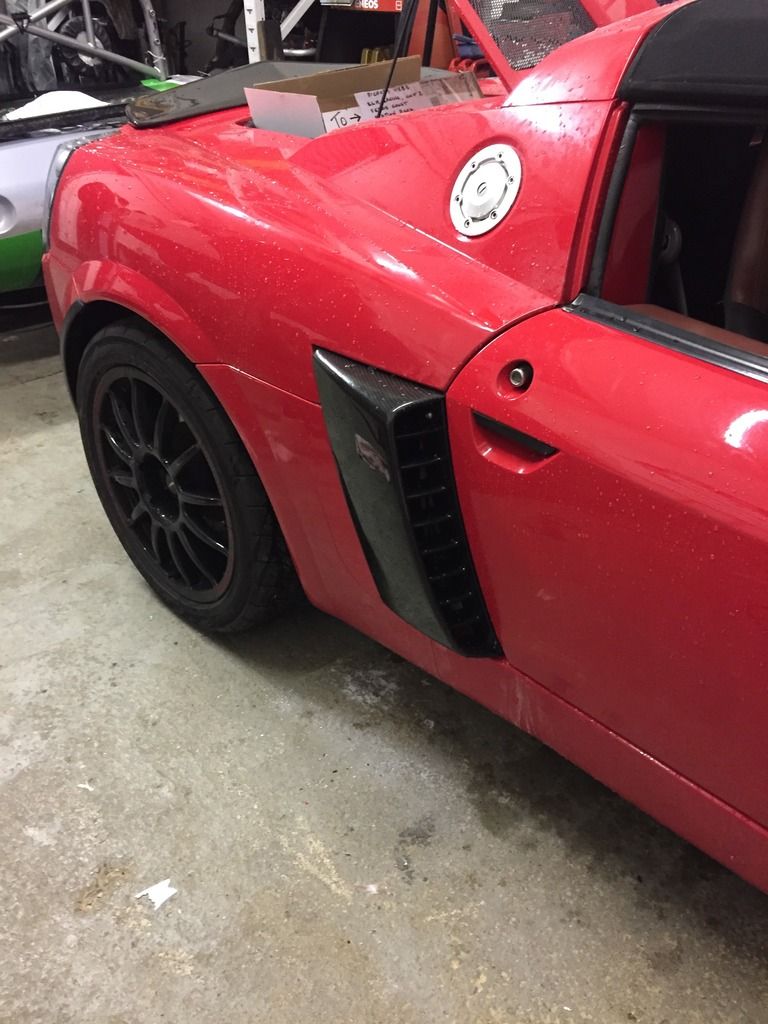

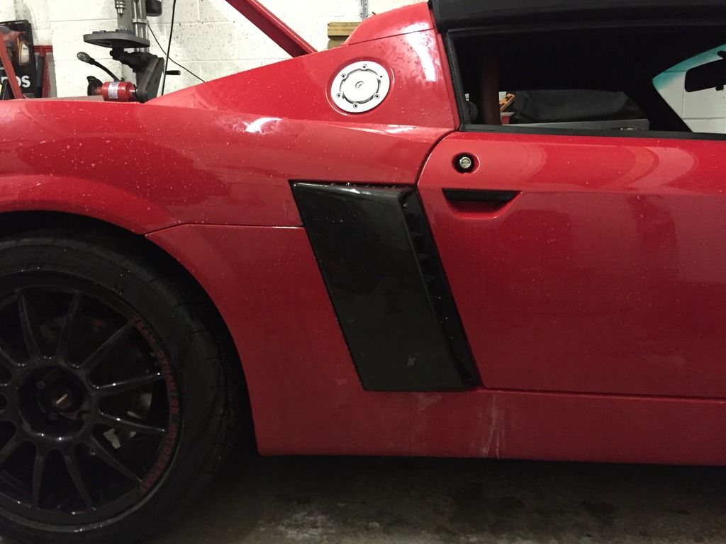

#320 1cobrav8
1cobrav8
  • 516 posts
Posted 19 August 2016 - 09:28 PM
Got the first vent fitted tonight, wasn't keen on bonding it on so I came up with another method which seems solid but removable!
