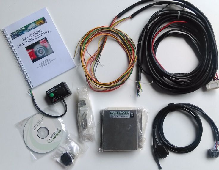

No much progress recently due to my wedding and honey moon but since I've been here I've made a few purchases to keep me busy when I get home! 1st being a Racelogic traction and Launch system and the second a 48ltr PA fuel tank(thanks Joe)

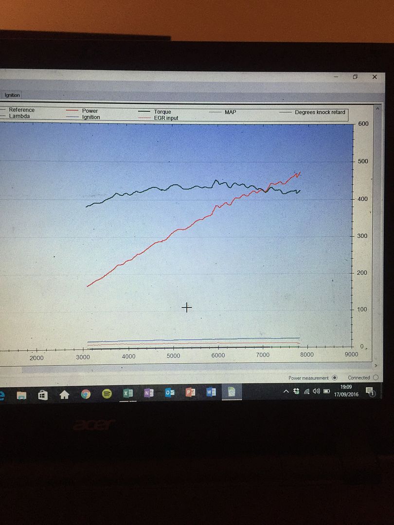

The car was starting to feel a little sluggish so I went out and did a bit of testing tonight. Still making 473bhp. Possibility of a slight boost leak/belt slip(Well spotted chill). Will have a look at this when time allows, will also lok to fit and test the 2.6 pulley..
The the wife decided to go out for the evening leaving me bored with a laptop......so I recontacted Josh at OTTP in the states about my 1900 Harrop request and to my amusement it was in stock!!!! So of course the card came out and I guess we will be seeing the first Harrop 1900 car on the road next summer. That or my engine/gearbox will be in a pile of bits on the floor! If anyone wants a low mileage 1320 this winter give me a PM.

The car is still so so far of where I want/need it to be but people keep dangling power carrots in front of me which I struggle to refuse. This next stage has to be the last stage of engine development, it's more than enough and coupled with the Racelogic it should give me a great one off package and allow others to follow noting that us sc boys can break the 400 barrier if wanted! With the switchable maps system on the pro version I will create two maps, one which is limited to 400bhp by using a reduce throttle opening and possibly a slightly lower limiter, I will then have a full blown map that will hopefully achieve 550+bhp. I have received a bit on inside knowledge that this 1900 on a 2.4 motor in the states with a fairly stock top end made 487WHP@7k before breaking the transmission. That would of course be 500+WHP at 7800rpm. This was all through a stock Lsj manifold with meth injection added for cooking like mine. Boost on that setup was 2bar. I ideally would like to keep the boost a little lower than that but we'll see! Also need to contact Gary at spitfire again as not sure how much more this fuel pump will flow, I'm hoping it will be up to the job!

I'm really interested in how a +550BHP VX would be to drive.

sluggish .... 473hp  :happy:
