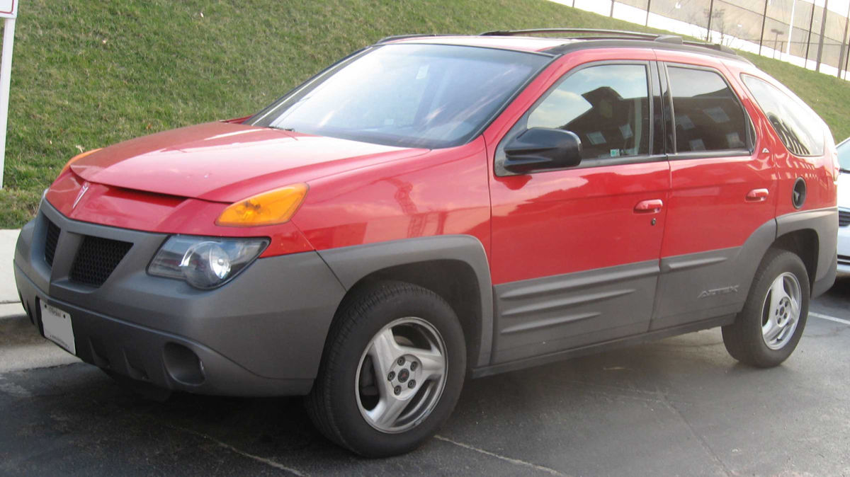

I accept that it does look TT’ish from some angles. But, when I’m using Audi body parts, that’s always going to be the case.
This bodywork change is being scrutinised against the original VX. I fully expected it to be and rightly so. But, what if the Original VX looked like my car now, and I modified it to look like the current VX? I wonder when scrutinised, how many would think it looked worse?
Change is inevitable, and when you consider that cars like this....
https://i.dailymail....53784194748.jpg
Are designed and built by multi billion pound companies and signed off, by management and board members, who clearly must think it looks well designed and will sell. WTF? Perhaps they should have used Audi body parts! 😂

Not the Stavic!

At least we didn't (officialy) get this beauty on this side of the pond..
:D

Blimey, that red car is fugly. Not seen that beauty before!
