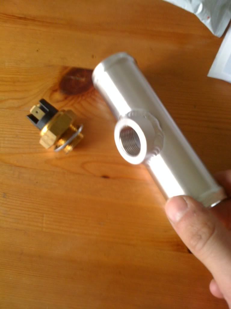

mini update, got some new sparkies:
also thought i might aswel fit this little beauty to turn the fans on a bit earlier
and while i was there i might aswell fit these

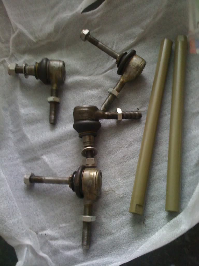

Did you notice any difference with the plugs?? Make sure you use PTFE tape on the swtich Did you paint the toe links??
#454 The Batman
Posted 01 April 2010 - 11:13 AM
havent fitted them yet!! i will fit them in an hour or so, the car has sat there for a couple of days so will be a good test! na i got them that way, i wouldnt paint them sh** brown :lol: will spray them black before they go on the car B)
#455 theolodian
theolodian
    Recovering VX owner
  • 3,195 posts
  • Location:Coventry
Posted 01 April 2010 - 11:16 AM
Where did you get the links, Autovaux? Cheers.
#456 The Batman
Posted 01 April 2010 - 11:20 AM
got them off another vx owner who couldnt be bothered to fit them!

#458 The Batman
Posted 01 April 2010 - 11:38 AM
:lol: i traded the last set i had!! i need these as my wheels are begining to point in different directions :lol:
#459 The Batman
Posted 19 April 2010 - 03:26 PM
well i got a beautiful pipe in the post today :wub:
the quality is VERY VERY good! now without looking is it a clam off job or can this be done with the removal of the headlight and front undertray?
#460 techieboy
Posted 19 April 2010 - 03:31 PM
Depends. If the jubilee clip on the rad end of the hose is accessible through the little access hole in the radiator shroud, it can be done clam on. If you can't get to the nut to loosen the clip, think you might need to remove the clam. Fitting the other end can be a bit of a pain as the hard pipe it connects to is free to move around in the sill, which makes life harder.
That bleed valve is much better than on my earlier version which is smooth sided and a real pain in the arse to loosen/tighten. thumbsup
