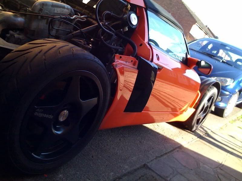

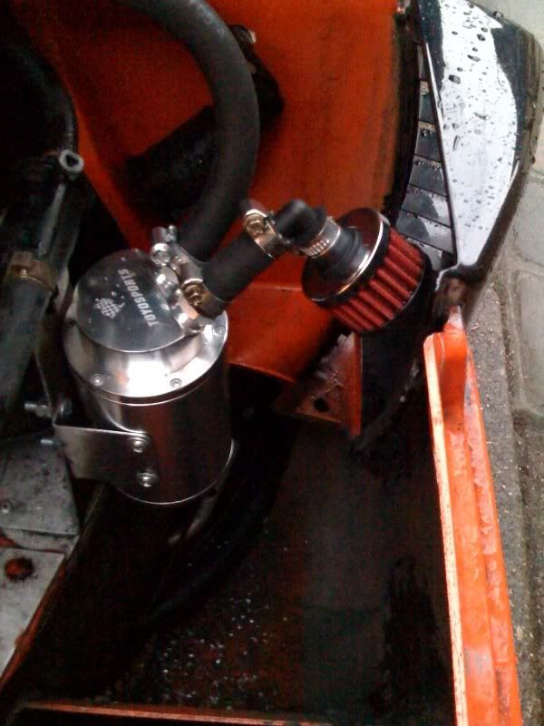

right have tackled another task now and fitted an oil catch tank. below shows qwhere it is mounted
below shows the gauge bit that you can see through my side pods thumbsup
