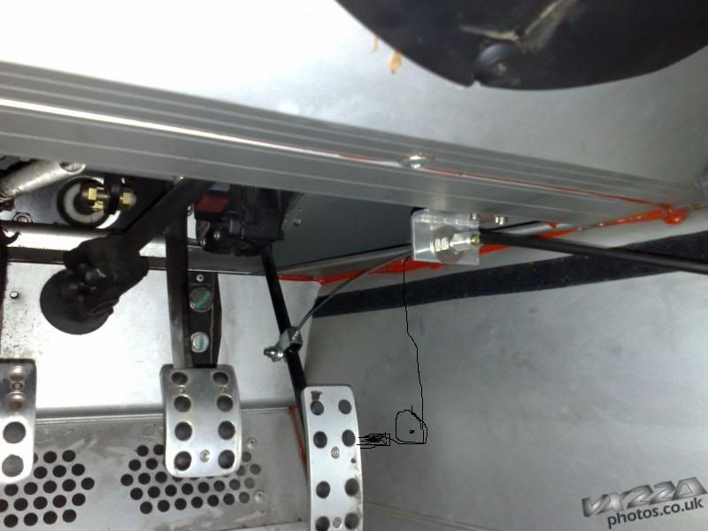

Could you not try mounting the cable to the pedal further down, towards the end of the pedal? Or is it no where near having enough range?

If that is a 70mm TB then that cable segment seems rather big radius. Cant you fit a smaller segment? (modify from some carb or other TB..)
I wouldn't be able to fit my big feet on it as is!

Fit an Elise throttle linkage?
Eg: http://www.elises.co...999/august.html
That did occur to me when I got in the car after typing that.. Now are you ready for some MS paint skillz? The idea is to mount it to a bit extending from the pedal out to the right, and then mount that roller type thing somewhere so that the cable gets pulled for the full swing of the pedal at its longest arc.
:lol: I was so tempted to not even upload that because its so bad! :lol:

Posted 11 August 2009 - 08:24 AM
gonna do this one I think, but no need for a roller. I'll just extend the top mount a bit further down and have another plate attached to the back of the pedal sloping backwards so my feet don't see it

hmm certainly looks like it would work and be nowhere near my feet. I wonder if we have those 2 mounting holes (can't tell from the pics I took and nowhere near car now :()

Just checked some old pics from my restauration, and our crossbeam looks exactly like that with the boltholes on that side. So this should just bolt on. thumbsup

I fitted an elise throttle linkage at the weekend.. (the pic above didnt give enough movement and got in the way of my big feet)
I had some help from a friend who is some kind of design person for an aerospace company, but he wasn't much use, just kept taking useless photos
this goes under the dash and amplifies the pedal movement
need bigger inlet tube and filter now
