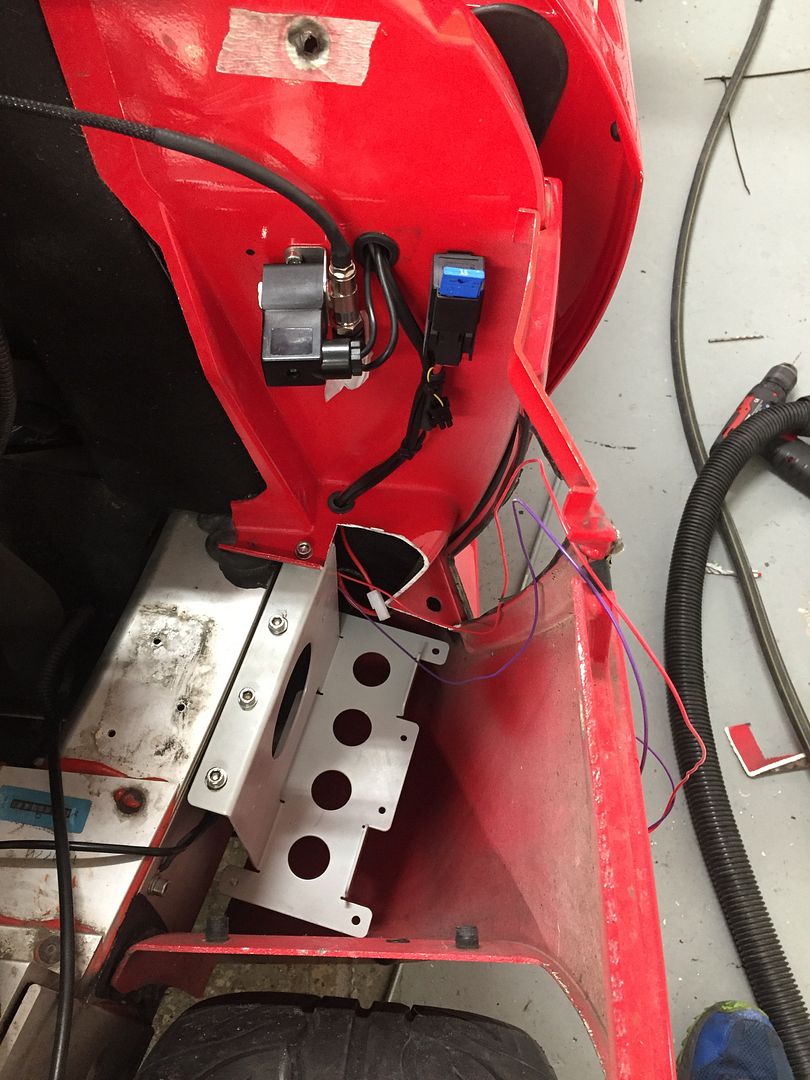

Also the Aquamist system is pretty much fitted, just need to organise a longer gauge cable and decide how to mount the gauges. I'm having a custom tank made now to sit in the right hand sill so that also could take a little time. Decided to listen to others who have tried and tested WI, so I've fitted 2 jets post laminovas. Fairly big jets on mine as I'm running mw50
