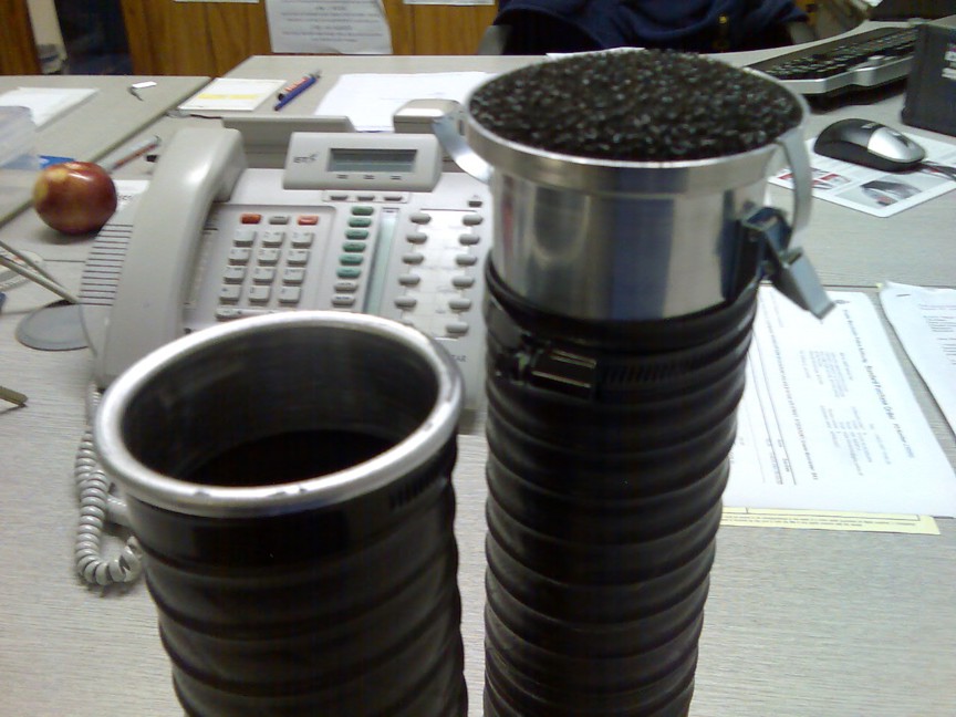

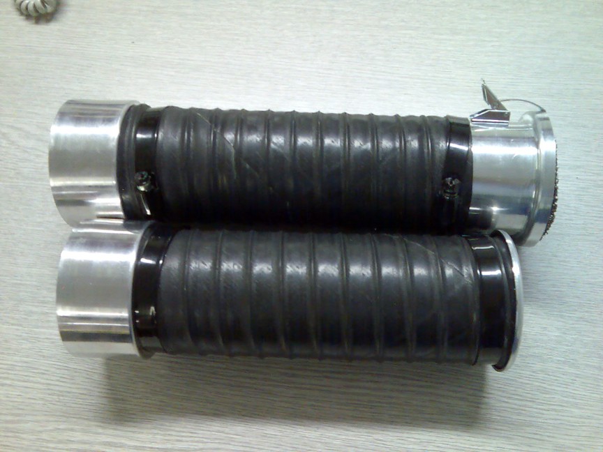

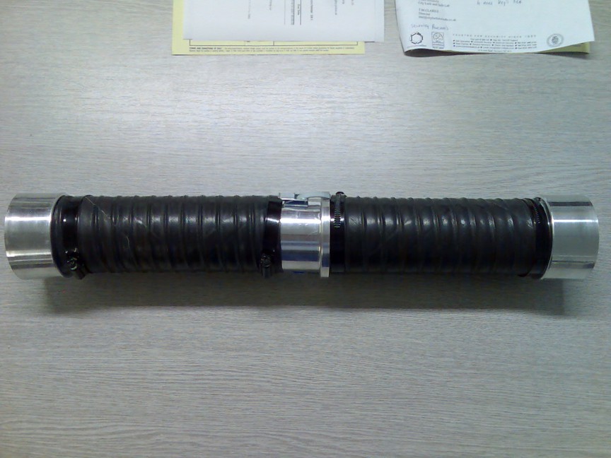

Those who have fitted.. the taller part in pic 3 with the filter in it, is this the side you attach to the heater matrix?
Some pics..

if you attach the taller part to the back of the dash as it were, it is much easier imo to clean the filter in the future. otherwise you'll be poking about around the brake servo forever more......... :beat:
Correct. That's how we designed the fit, to aid access. Also, if you don't, you won't be able to clean the filter properly, as all the crap will be stuck on the other side of the filter which you can't get to!!!!!!!
Regards the filters not being removable, the guys at revotec decided to stick them in place, as on my working protype, we held it in place with mesh, so the new method just dispenses with that. Regards cleaning, simply un clip, and hoover off the "inlet side" of the filter, and re clip the filter housing!
